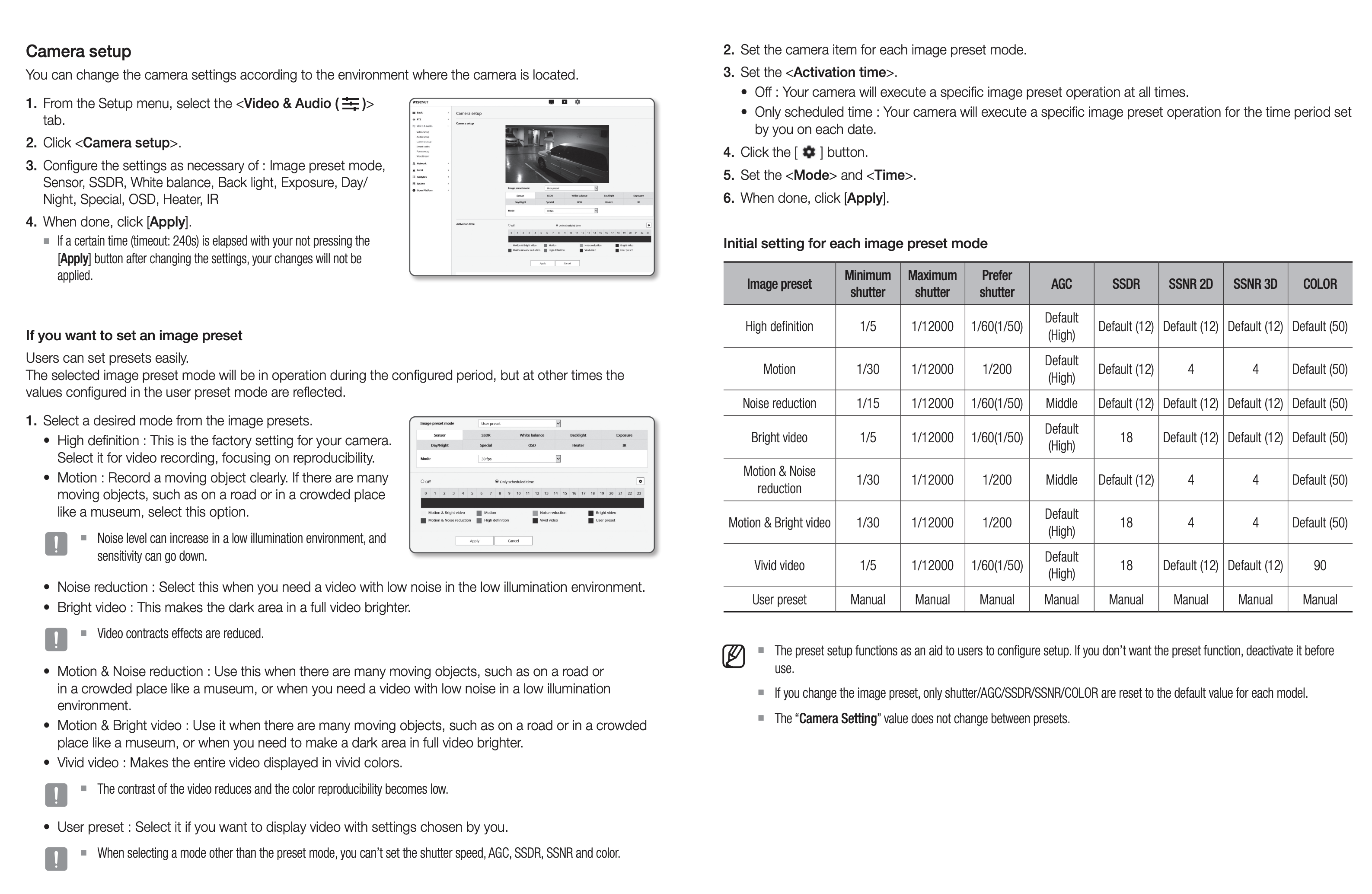

I've had a look at the camera user manual and it looks like if you go into the settings via a browser and go to Video & Audio > Camera Setup you should able to set the FPS under the Sensor settings (see below screenshot from the manual).

okay, have you tried changing the Image Preset Mode to User Preset? Is the FPS still greyed out when set to User Preset?

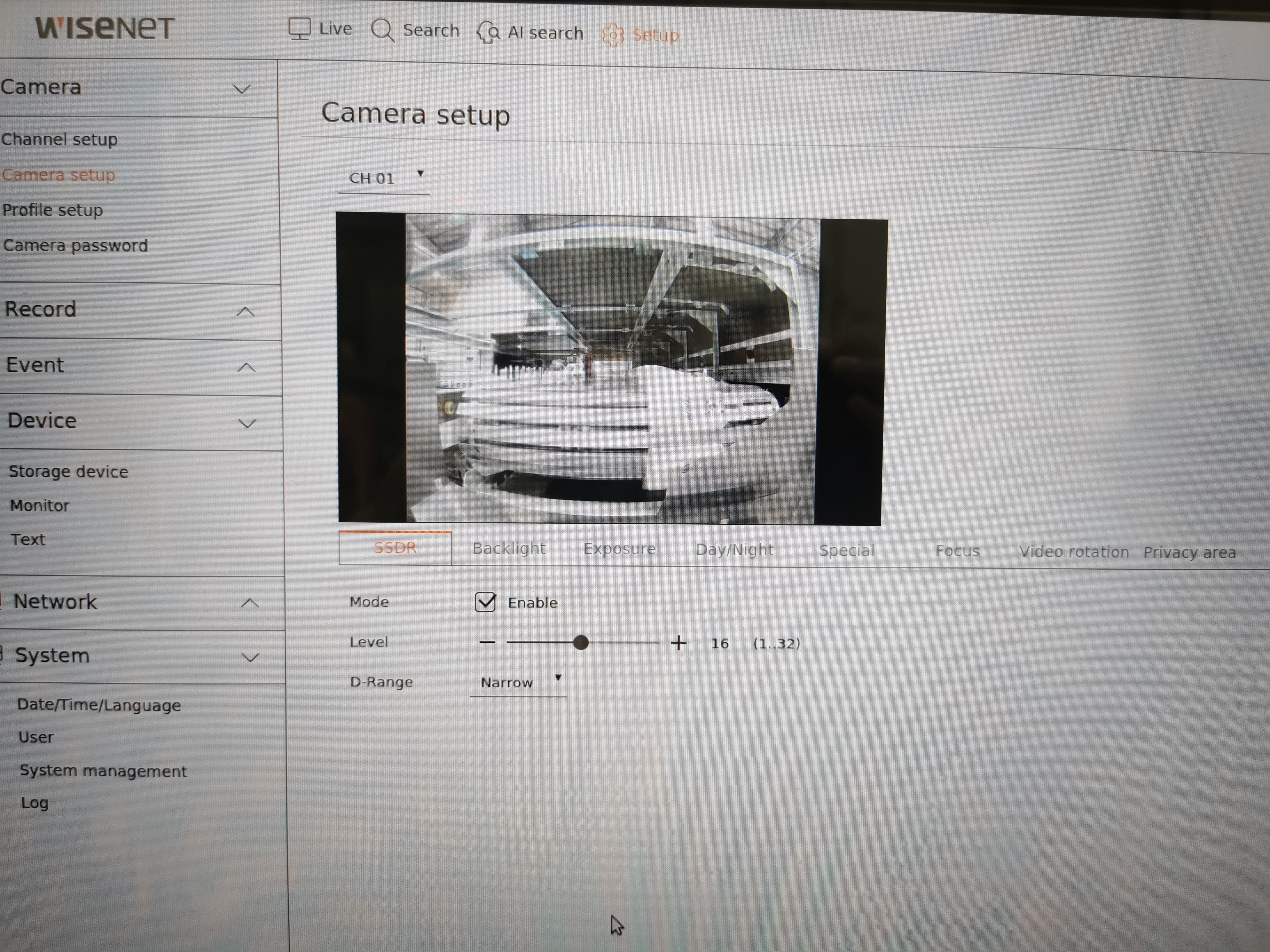

The options are different on NVR, I can only assume they are different when connected via their app and using the dongle to connect, but hav tried all options and settings via the NVR

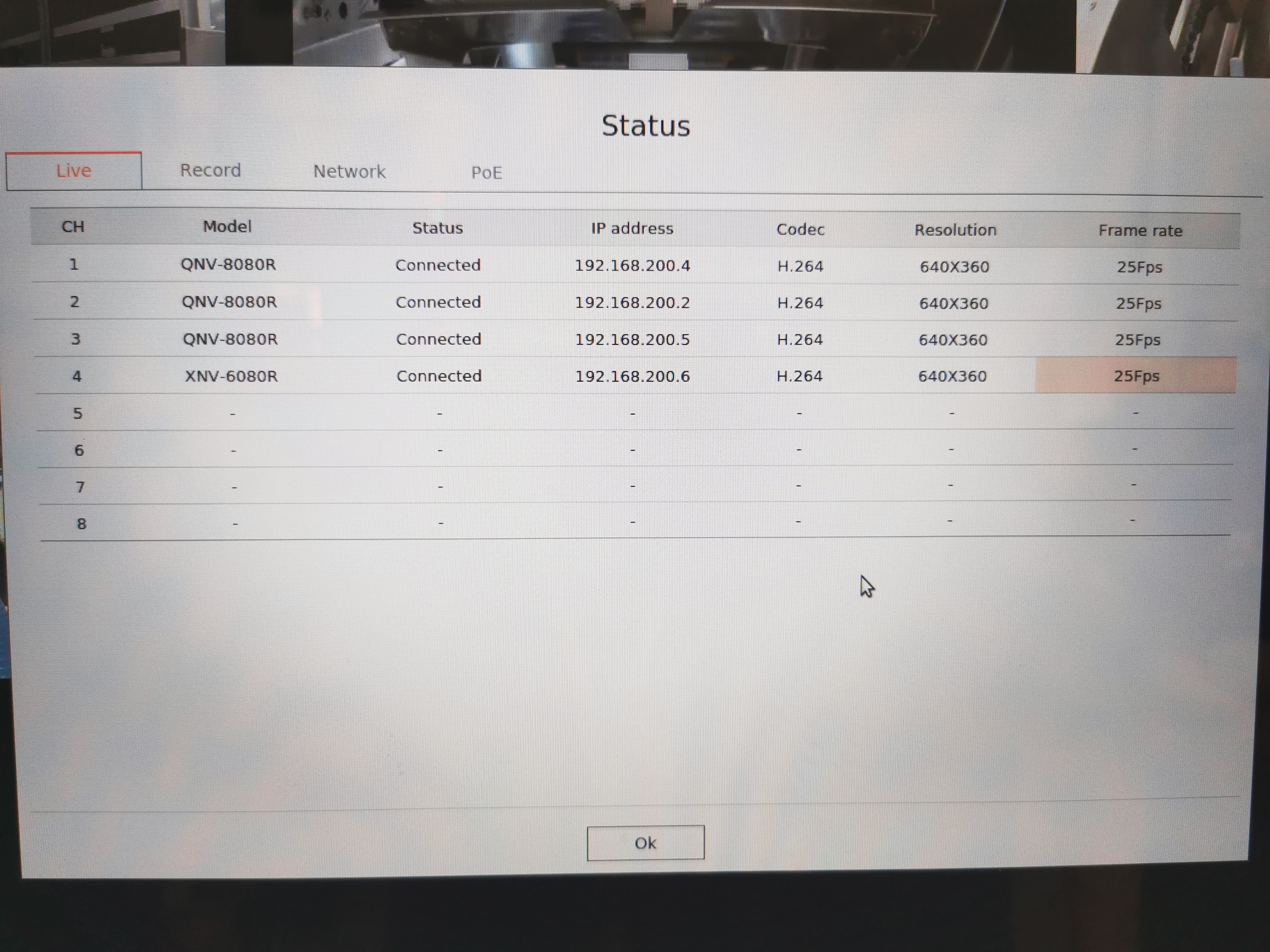

Hi yes all plugged in as per image, that image is from the NVR

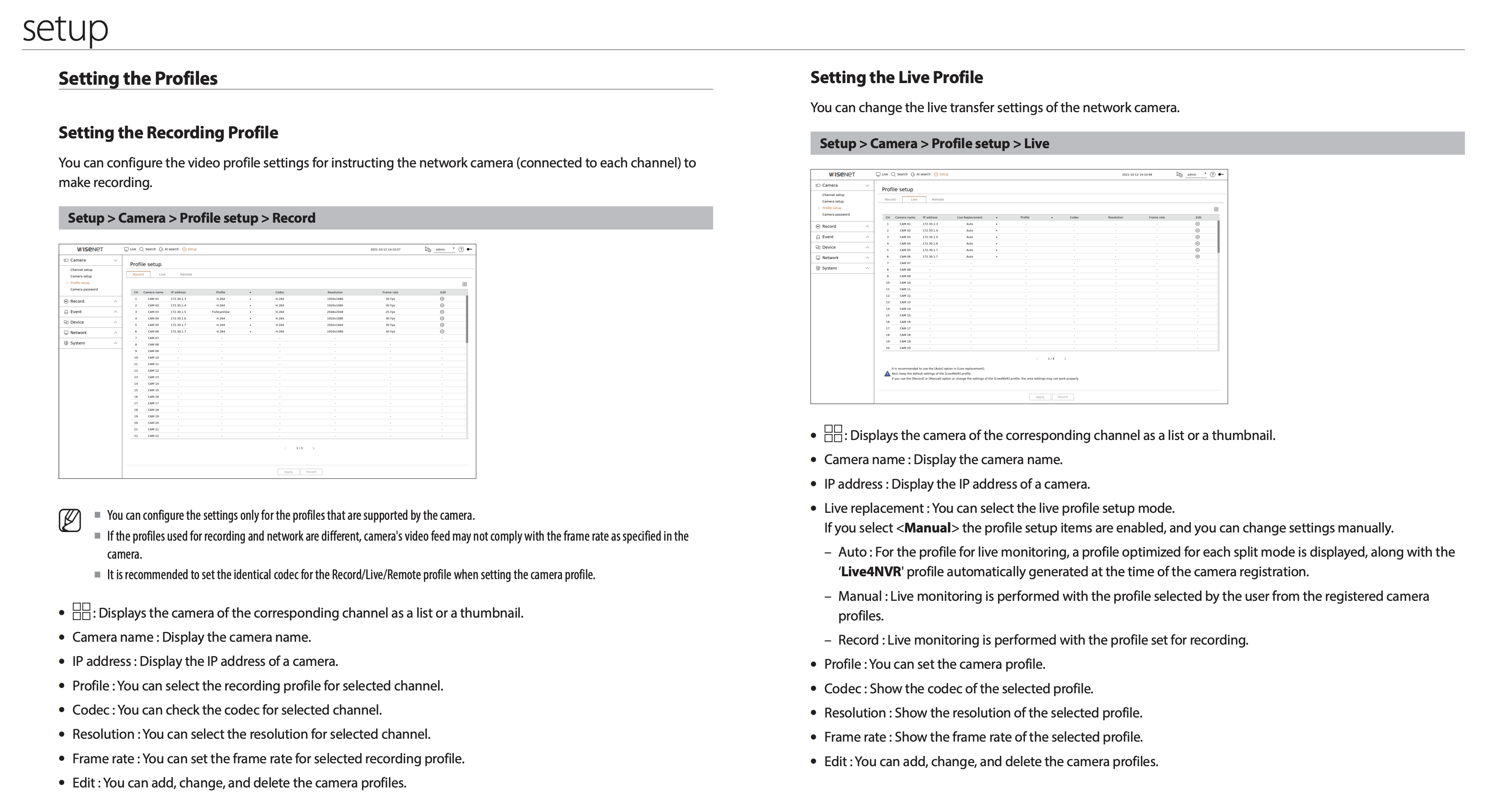

In the NVR settings under the Camera Tab have you checked the settings under the Profile Setup menu?
Profiles are the package of settings applied to the different streams for live view, recording, etc...

Are you sure you've checked that Profile Setup menu?
The user manual for the NVR says this is where you set the FPS/frame rate for the recording & Live View streams (see screenshot below).
