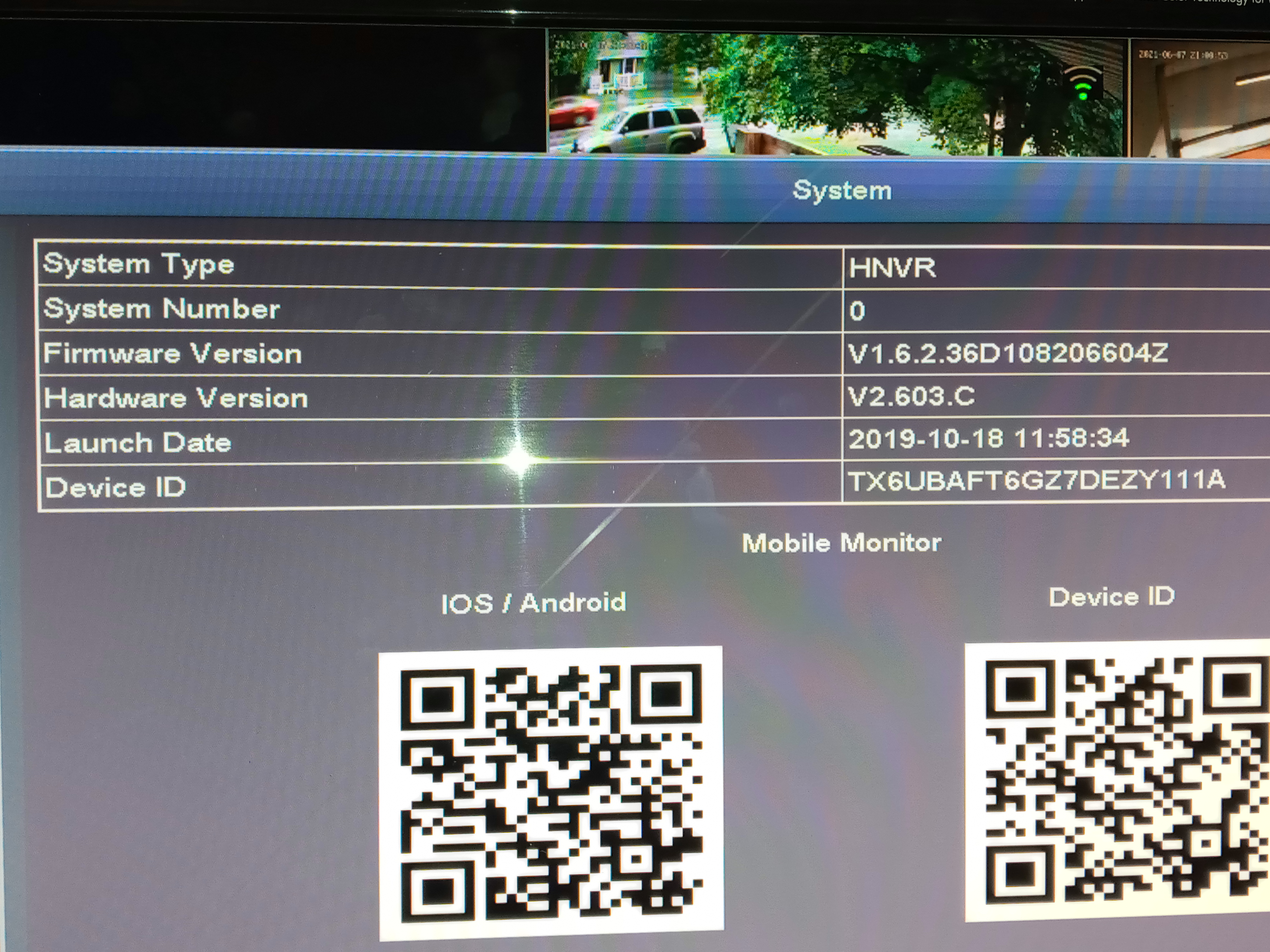

here is the main menu he has and the extra cameras have the same part number
the extra camera model iszg2320m-w the cams on the building are zg2320m-w
the nvr unit is zr08dp
