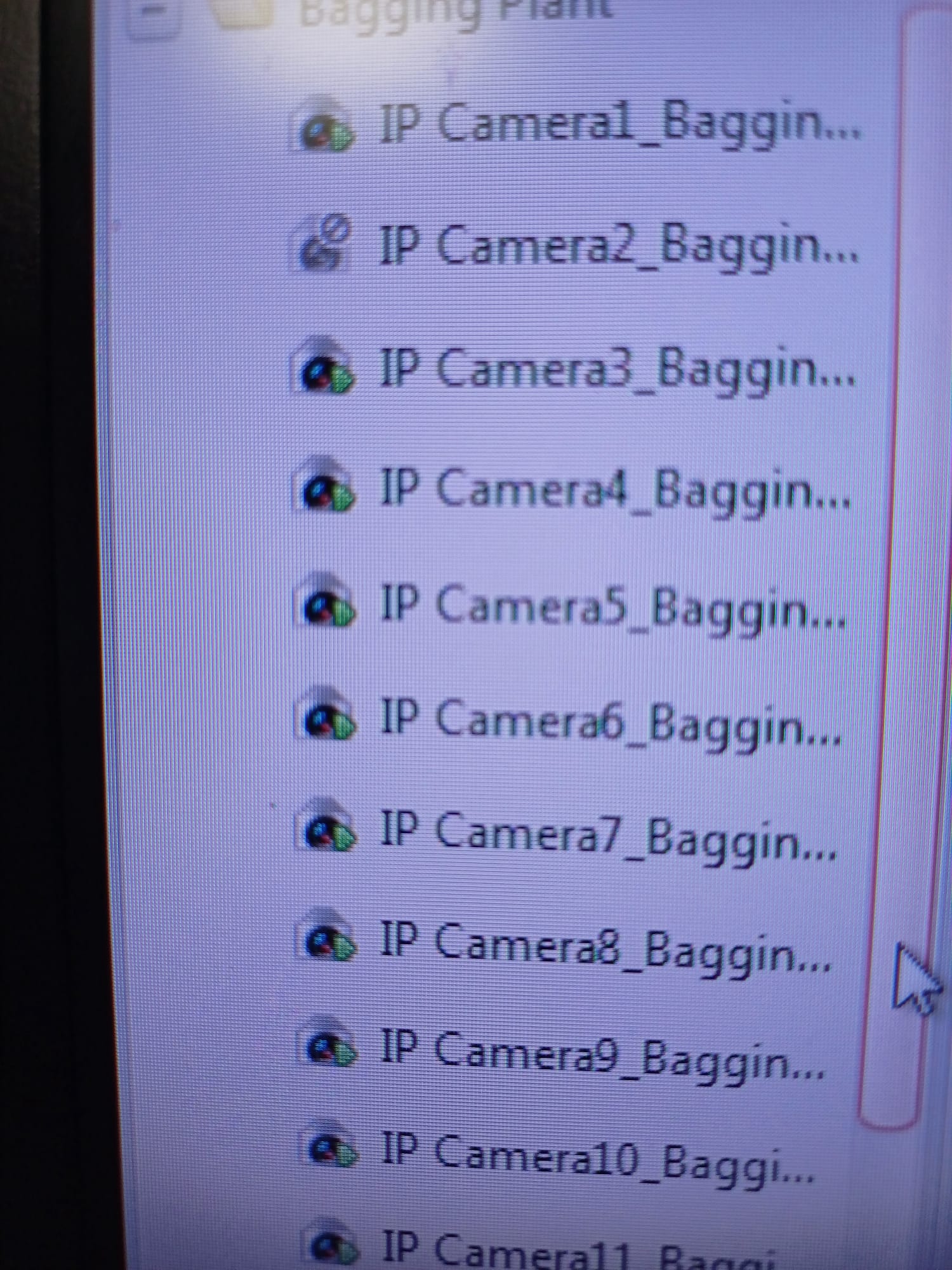

hi Folks , today we got set up up hikvision IVMS 4200 on my PC ,but by accident i deleted a camera by selecting the red x in top let corner of the screen , cant seem to get it back now , " Camera is disabled or off line " any help , feel like a fool now for doing that

Hi @johngreen
Have you tried dragging & dropping the camera from the device list back into the live view window showing this error message?
Okay,
Is the camera added to iVMS on its own or is it connected to an NVR that has been added to iVMS?
Thanks,
Does the camera also appear offline when you log into the NVR with a browser or direct HDMI monitor or is it only offline in iVMS?
That looks more like the NVR firmware, are you definitely using iVMS-4200 on a PC and not a Mac?
If so, the screenshot looks like it is from a very old version of iVMS for PC. We would recommend upgrading to the latest version of iVMS-4200 for PC - iVMS-4200(V3.12.0.7_E).
Okay,
The datasheet for V3.12 of iVMS says that works with Windows 7 so there shouldn't be an issue upgrading to this latest version.
One thing you can try before updating iVMS is to delete the NVR from iVMS-4200 and then re-add it to see if that brings the camera back online.
