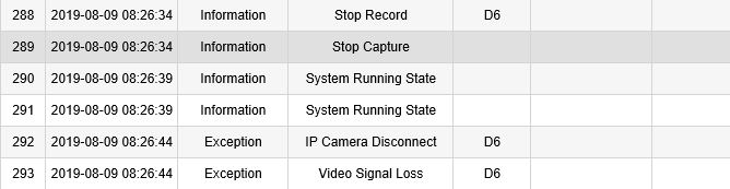

@fullboogie snip of log attached. Yes exceptions. That attached is the typical log posts when the camera disappears its #D6.

Is there nothing before or after those logs that looks odd?

Thanks @fullboogie for reply. I have attached exported log. I you look (for example) toward end of this file you can see more of the detail where D6 (the camera in question) is lost/disconnected followed by NVR reboot which I did manually.
This is log from today, so you can also see other similar D6 disconnections in the log.

Man, you're getting lots of "IP Camera Disconnect" exceptions on several cameras, D3, D1, D6, D7. I've never seen that in any of my logs. Have you noticed the "POE Power Supply Exception" seems to occur immediately before those disconnects? The description to the right states the power is going to 0.0W, then you get the disconnect. They may be related. Below is at 15.09
@fullboogie agreed, I came to the same conclusion myself
