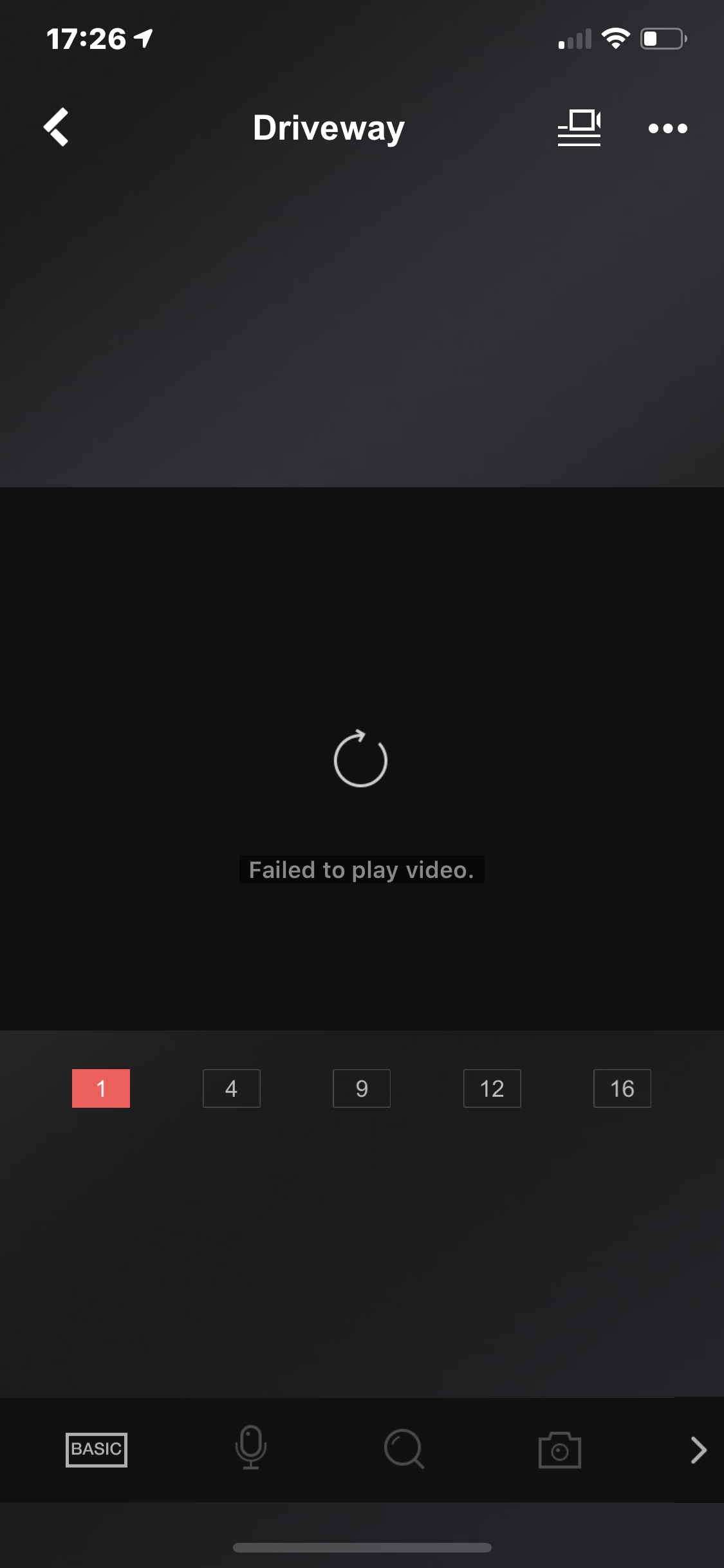

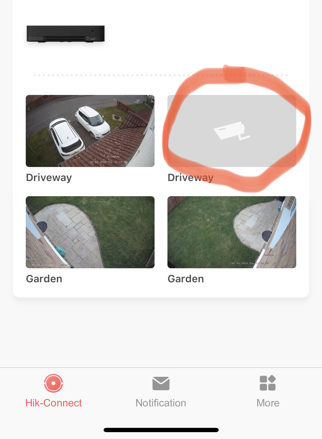

Got an issue where 1 of 4 camera are not showing on the Hik-Connect or iVMS app on the iPhone. Firmware all updated and correct. Tried between the admin and user accounts and all cameras allowed to view. Reset and all the usual google options. Now at a loss and getting more and more annoyed.

Only Live view not showing. Playback works ok on that camera.
can be viewed ok via NVR and web GUI. Just not via App.

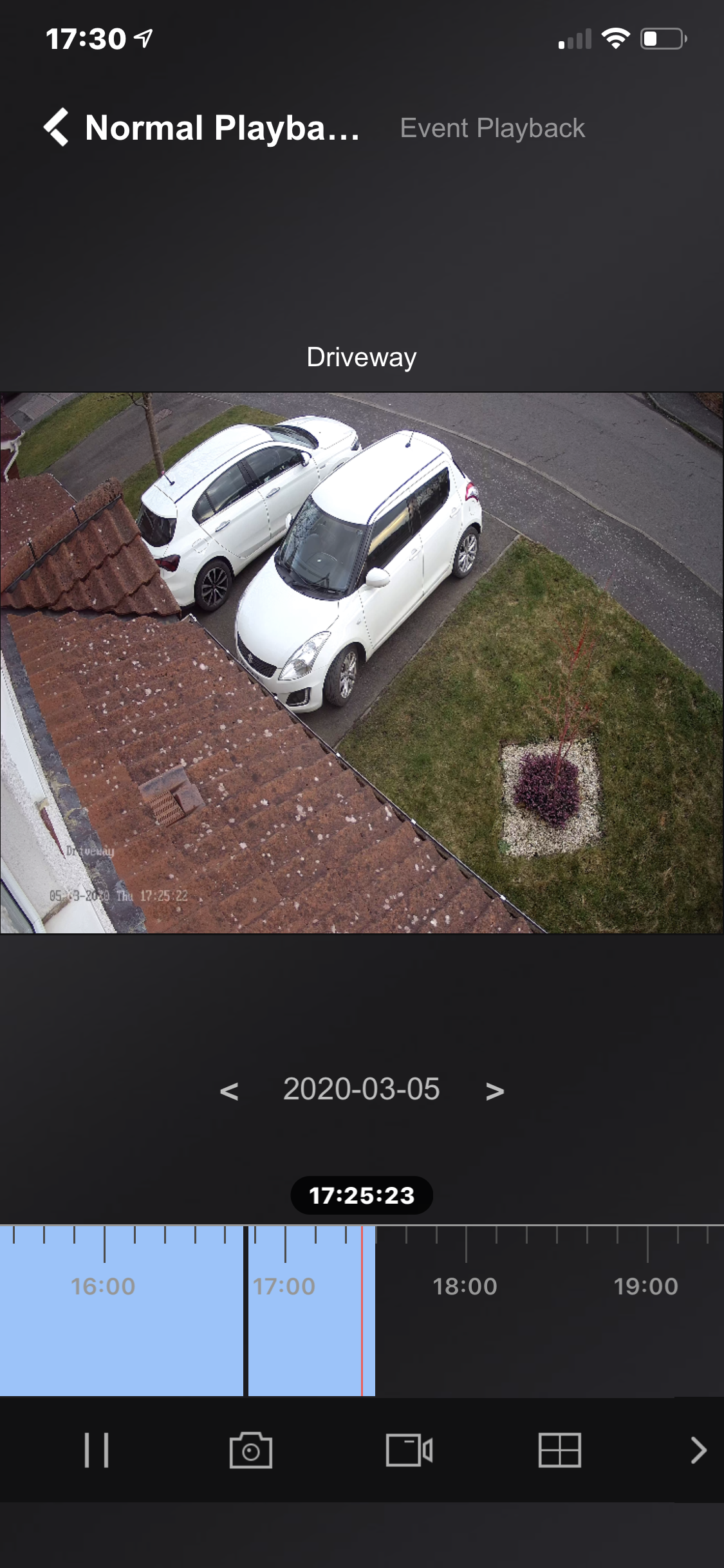

Here is the same camera view in playback mode. All works fine up to a few mins ago.
