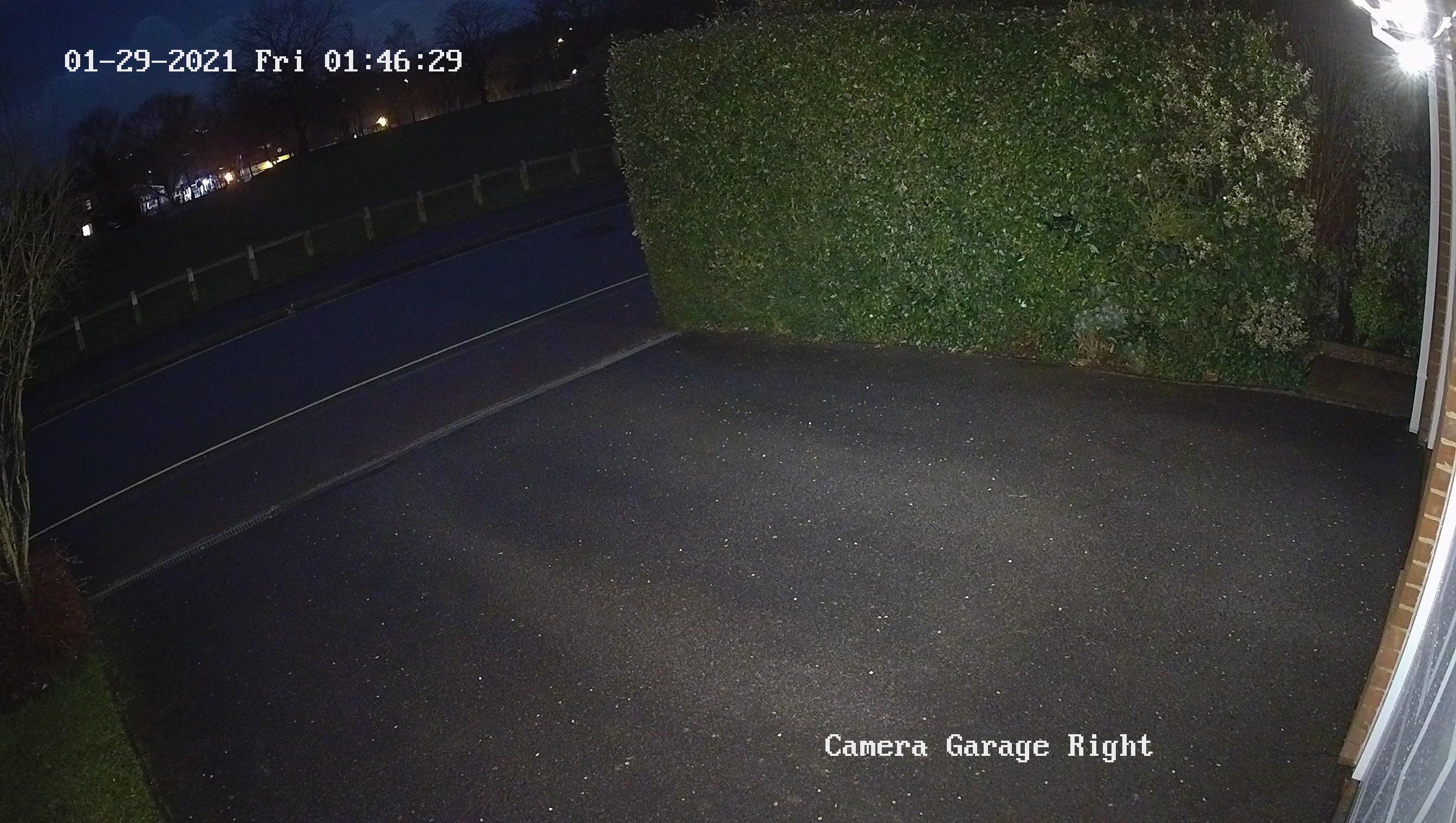

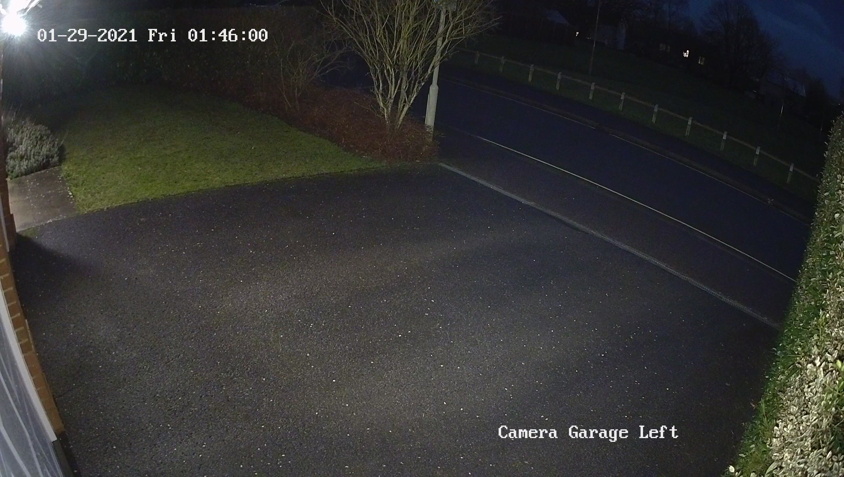

I have 2 off 4mm ColorVu cameras set up at opposite sides of my double garage (approx 5metres apart) and use the built in LEDs during the night when the Council turn off the street lights. They are positioned so that they are only just in each other’s field of view and I have no issues at that distance. I have them set at a brightness of 35%.
Attached are a couple of screen grabs.

@IED thanks for taking the time to post the screen grabs, it's a big help. From what I can see, the light doesn't affect the image, except for what is directly behind the camera. For example, on the second picture you have a paved path that I presume goes down the side of your garage. If this path didn't head in that direction but went in the direction that would mean the shrubs were paved over, then the light would obscure that path. Unfortunately, my path would be in this area.

@gilders Yes I agree: Luckily for me I don’t care about the path behind the camera as it is covered by another camera down the side and the grassy area is also covered by another closer camera.
