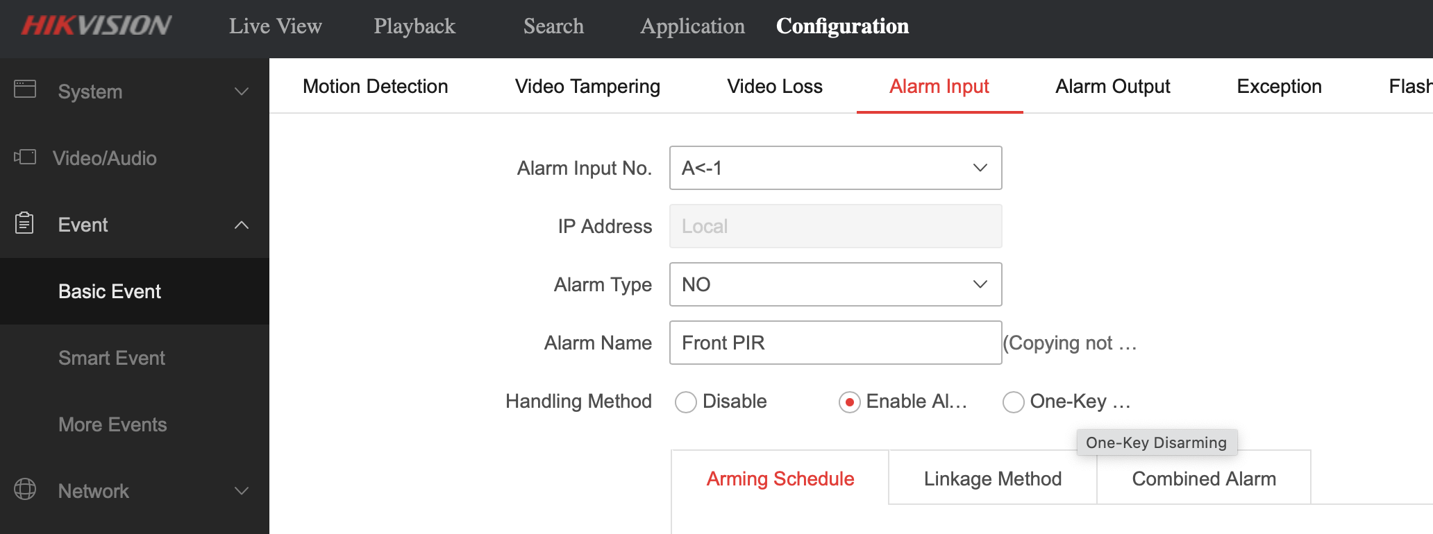

That functionality should be there and you just enable it on input 1 of the NVR. Though from memory it will disable the push notifications as well as the sounder/strobe. It’ll work similar to the enable/disable bell icon in the Hik-Connect app.
If you take a look at the alarm inputs in the settings can you see the 'One Key Disarming' option for Alarm Input 1? You can find it in either the local menu or from a web browser. The image below is from my M series NVR but it's the same on the I series and should also be there on the NXI. One key disarm has been an option for some time and possibly pre dates Live Guard.

It's easy enough to test. Enable the option, pop a bit of wire in Input 1 and another in G with ends already stripped. Configure an alarm with a strobe event and check if you get the strobe or not. Then short the wires and test it again.

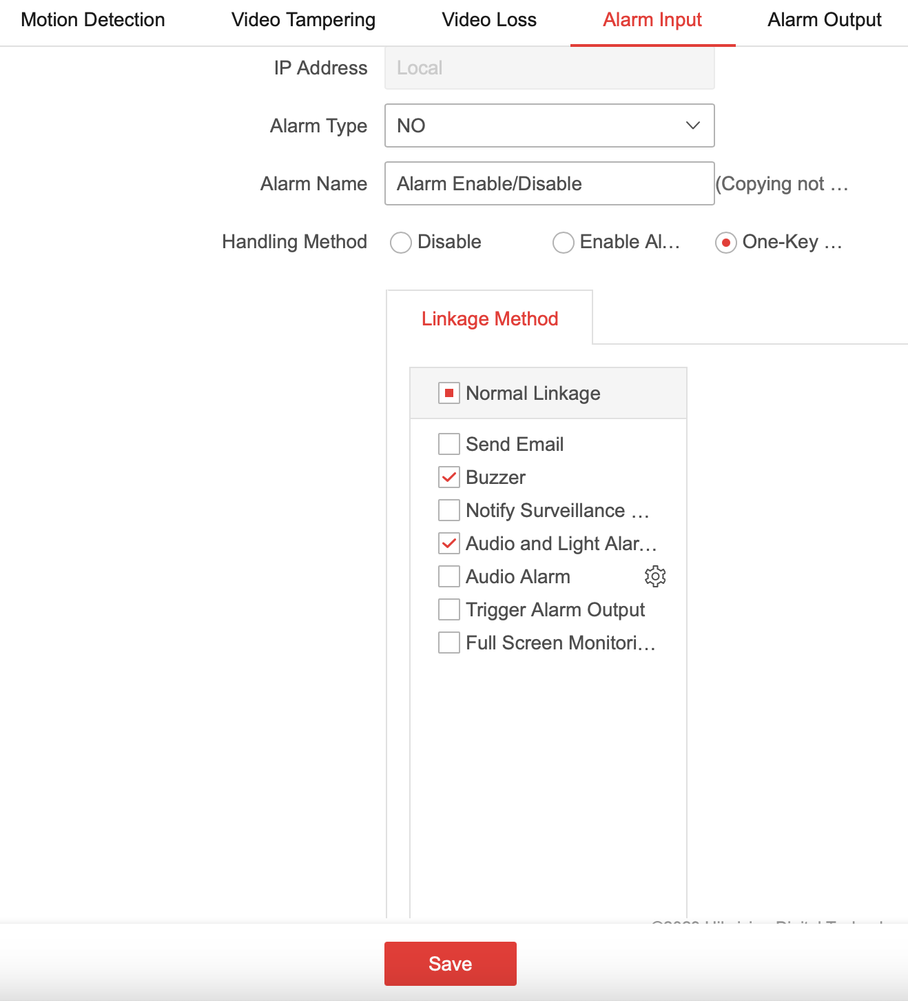

You shouldn't need any specific firmware but you do need set the linkage actions that you want the arm/disarm input to disable. For Input 1:
  1. Select the One Key Disarm radio button for Alarm Input 1 and save
  2. Select the linkage method tab for Alarm Input 1 and check the box for each element that you want the input to arm/disarm when it changes state. From the help file:

In the example below Input 1 would arm/disarm the buzzer and the audio and light alarm for all alarms, while leaving everything else operational. By default all of the linkage actions are deselected, so input 1 when set to arm/disarm looks to have no effect until you tick the things you want it to disable (at least that's how I'm interpreting it)

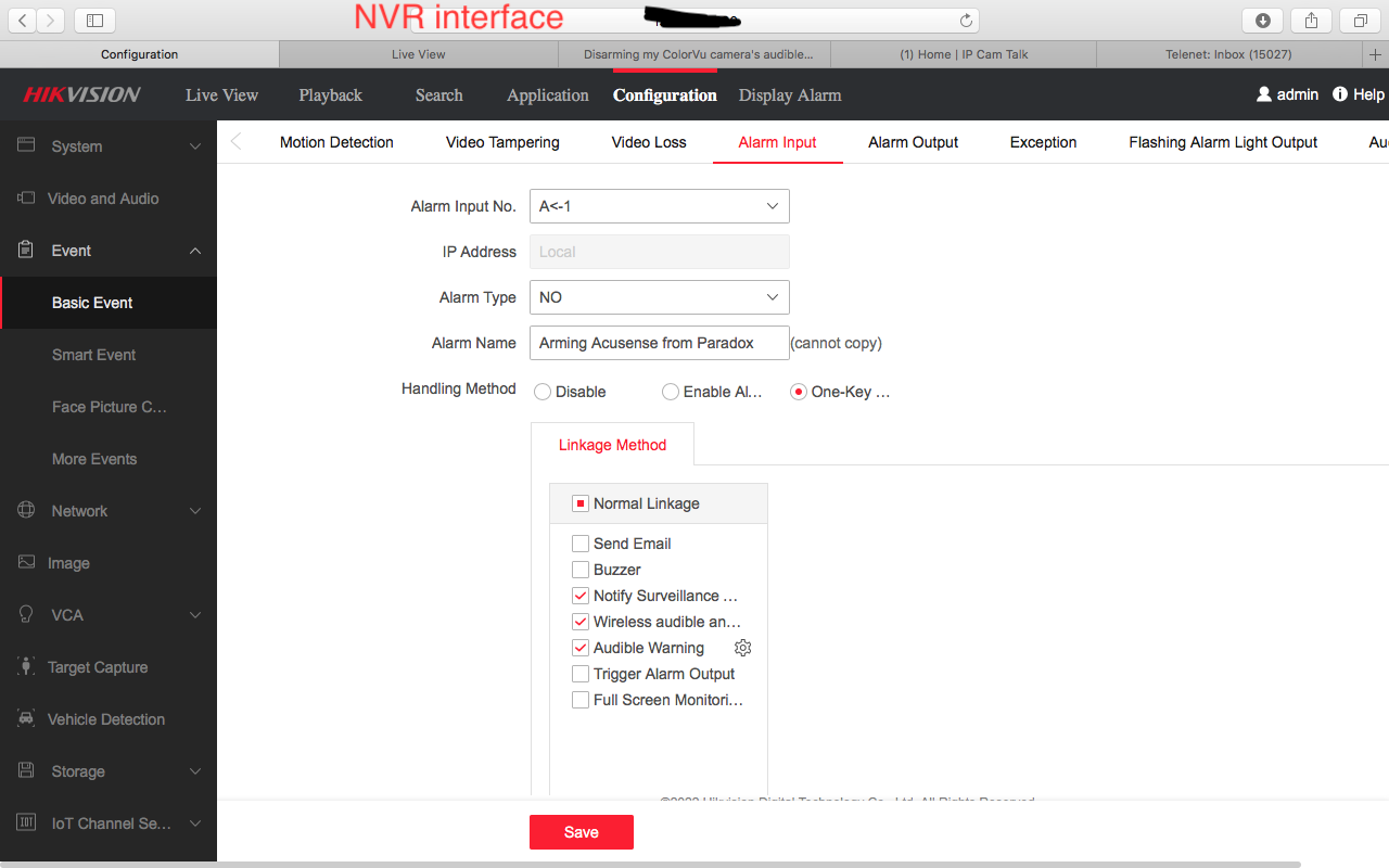

Got up this morning full of hope ;-) but still no go. I tried what you said.

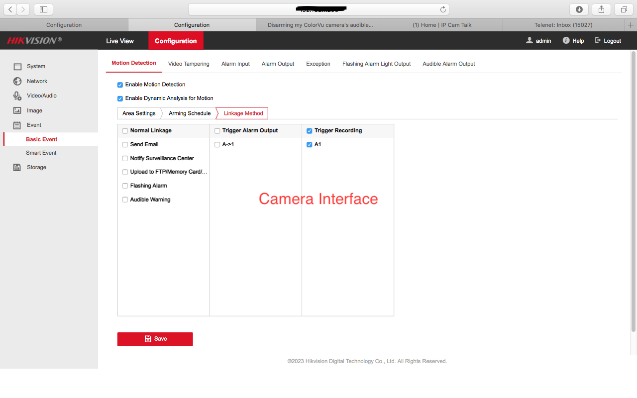

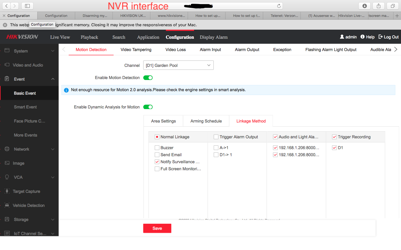

Here are some screenshots. It seems so easy, but in fact it's not, and it confusing to be able to configure things (sometime different thing in the camera and in the NVR)
Camera: DS-2CD2387G2-LSU/SL (c) V5.7.13 build 230403
NVR: DS-7616NXI-I2 / S (c) V4.62.205 build 230220

OK - I thought you were just needing to get one key arming/disarming working but appears that you need to fully set the system up. I imagine you've been altering settings on both the NVR and camera.... you should've left the camera alone and just carried out the settings in the NVR.
Another issue looking at the image is that you may have activated events both in the camera and the NVR AcuSense Engine. You would use the camera AcuSense (if you have AcuSense cameras which you do). They can't both be active. Regardless it is all set up from the NVR (not the camera). Once something is set in the NVR AcuSense engine, if you switch back to using the camera it is still being processed (though not active) in the NVR (that's where that not enough resource message has come from - you have intrusion or line crossing setup in the NVR Engine)
1 - Clear the motion detection area and disable it
2 - (more important) Go to Line Crossing and Intrusion Detection and clear any set areas then disable both
3 - Uncheck the box in Line Crossing/Intrusion marked as 'Use Device AI' (or similar) That is telling the setup to use the NVR and not the camera for AcuSense.
The above will clear the NVR event engine. As long as you the leave the 'Use Device AI' switched off, you can set up your line crossing, intrusion, motion detection again, because with the switch off the camera will be used to process those events.
If the NVR AcuSense engine is used you can only have Motion or Smart Event (hence the no resource message). Using the camera you can have motion, line crossing and intrusion set up simultaneously if you wish with different actions set on each.
Program everything via the NVR NOT the camera
