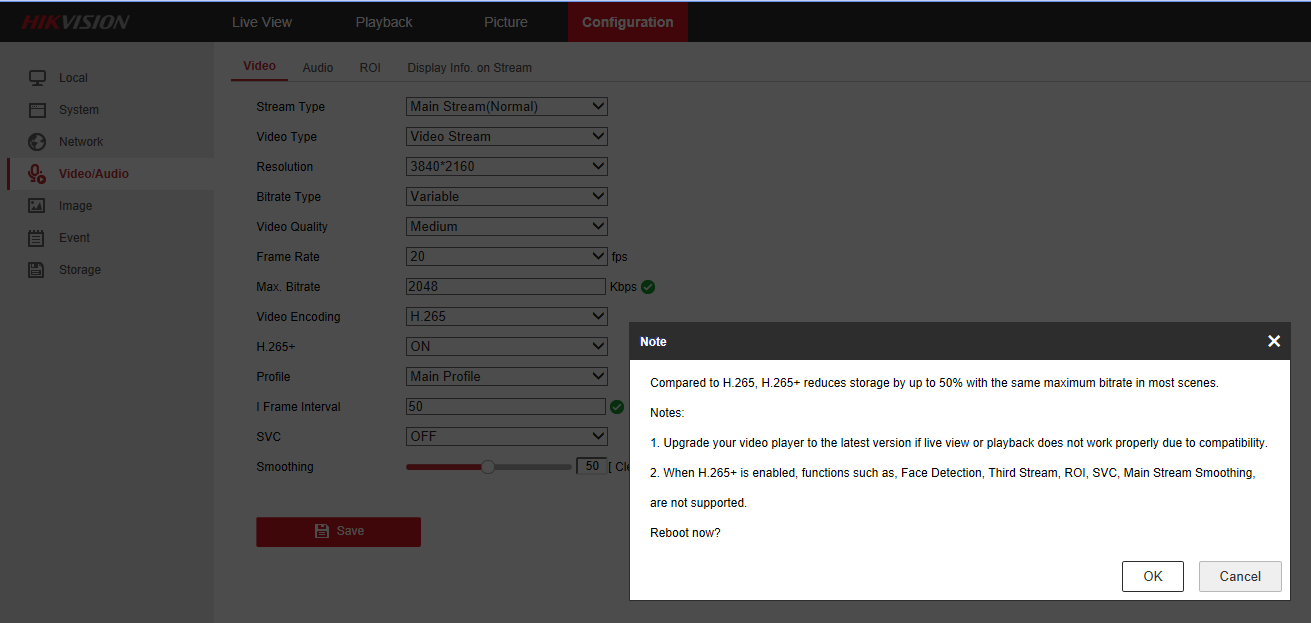

Are you sure that as well as selecting Video Encoding as h.265, that H.265+ is set to ON for all the cameras?

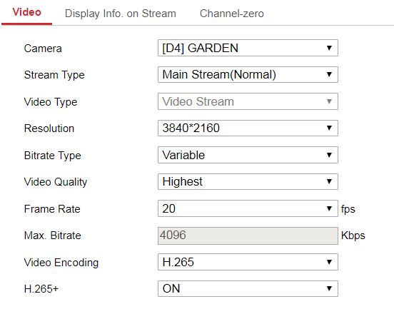

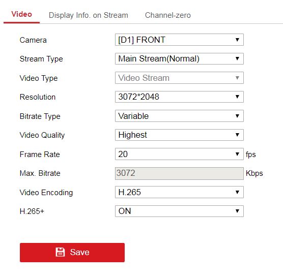

attached are the screenshot from the 8 and 5 MP cameras.
