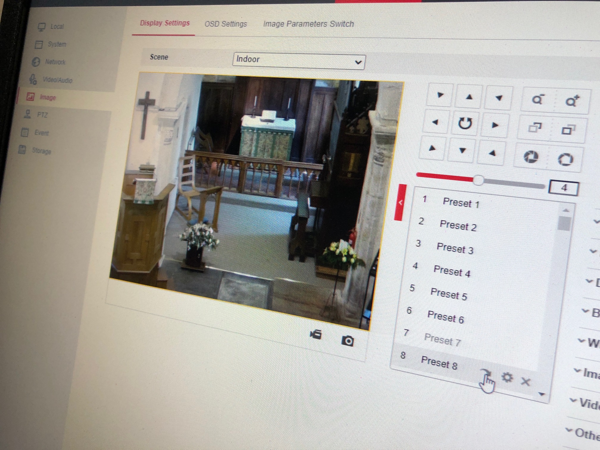

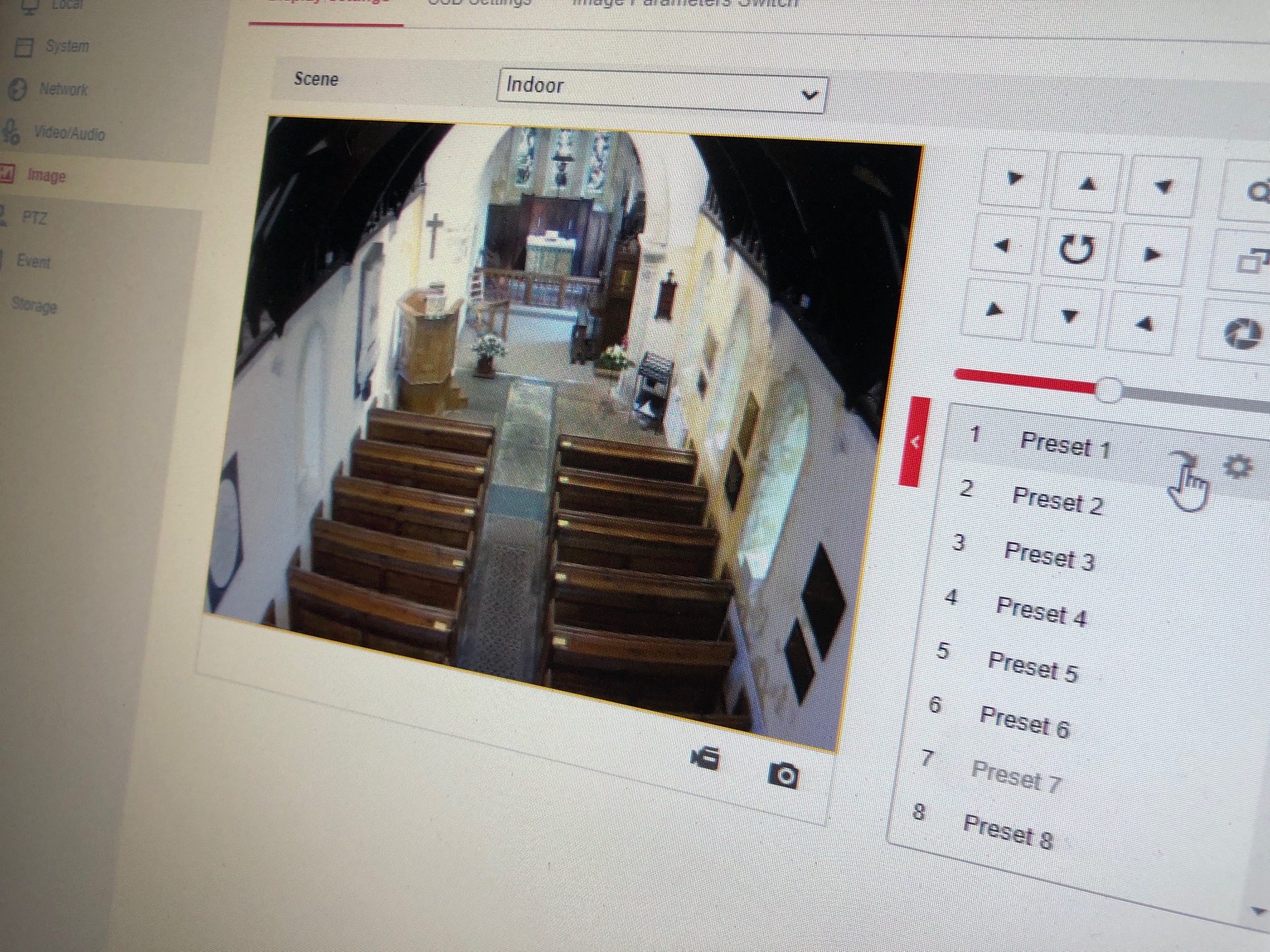

I fitted the above PTZ into a local church a few months ago to give them a combined security camera and a livestream camera for funerals/weddings etc. And all-in-all it's doing a decent job. The local vicar is able to use presets to change the view depending on what he's doing, and although it's not the fastest zoom in the world, he's quite patient.

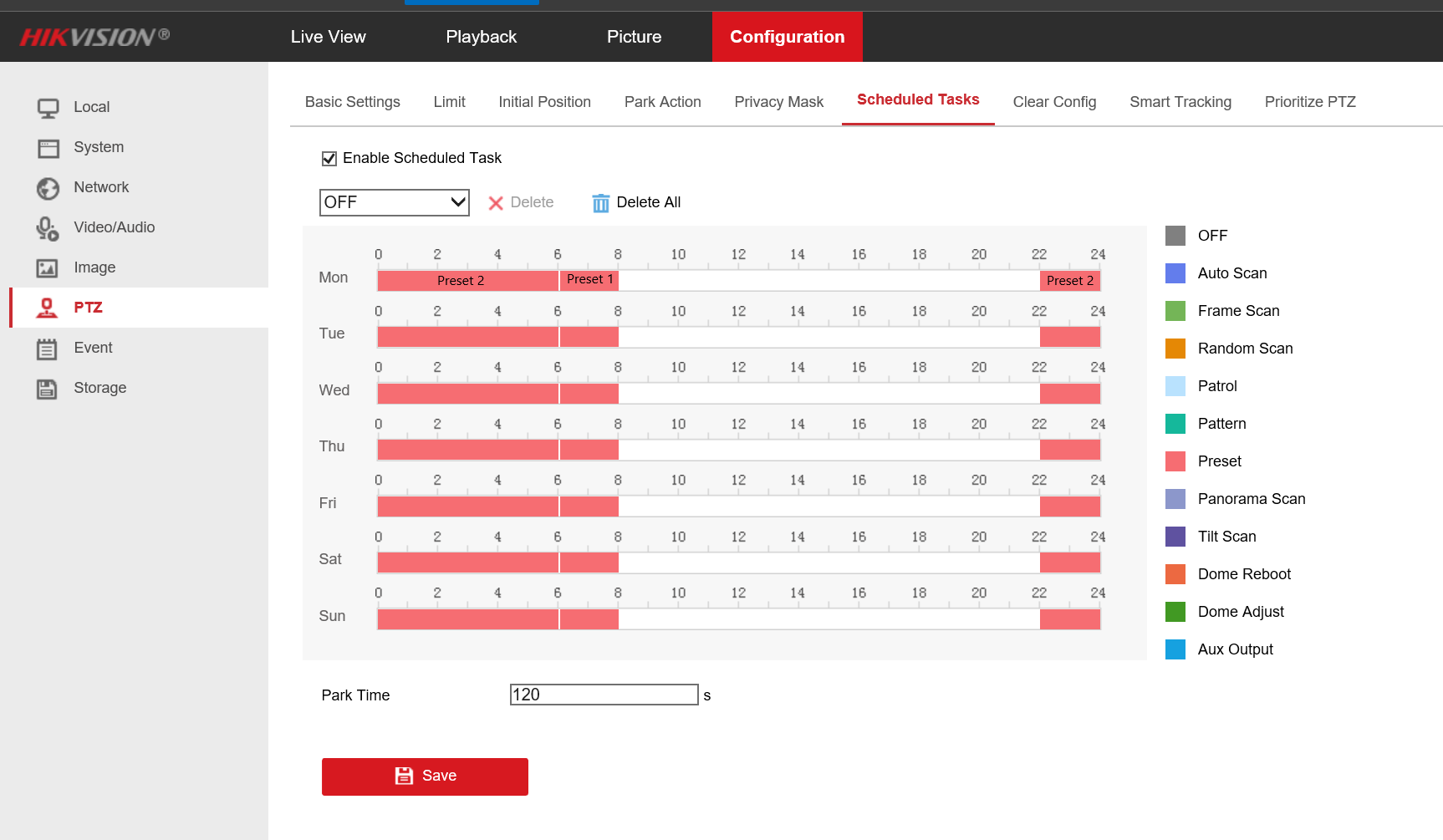

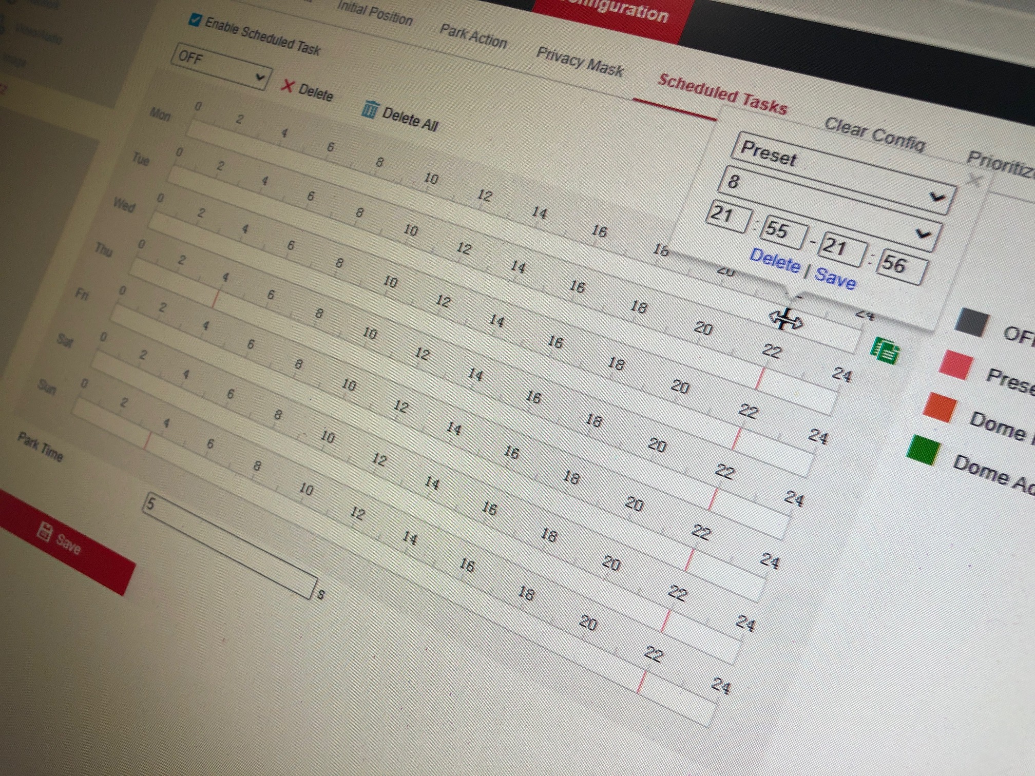

What I was trying to achieve was that after he'd been doing a service - that at night at a preset time, the camera would revert to a certain position.
The camera is connected via POE switch so is available on the network.
When I log in directly to the camera, and then progress to scheduled tasks - tell it to choose preset 8 every evening at a certain time - it doesn't do it. I have scheduled tasks enabled.
Am I missing something obvious?
