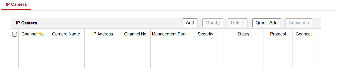

Firstly there are no camera showing under the below, would this be a simple case of upgrading the firmware on the DVR (its currently on V 3.5.22) and the cameras would appear, the cameras are connected via BNC to recorder not cat 5/6 so are not IP cameras.

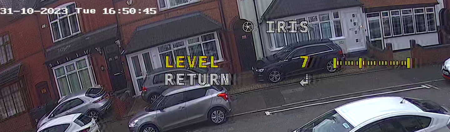

2nd issue is how do I get rid of this writing on the camera (level, return , 7)
That's correct. That screen will never show cameras that are connected on coax via BNC. That screen is purely for IP cameras that are added from the network, so ignore it.
You've entered the camera menu from the DVR. To get out of it:
  • Click the icon that brings up the pan tilt zoom menu (usually a joystick)
  • Click the tilt down arrow once to highlight 'return'
  • Click the iris open icon (which acts as enter)
Continue using the down key to highlight the option you want to 'return' to the higher level menu, or 'exit'. DO NOT 'save and exit' otherwise anything you've entered incorrectly while in the menu will be stored.

Worst case - just power down the camera PSU momentarily and it'll boot back up without the menu displayed.
Hi JB1970, when you say camera PSU you mean unplug the power cable from the camera ? If so I have removed the BNC connection for that camera from the DVR side (camera is mounted high up and would be a struggle to get up there) and it clears the text but after a short while it re-appears
It depends whether your DVR is just a K1 or a K1/P. If it's a K1/P, it's PoC (power over coax) and unplugging the BNC at the recorder would drop the power to the camera. However if it's the standard K1 (which I think it possibly is) the camera(s) has/have a separate 12V DC power supply. It's that power supply that would need down powering to reboot the camera.
