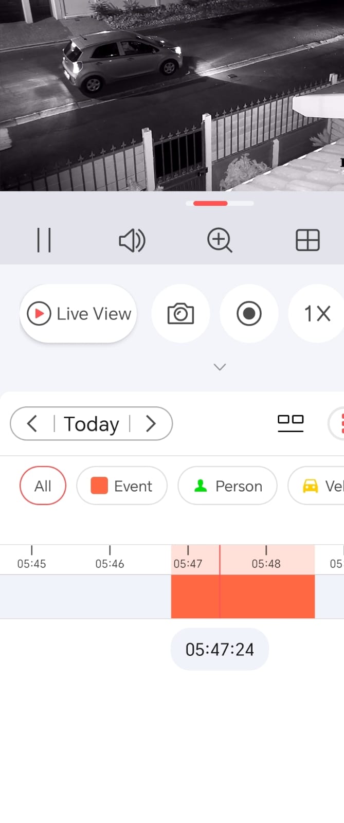

So my question is: Are you able to view this False alarm reduction - H&V Events that are created by the "Enable AI by Device" feature on HIK-Connect ?
Please see the attached Pics.

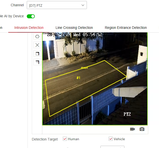

I have included a pic from within the NVR that shows "Enable AI by Device" is enabled and the Human and Vehicle its tick on (@75% which is very high).

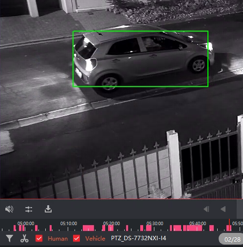

Next pic is within IVMS that show Human and Vehicle filter is on (but I see nothing).
Last pic is within Hik-Connect which shows nothing!
