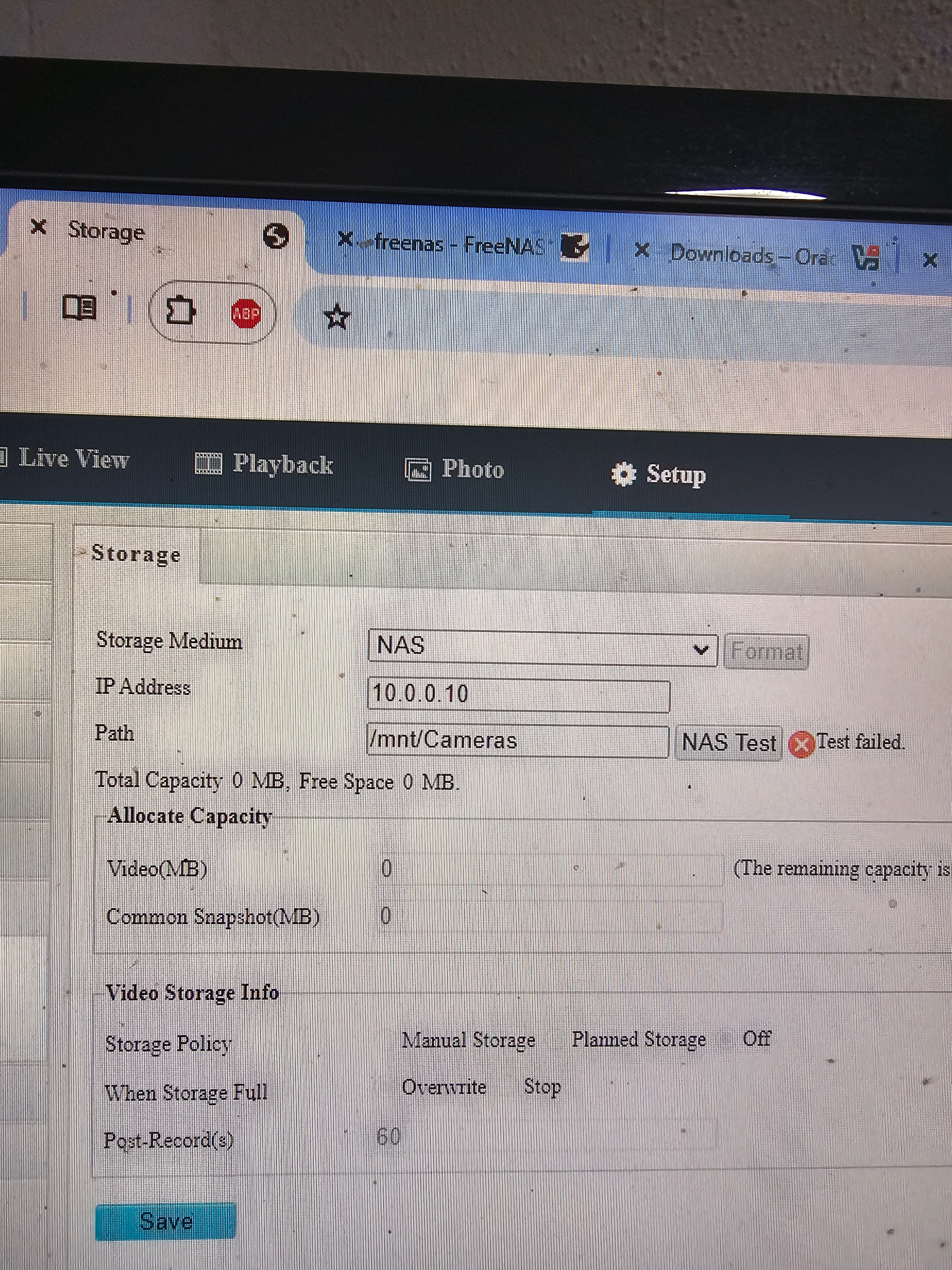

Hello, I have 2 UNV cameras setup at my father's business.
It now saves the footage on SD Cards but it seems to corrupt them fairly quickly.
I have made a TrueNAS VM and successfully connected to it through the main computer.
When I try to setup the camera to save the footage to the NAS instead of the SD Card and try to do NAS Test I get the error "Test Failed".
Anyone worked with such a camera with that feature and could help guide what I might've done wrong?

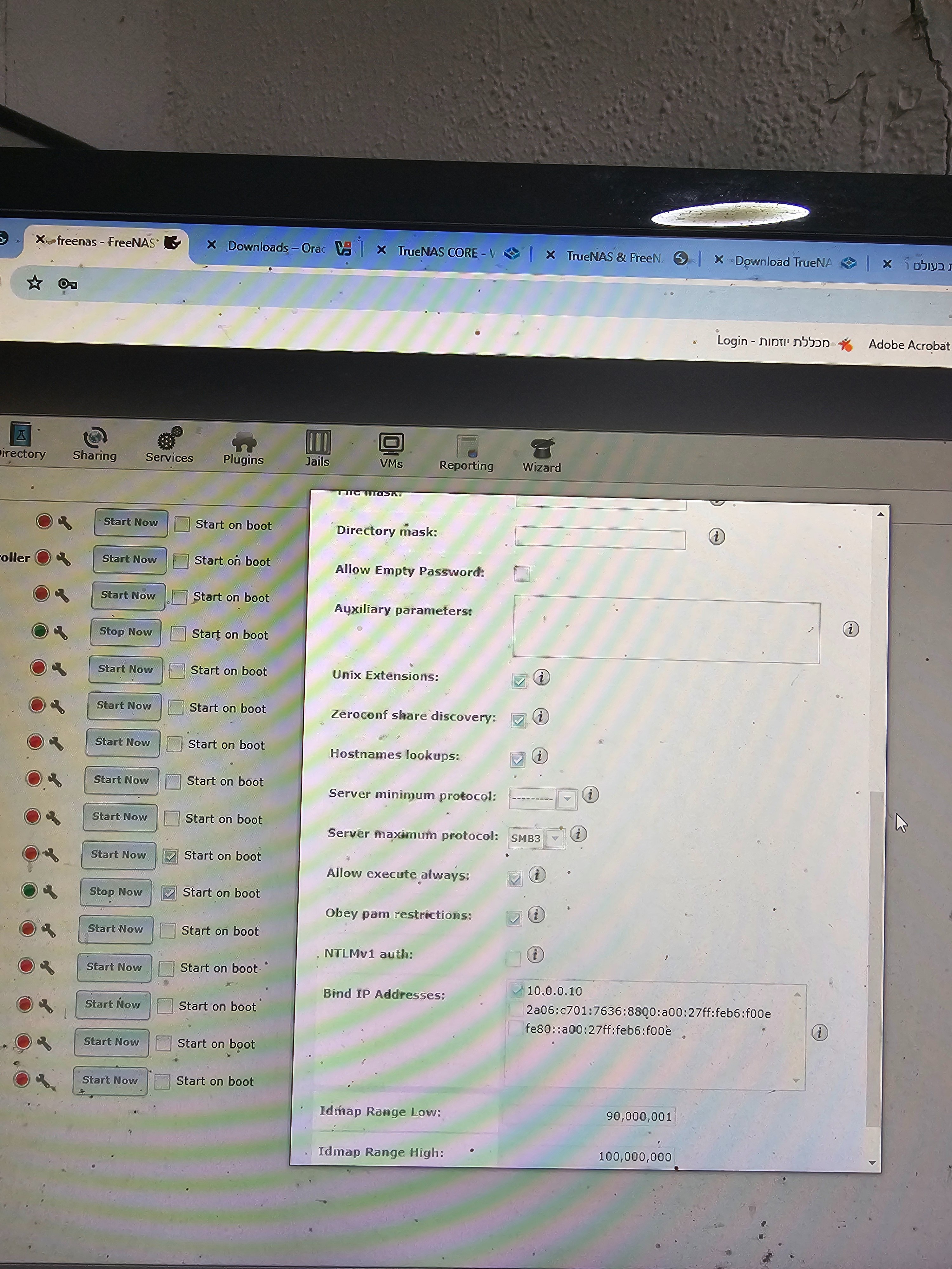

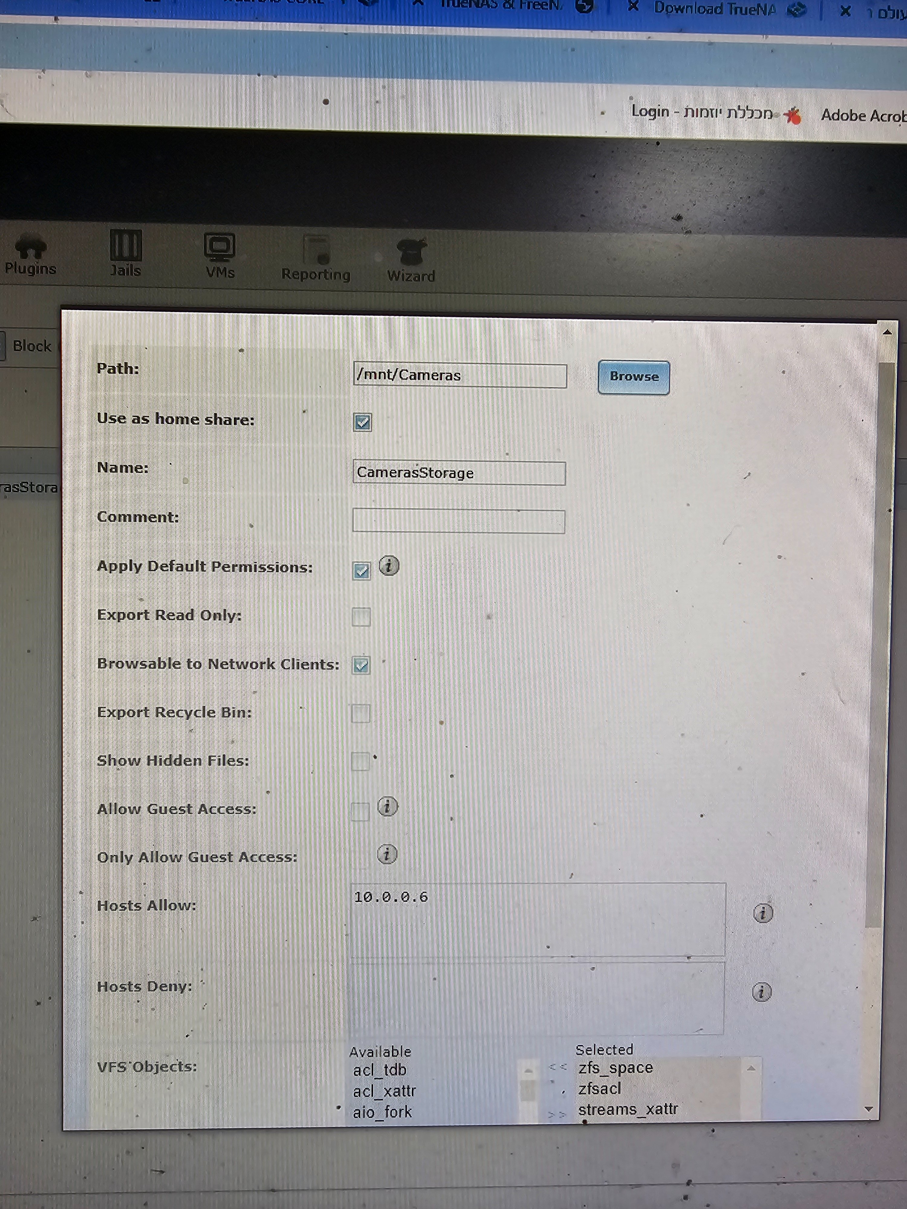

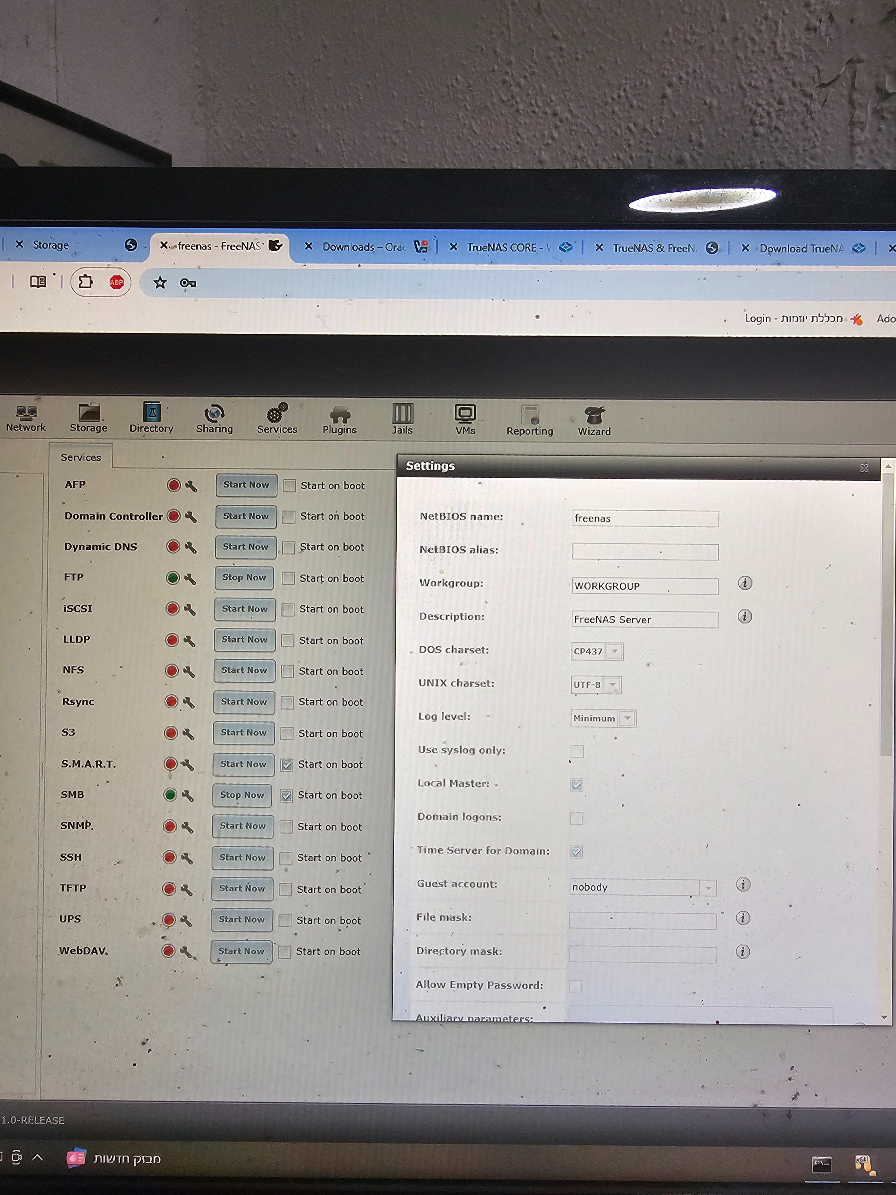

Sadly I am not following a specific guide. However, I'll add a few pictures of settings.
10.0.0.10 = the ip of the NAS
10.0.0.6 = the ip of the Camera
The sharing option is SMB

Check the port numbers of the SMB server and client are the same.

To make sure the NAS is accessible as a drive using win10 map the NAS as a network drive, then create a text file and save to the NAS camera folder / directory. Then make sure you can open / edit / save / delete the same text file. This link may help.

I THINK FOUND THE MISSING PIECE!
I turned on NFS and suddenly was able to finish the connectivity test successfully!
