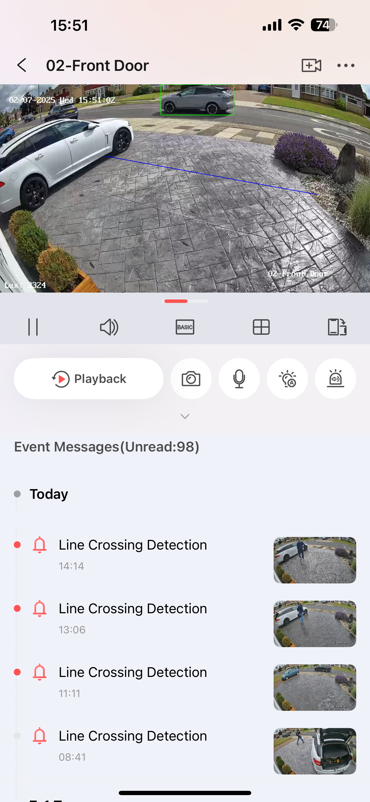

The blue lines from the line crossings I have set up don’t appear on HikConnect or the green/red box around people, I have 3x G2H and they are all fine but this G3 doesn’t show up, it still triggers a notification etc but I like to see the lines and what is triggering the event.
It works on mine so long as I have 'Display VCA Rule' enabled in 'Me' > 'Settings'. The camera below is one of my two DS-2CD2347G3-LIS2U/SL's. It's set for line crossing - Human and Vehicle. As you can see the line is shown and a passing car is highlighted so it's not a bug:

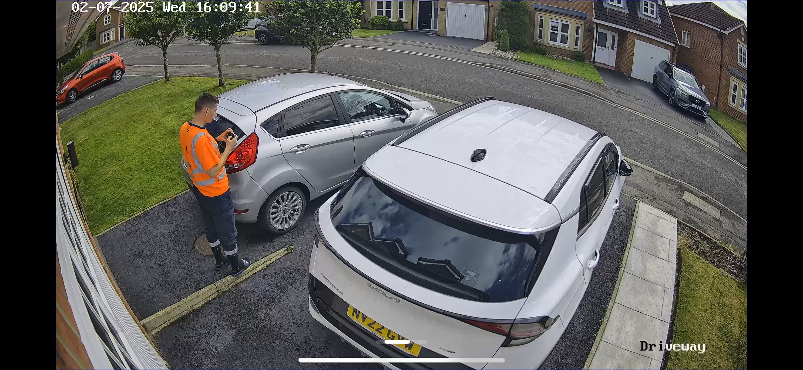

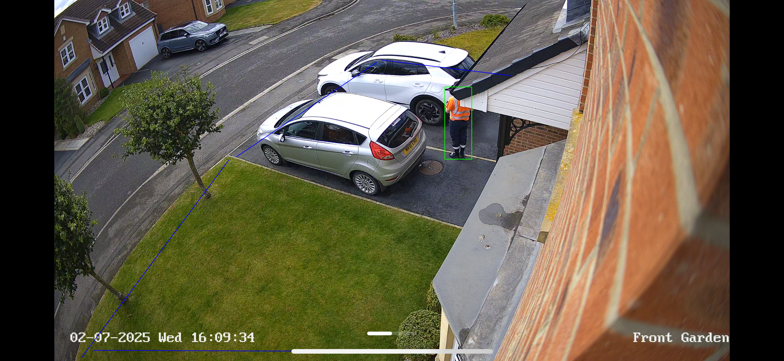

Here is some pics I just took from the 2 different cameras.

Yeah I have it set for dual VCA mate so I don’t have a clue what else to try , I’ve reset nvr and camera , reinstalled HikConnect etc lol.
And yeah it can be annoying I’m gonna adjust the line tonight as people walk past trigger it lol , thankfully I don’t have it set to 100 volume .
On the second camera there's a full screen outline in blue. Do you have intrusion enabled on that camera?
Ignore that I just added an intrusion area to mine while live viewing in Hik Connect and it appeared as soon as I hit save.
No mate I only have SMD>Line crossing enabled (I’ll double check them all tonight) it’s been like that ever since I installed it , but before I reset the nvr/camera etc if I switched the view from HD to basic it would then show up the blue lines lol
