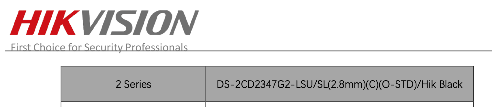

The release notes for the firmware show all Live Guard models (ISU/SL and LSU/SL) highlighted in grey:
Scrolling through 52 pages there's a little note at the bottom - "This version doesn't support /SL model."

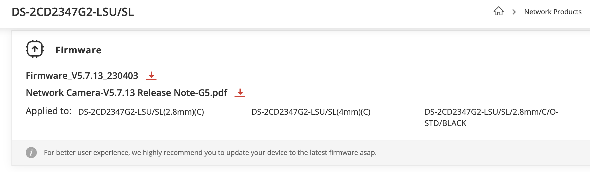

Yet on the product pages for the LSU/SL models:
So the release notes say it's incompatible, while they've posted the same version on the product page with a recommendation to update. Who knows.....

So according to the release notes the 2087G2 will be compatible but the other two are not. But as said they've posted the same supposedly incompatible version on the product page for those as well. I updated mine with no issues noticed as yet (2387G2-LSU/SL)

Yes the models ending LSU/SL are listed but blocked out in grey. There are some other new (unavailable as yet) dual light cameras that are listed and blocked out in yellow. That led me to scroll to the end where the comment was. Mine have been fine but I’ll maybe try the strobe light to see if it works normally as it’s a function I don’t use.

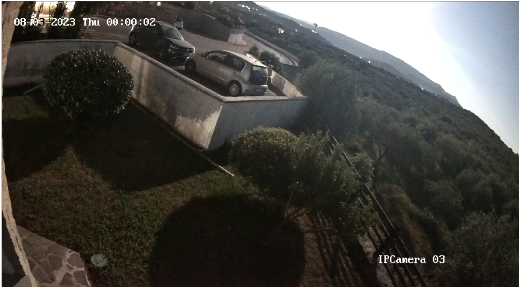

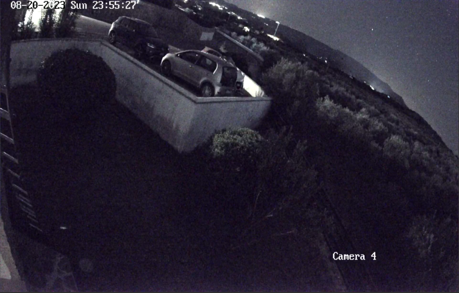

Good morning, I own 4 IP Cam DS-2CD2047G2-L after updating to version 5.7.13 the night vision has lost the ColorVu therefore at night if the light is not activated you cannot see anything ... before the images were clear and in color...does anyone have a solution?...Thanks

Hi @gabriele.nedok
Have you checked your camera's image & stream settings after the firmware update?
Sometimes settings can be changed/defaulted by firmware updates.
Your screenshot from before the firmware looks like the camera was set to 1/12 shutter speed to give that brighter image, after the firmware it looks like it might have changed to a faster shutter speed/exposure time (maybe 1/25 or 1/50).
Please login to the camera and go to Configuration > Image > Display Settings > Exposure Settings and check what the Exposure Time is set to.
FYI - a slow 1/12 exposure will give you a bright image but will also increase motion blur, if you do decide to use that exposure we would recommend checking your recordings at night for any motion to see how much motion blur you are getting. Night recordings that are completely blurred won't be that useful in a scenario where you actually need to identify something in the scene.

yes I checked, if I'm not mistaken, the new firmware has removed the lowest exposure times leaving only 1/12 up ... 1/25, 1/50 etc .... so I was considering trying to do the downgrade to 5.7.10...but I don't know how
Hi @gabriele.nedok
Okay, I think Hikvision have probably done this because of the motion blur issue and not being able to get any good detail of moving objects when the exposure is set so slow.
You can try downgrading firmware but I'm not sure this is possible with this latest version.
If you can't get clear images without motion blur at 1/12 or 1/25 and you don't want to turn on the built-in white light, then the ColorVu cameras are probably not suitable for your location as it is too dark for the Colour image to be captured without added illumination.
