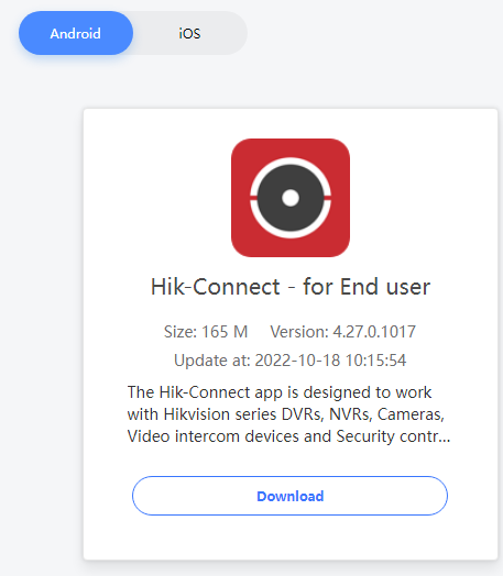

Hikvision released an update of the app (IOS v4.27.0.20221017). In addition to some new features it has fixed the bug where event playback did not go to landscape upon turning the phone (which seemed to affect IOS16 users)

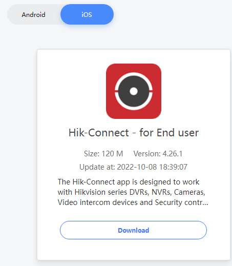

That new App release from yesterday seems to be only for Android?
The IOS release is still 4.26.1 from 10 days ago:
Those are just the hyperlinks from HikVision, apple app store obviously has the 4.27 version, it was released there on the 18th. (perhaps some regional differences are there in the app store, over here in NL it at least updated to 4.27)

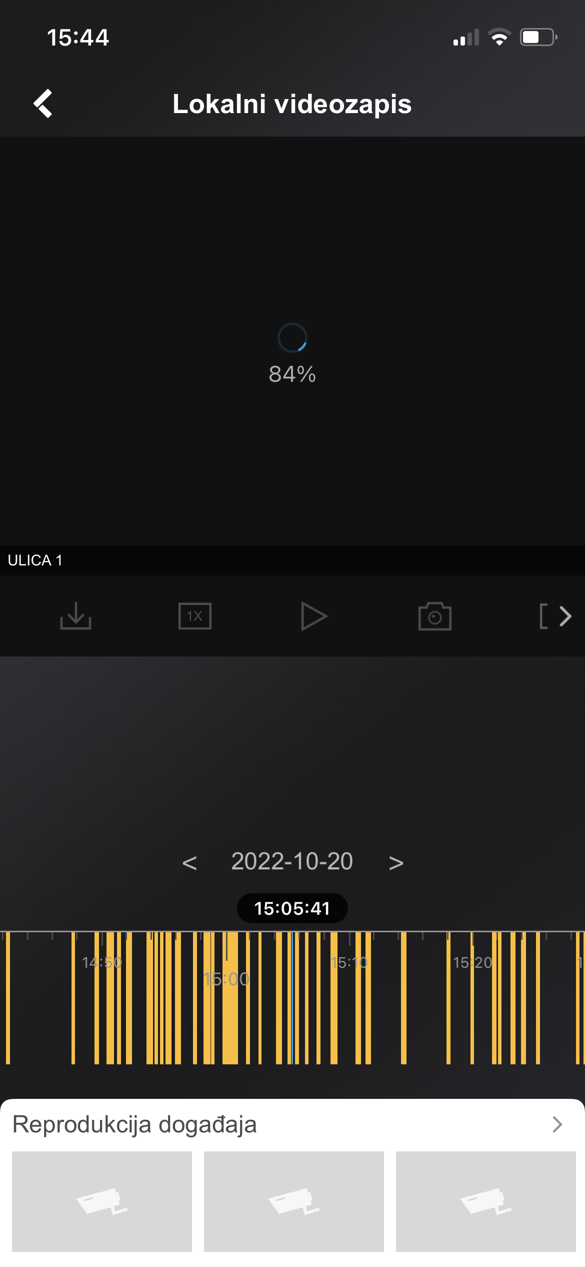

I already mentioned it in another topic, here I will ..
Iphone 12, iOS 16.0.3, version app 4.27.0.
DVR is 7204HUHI-K1, firmware 4.25.001
There is a big bug, I can no longer see anything recorded under playback, although the dvr records properly and I can view it when I connect directly via the ip address. I tried deleting and reinstalling the app, it doesn't help. Are you having problems?
