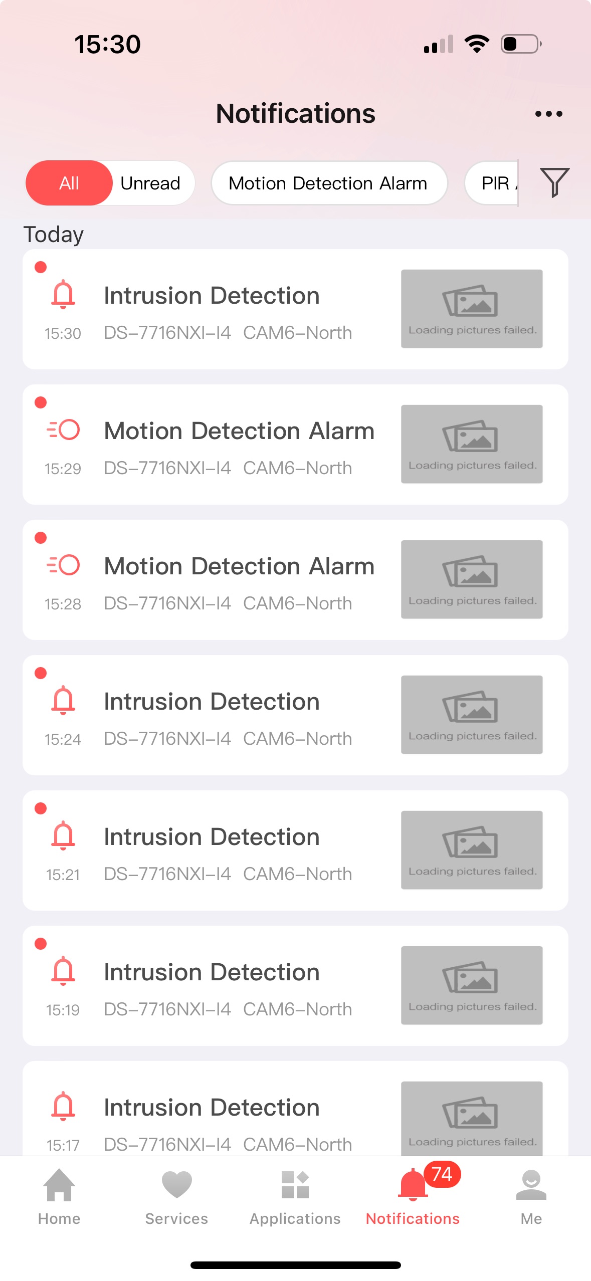

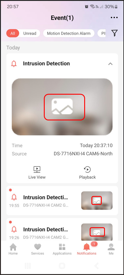

I have a Hikvision NVR 7716NXI V4.62 and various 4mp and 2mp Hikvision cameras, all on their latest versions.
I don't get preview pictures on the Notifications Tab in Hik-Connect - it used to work previously, and I guess it also had been earlier firmware versions, but now there are none shown.
Live view and Playback work fine, and in Search on the NVR, the event pictures are there.

Android OS 14, Samsung S21, Hik-Connect V6.2.18

I have only Intrusion and line Crossing Detection enabled on all cameras, 3 has the NVR do the analysis, the others are on the Cameras.
All of them fails to display.
I'll check the basic events on one camera
As you can see on this iPhone 14 Pro screen dump , the thumbnails also don't show for a standard motion detection

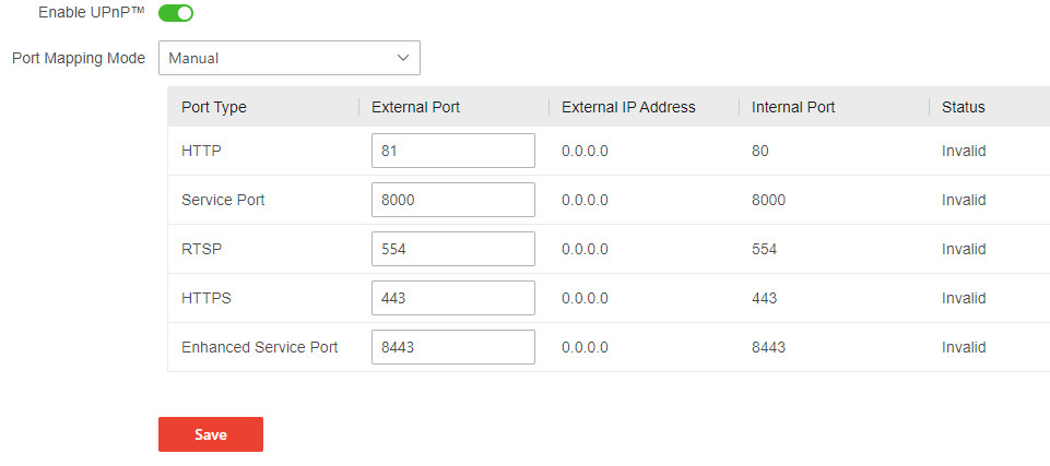

Some thing I also now realised and tested, the UPNP on the Cameras works fine with my OPNSense Router/Firewall, however the NVR's UPNP tab keeps showing invalid.
On the cameras I needed to reboot to get valid UPNP setting, on the NVR did make no difference .
NVR DDNS page is attached.
