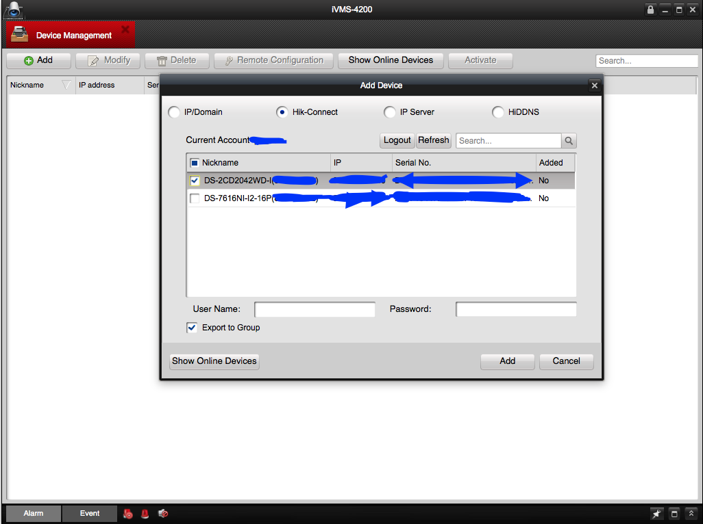

The mac is not in the same network - I'm trying to access via the internet without having configured any port forwardings yet. I know the LAN IP adress of the NVR. From outside over the internet it works with IVMS4500 and iOS.
Please see attached screen - I got it to login via Hin-Connect. However, I do not manage to add the devices successfuly. In this mask I enter the user name and password of the NVR / camera. After having added it also says: "Add correct" but the net status keeps showing an error message.

If you access your account at the Hik-Connect portal can you access your NVR?
Go to www.hik-connect.com
Login with your user name and password.
If you have successfully added your NVR to your Hik-Connect account (which you do seem to have done successfully, as your Apps are working) you should see a hyperlink to your NVR.
If you click that you should be able to remote access your NVR from your Mac (Safari) or a PC (Internet Explorer).
You should be able to operate and configure exactly as if you were on the LAN e.g. view Live, view recordings, access Config, etc.

thank you for your reply. I tried to access the NVR directly over the HIK-Connect account but was not successful. I can see the device with serial no. and URL and also as "online" but I'm not able to access it. The links is dead ...
However I also figured out that I'm not able to see a live view of my setup over iVMS 4200 Mac when accessing the NVR via Port forwarding 8000 which is my SDK port.
When I click on live image iVMS 4200 simply does not show any image. However, when I click on Group Management I can see thumbnails of live pictures.
