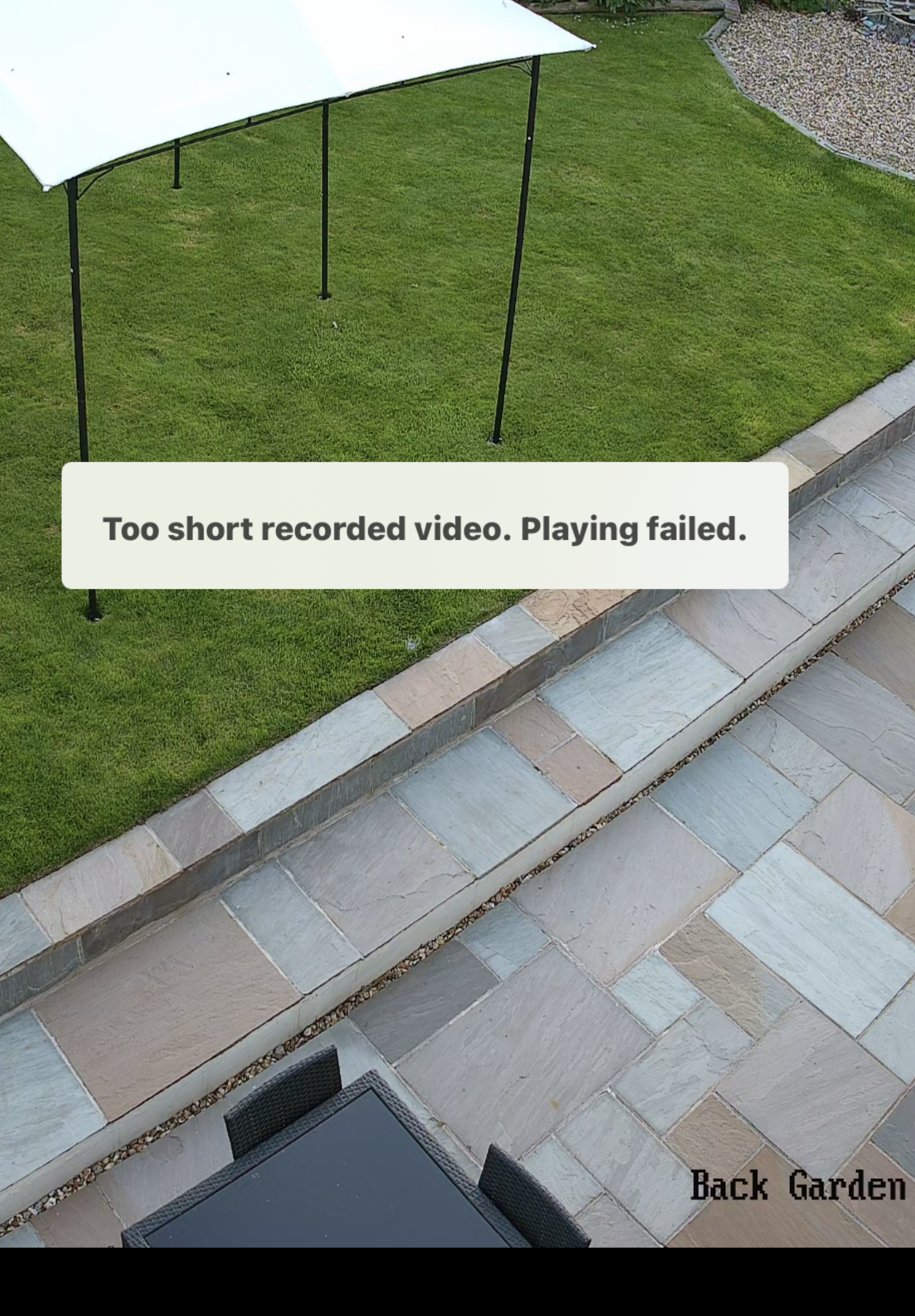

Hi all … I have a 8mp colour vu nvr system …ds 7608ni128p
and sometimes using the hikvision app while trying to save a playback recording I get a error message
“too short recorded video playback failed “
Any ideas what this means
I realise the minimum recording length is 10 seconds but these recordings are over a minute long
This is the message …
Ive got the latest firmware on the cams and nvr
I’ve initialized the hdd… repaired the database
and rebooted the system….
I don’t know what else to do … I’ve also got the latest version of the hik connect app
…. I’m thinking it’s more app related than it is the system
