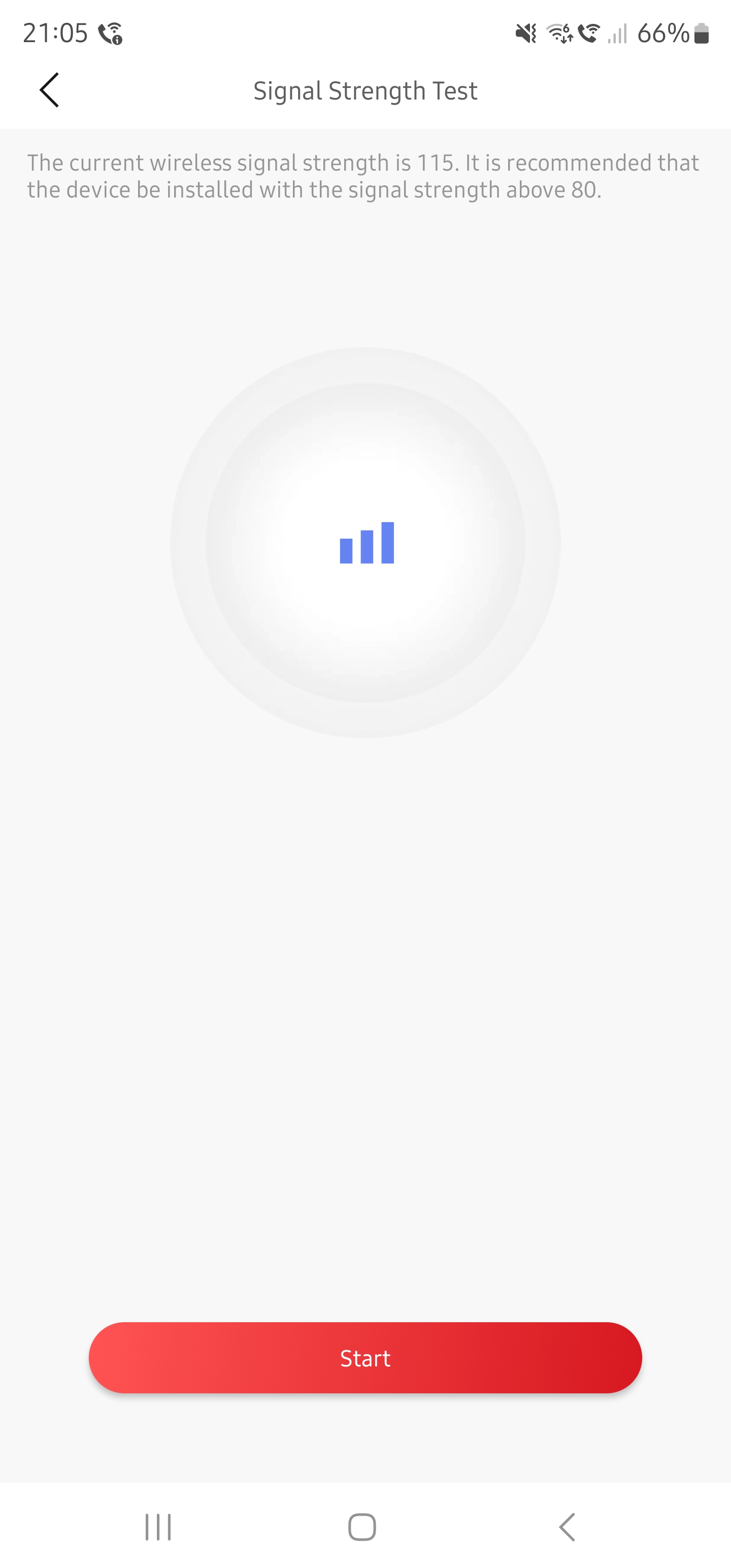

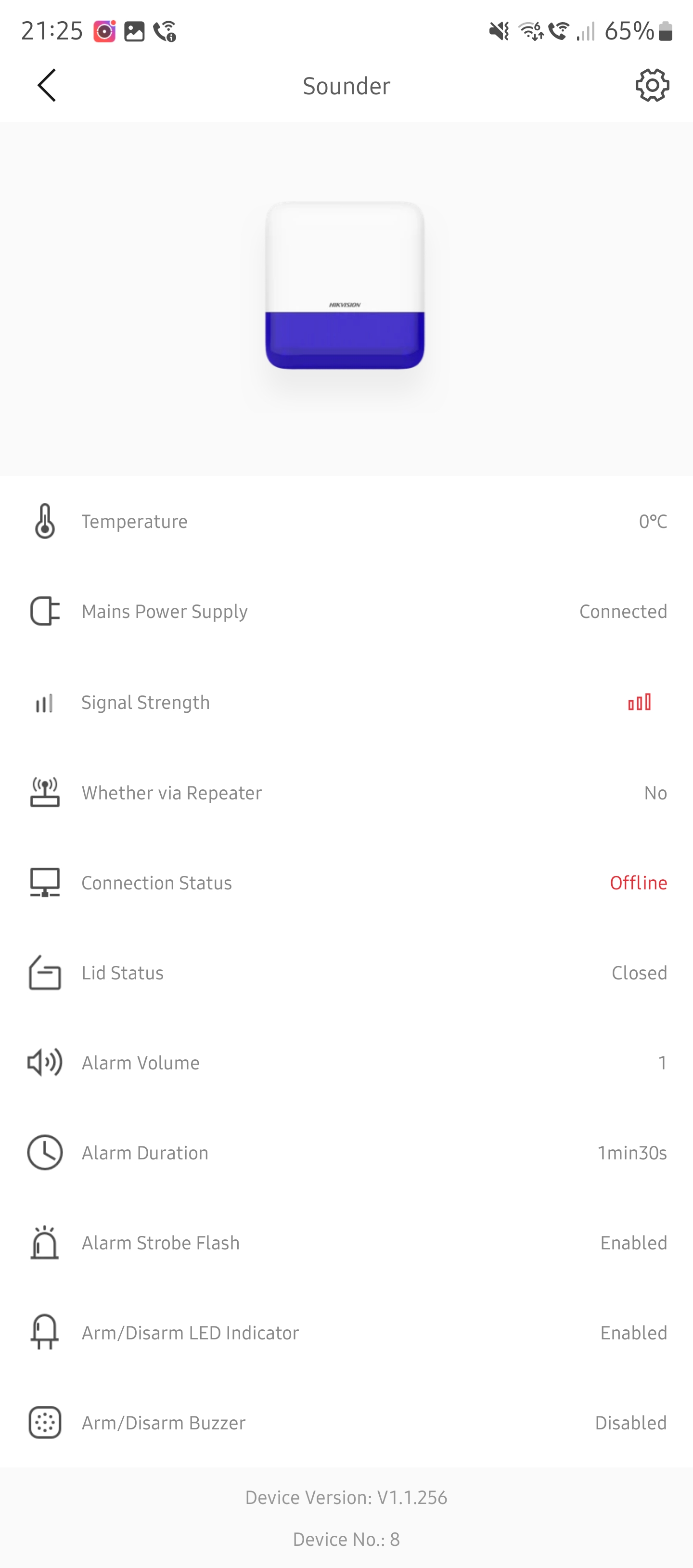

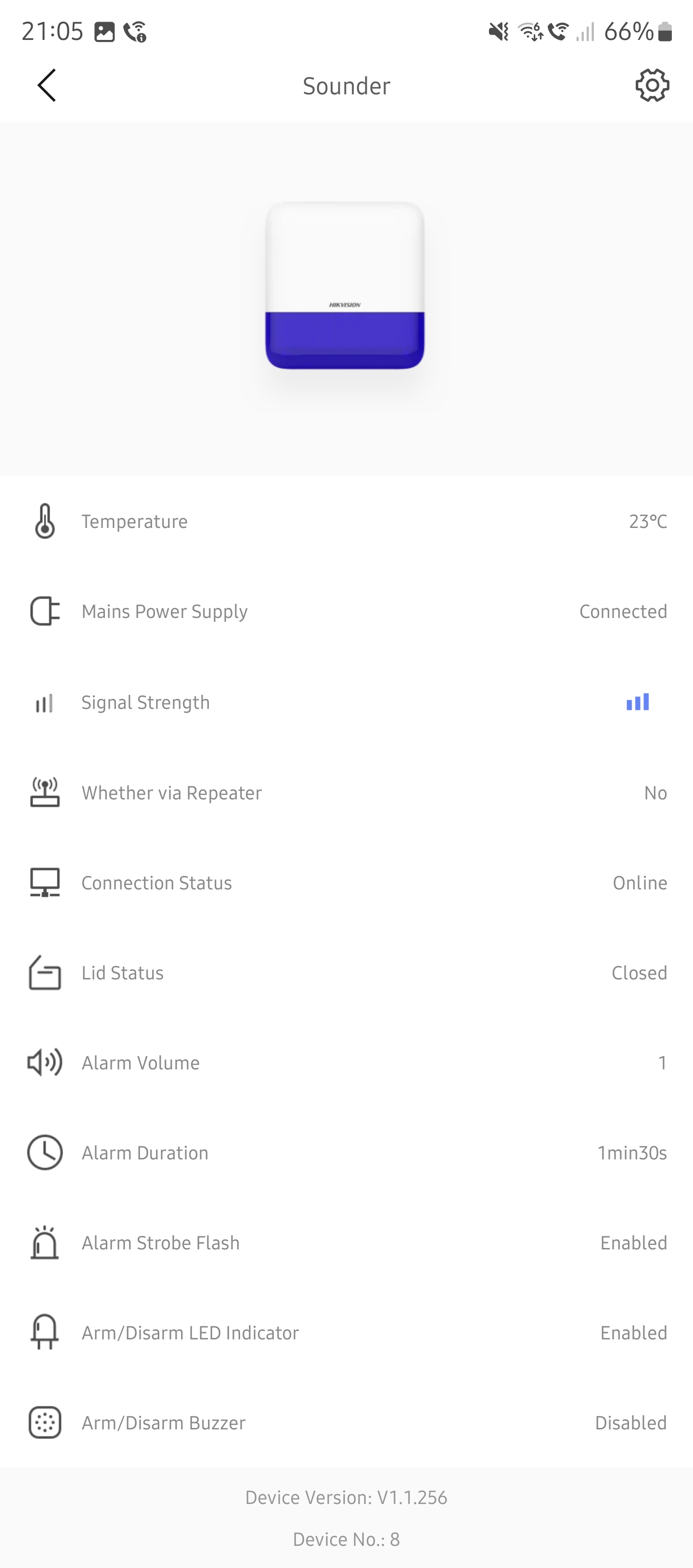

The external sounder has recently been installed, no more than 6 feet from the main hub, but it simply won't hold a connection to the alarm system. It cycles (based on nothing whatsoever) between full signal as we would expect, and nothing, showing as offline.
I have checked the power feed, the 12v is fine. I've formatted the sounder, no joy.
Getting pretty fed up, as when it goes offline, it beeps/blips every minute or so, neighbours not impressed.

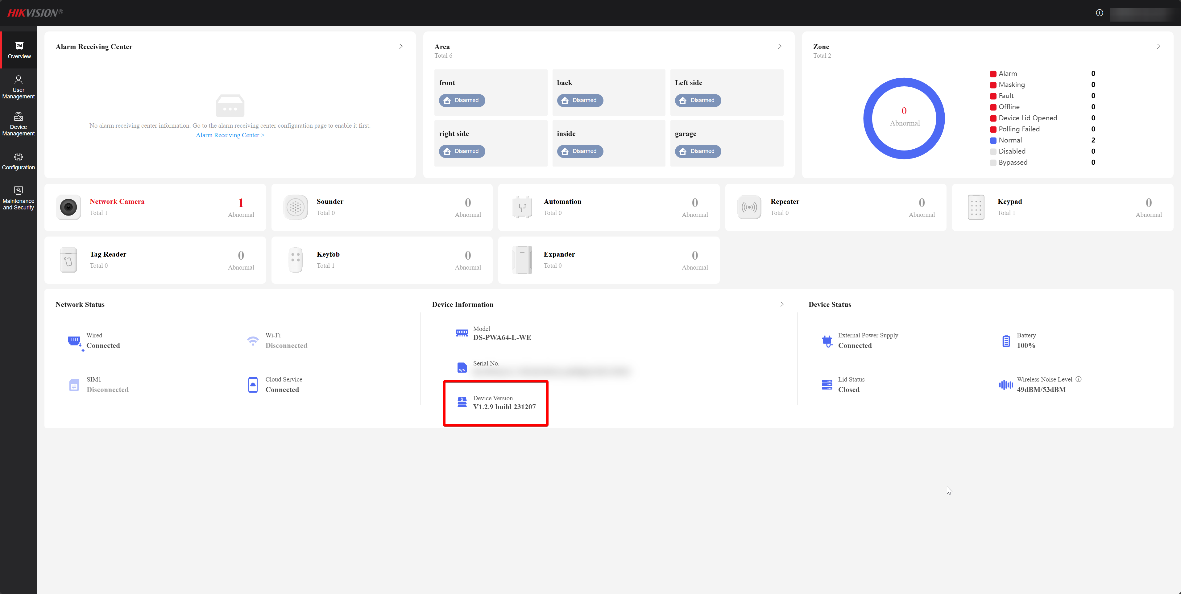

  2. Check the firmware version of the main hub in on the Overview page:

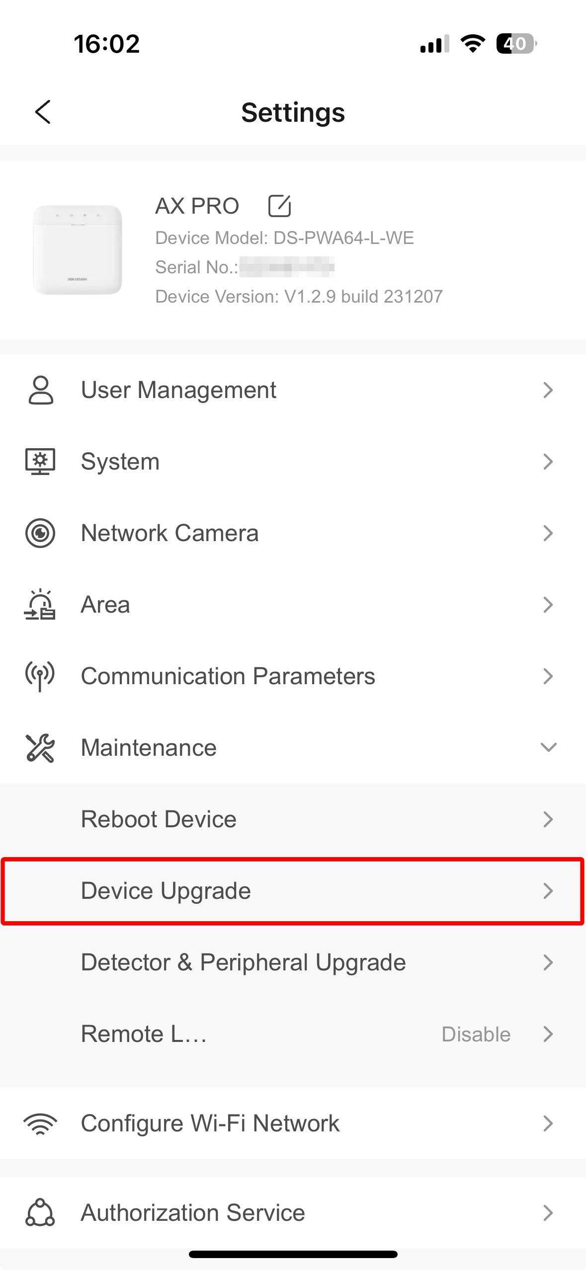

    If you're not running V1.2.9, update it within Hik-Connect by going to Settings > Maintenance > Device upgrade:

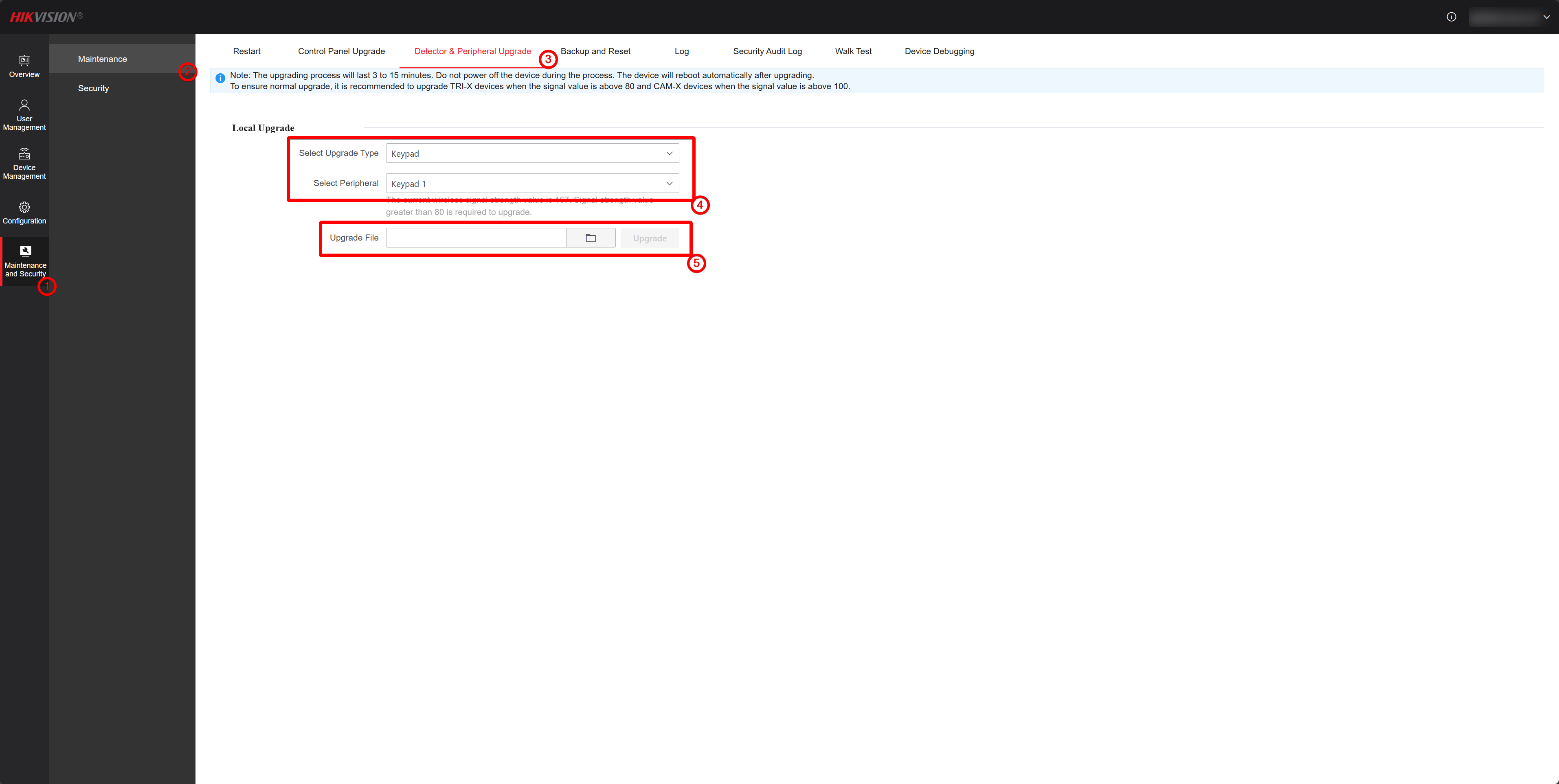

  4. To load it onto the sounder, go to Maintenance and Security > Maintenance > Detector & Peripheral Upgrade on the hub's web interface, select the sounder from the dropdowns, click on the folder button in the Upgrade File row to browse for the .tar folder, and then click upgrade:
    You should get a status bar appear as the firmware is updating, and then the sounder will reboot.

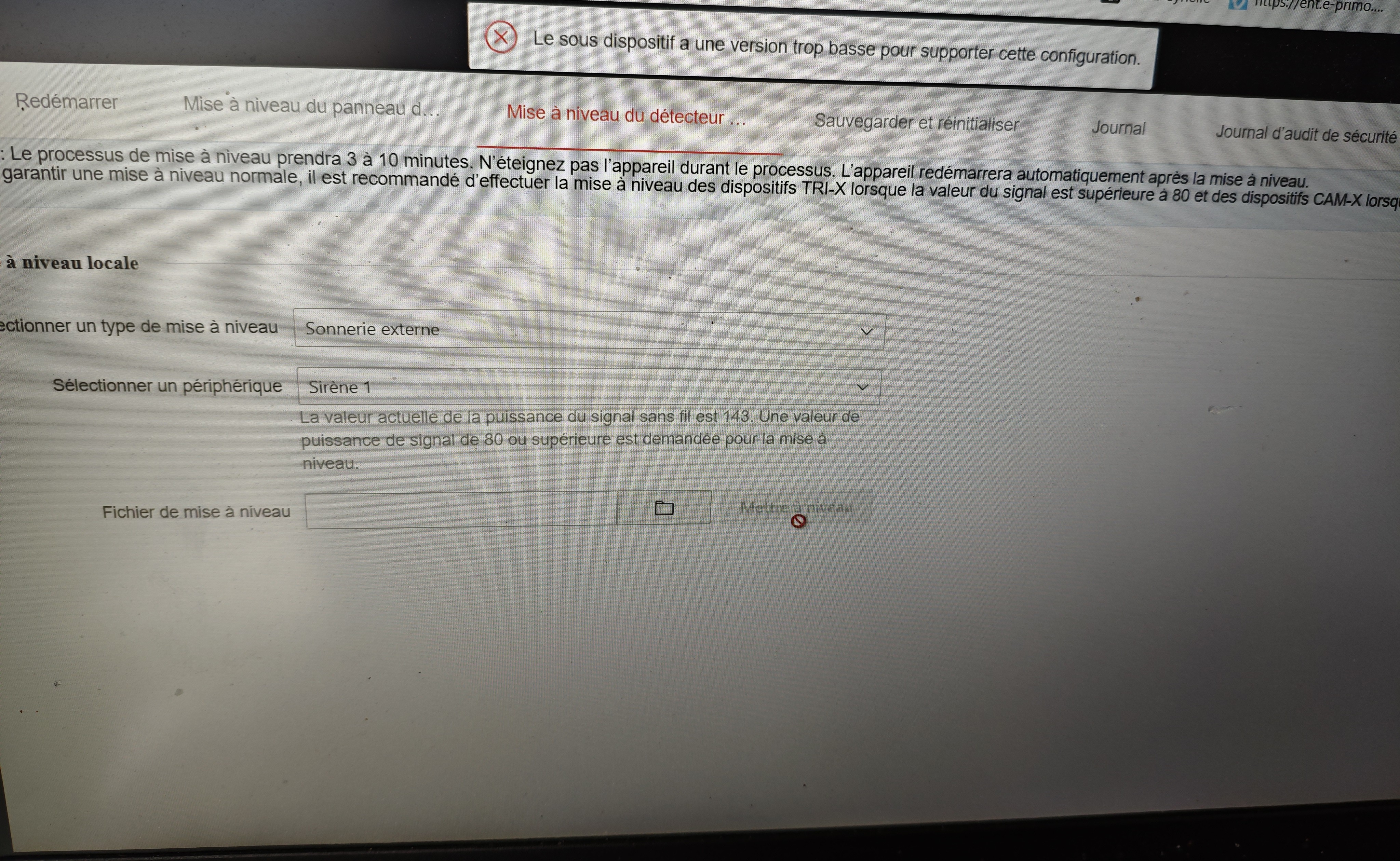

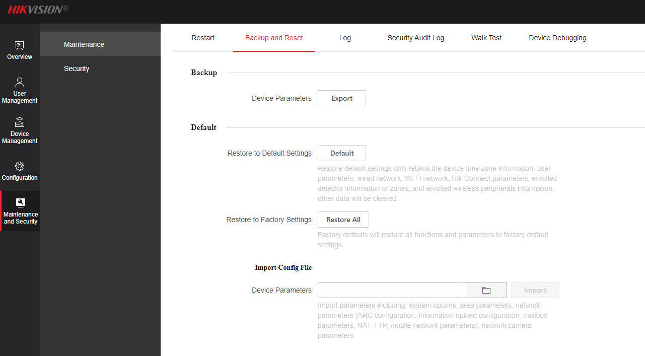

Thanks for this. I don't seem to have an update/firmware tab - any ideas on this please?

Thanks for this.

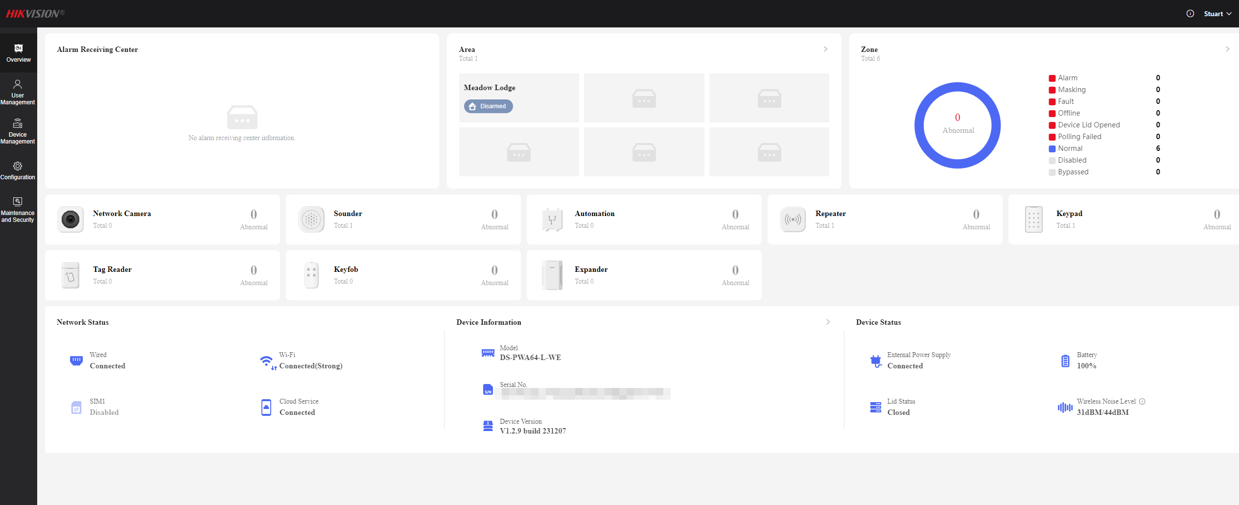

That's strange... Can you send a screenshot of the "Overview" page please (same as my first screenshot above)?
Thanks - first try deleting your cookies for the page and refresh it with fresh cache (Ctrl+F5).
Make sure your browsers are up to date too.
Are you using Windows or macOS, and which browser?
Hi Kyle,
I've done all this, plus tried different browsers (I'm currently using Chrome) including edge and firefox. No joy I'm afraid.
I'm down as an administrator on the user management page, does that affect firmware access?
You need to be logging in with the Hik-Connect administrator account credentials to access the firmware, so you should be seeing that page.
Try running the browser as an administrator (right click > "run as administrator")?
If that doesn't work, try adding the panel to iVMS-4200 and seeing if you can see the page by accessing the config menu there.
You could also try in Hik-Connect in Settings > Maintenance > Detector & Peripheral Upgrade in case it works for you, but it didn't for us...
