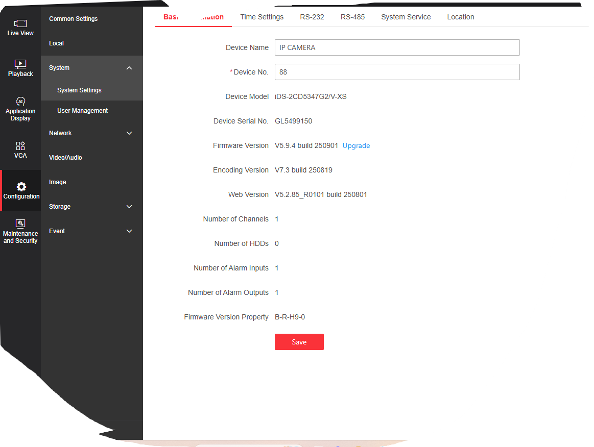

The camera arrived and was installed -- iDS-2CD5347G2/V-XS
The test can begin.

Hikvision NVR - DS-7608NI-M2/8P,firmware V5.04.081 build 260112.
I installed the camera with the firmware that came with the camera and I could not enable "smart event" directly on the NVR.The button on the NVR did not want to stay in the "enable" position. The button always returned to the initial position.But the camera was working and sending notifications to the NVR.
After that, I installed the new firmware that you sent and the situation improved. I was able to enable the "smart event" directly from the NVR.By changing the firmware on the camera, it was good.
The date of manufacture of the camera is 12/2025
JB1970
The version the camera came with was V9.5.4...... and the current version is V9.5.20.....the difference is 20 - 4 = 16.

That's not how it works! I'm no expert but take the first number as the major version or platform, the second number would be a release incorporating multiple changes and the third number (or 'point' release) is minor revisions. In the case of your camera there aren't necessarily any versions in between .4 and .20 available, but the developer may have worked through multiple minor code revisions that weren't released.

What did I do--I updated all 4 cameras and NVR again, but this time I downloaded all the updates from one place.I downloaded all the firmware with the help of the serial number from Hik-Partner pro.
