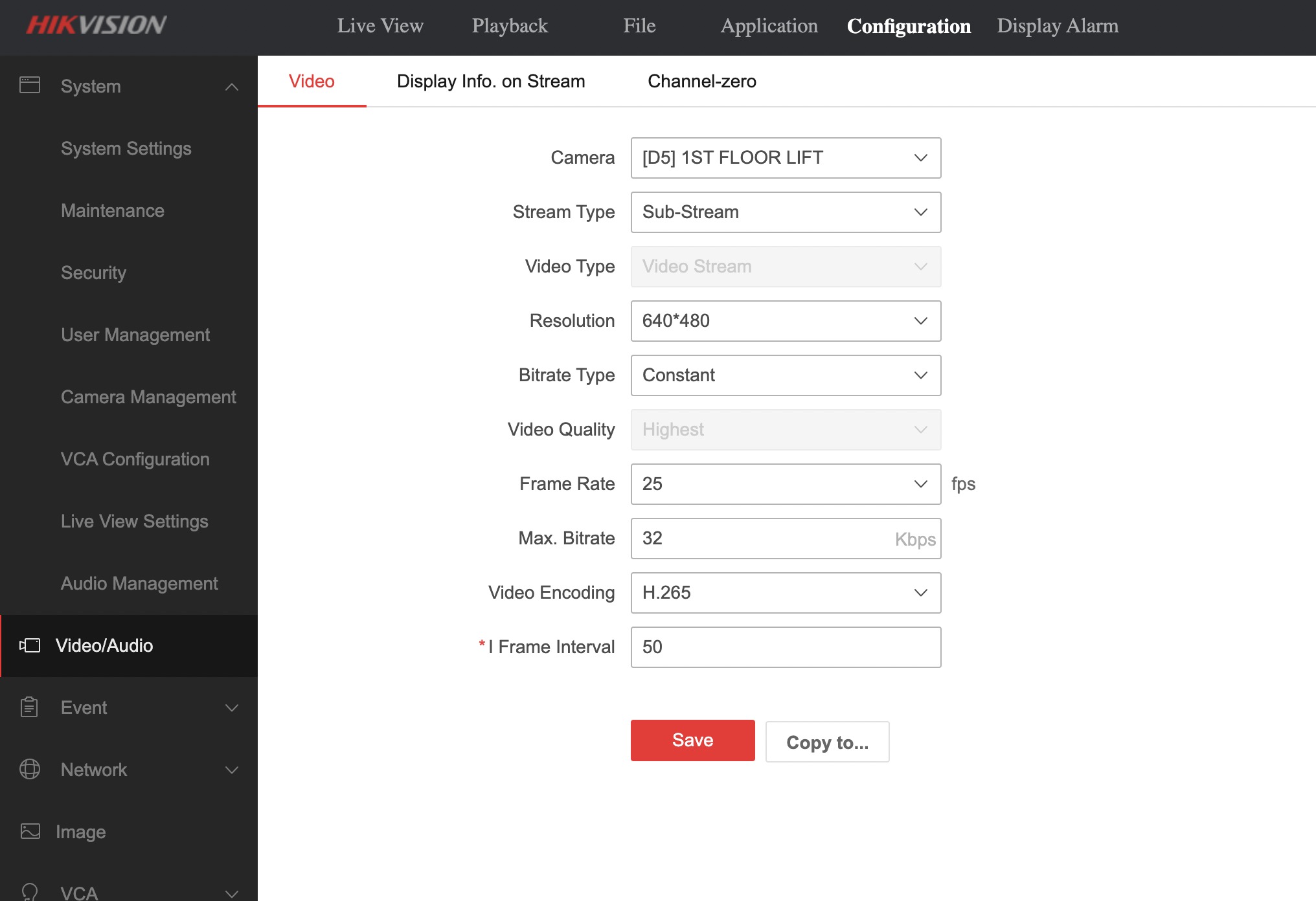

Do you know what the I Frame Interval setting should be?
( this is a new setting that was not visible under V4.51 )
I read ( obviously missing the core concept here to figure it out myself ), some of the arguments say half the frame rate, others say equal to the frame rate and I raid some say double the frame rate.
It all sounds like grasping at straws to me, as there is no way all three of those answers can be correct at the same time?

There's no real rule for this - it's normally fine just left as 50 in normal residential scenes, many like to set it to match the frame rate, but it's not really necessary to set it any lower than that.
Setting this value to be lower will increase video quality, but will increase the bitrate used by the camera.
Dan has explained I Frames nicely here:
