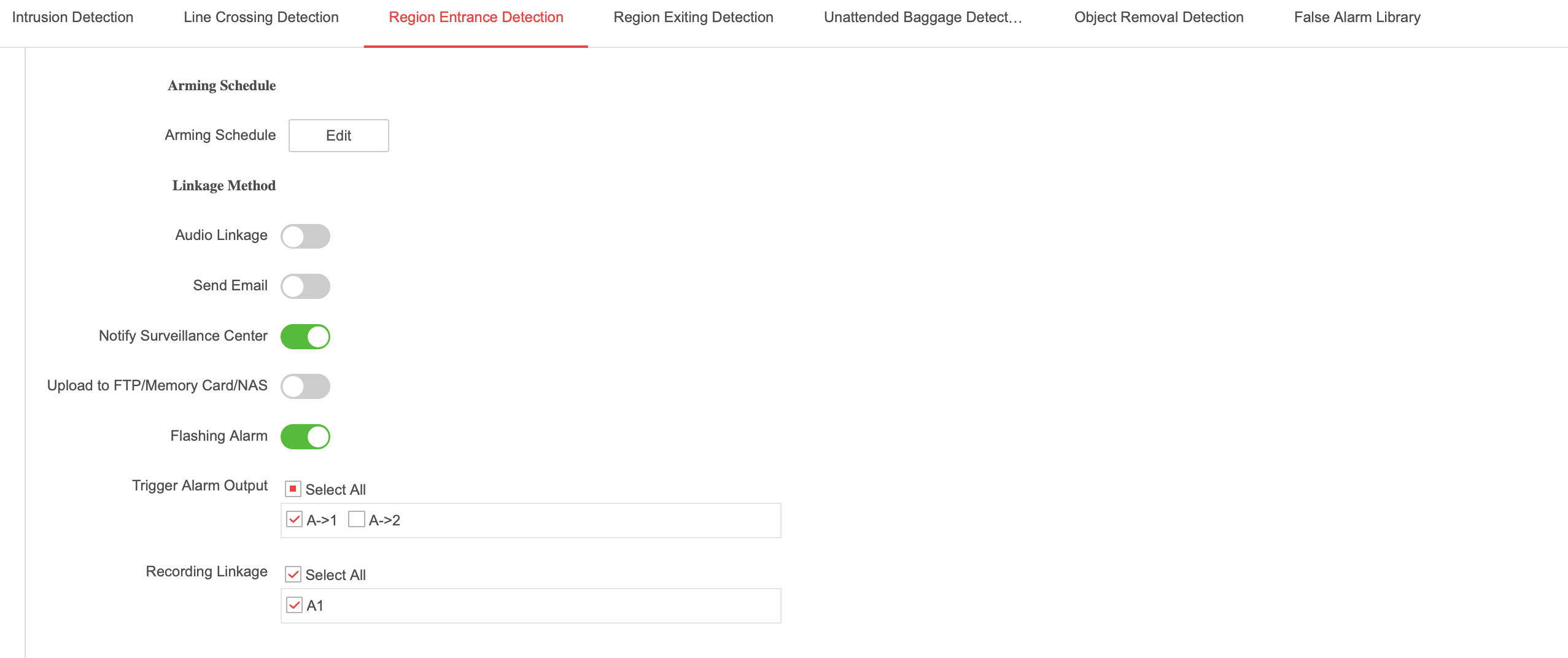

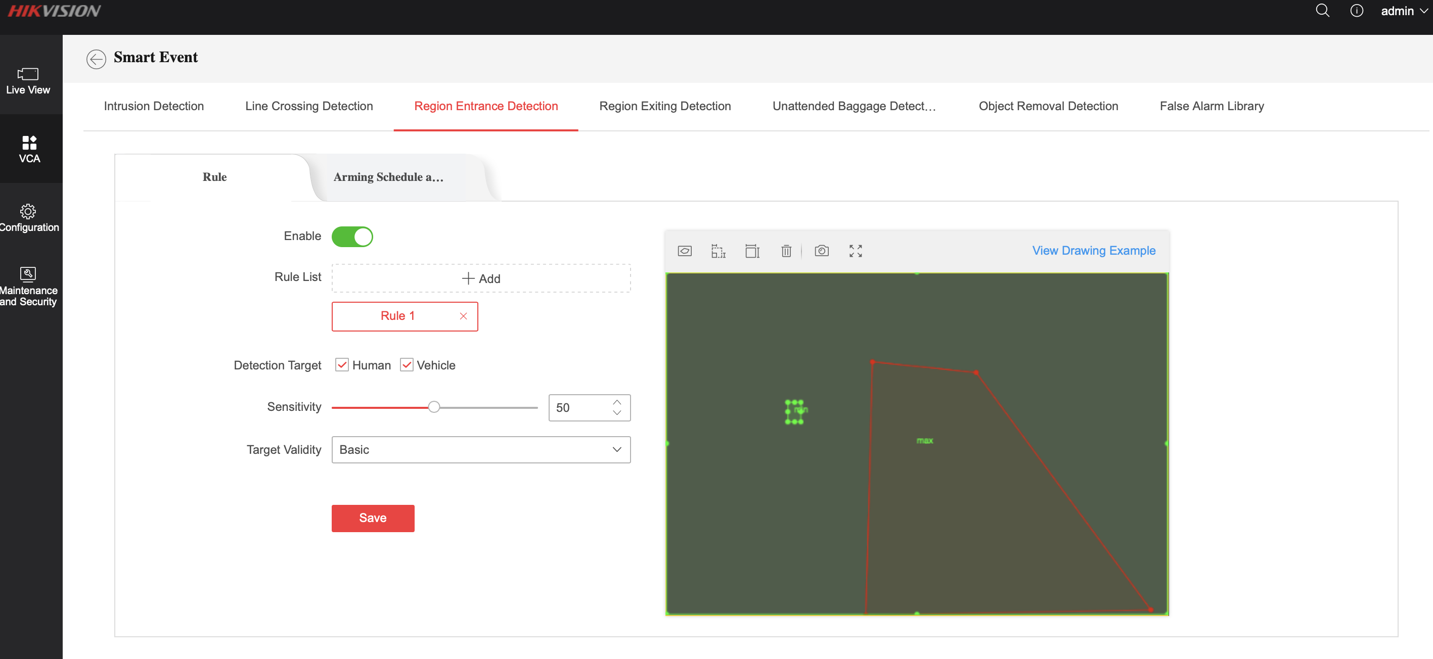

I activated the smart function(s) (region entrance and/or intrusion detection) of each related cameras. I drew a security zone. (A1) selected as Trigger Alarm Output via cameras web portal. When there is a violation in the safe area, the camera's flashlight turns on; the camera gives an audible warning as per its own feature. However, when the alarm is active, I expect the alarm to be triggered, but it does not trigger the alarm.

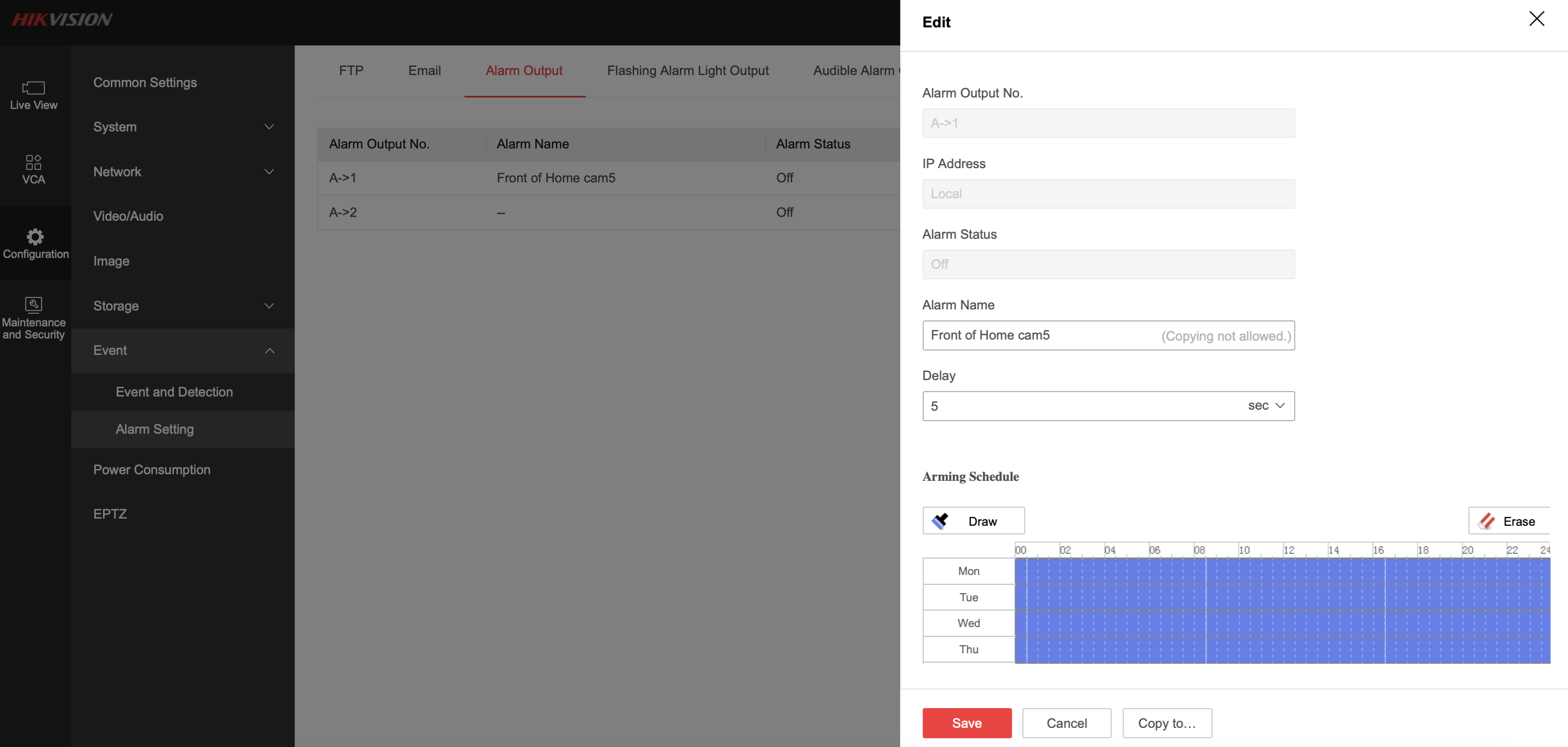

Is the alarm output schedule set to 24/7?

Is the alarm output schedule set to 24/7? WHERE SHOULD I CHECK THIS? IN THE CAMERA'S WEB PORTAL? OR ALARM MODULE? CLARIFY PLEASE??

Alarm output schedule its in camera web gui

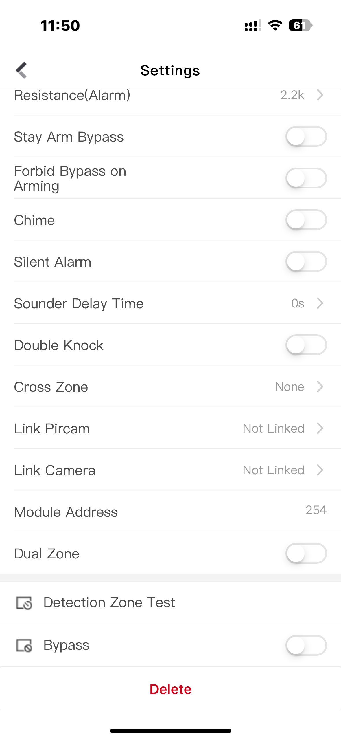

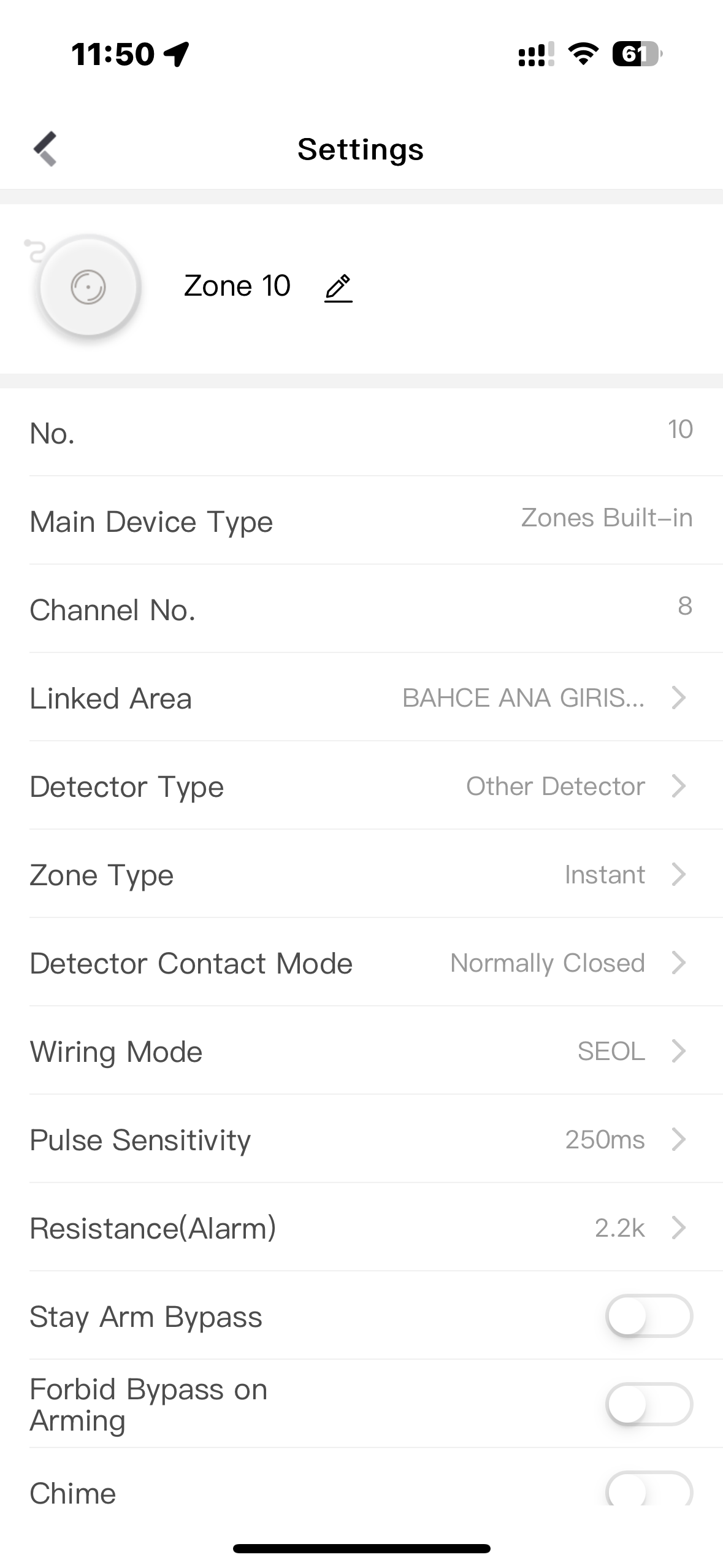

Defining zone - can you screenshot zone settings?
Perhaps you need to switch NO/NC to actually trigger, need to see zone settings in order to add additional information.
for the 2x0.75 cable coming from the camera's alarm output, I connected it to zone 8. As far as I know cameras alarm outs NC. I setwiring mode as SEOL and choose 2.2k resistance.

Yes since output is open collector and it does have some resistance by itself. Since you added 2k2 to that output and said in zone settings its 2k2. It wont work if its other value.
Remove resistor and change from SEOL to NC
Let me know the results

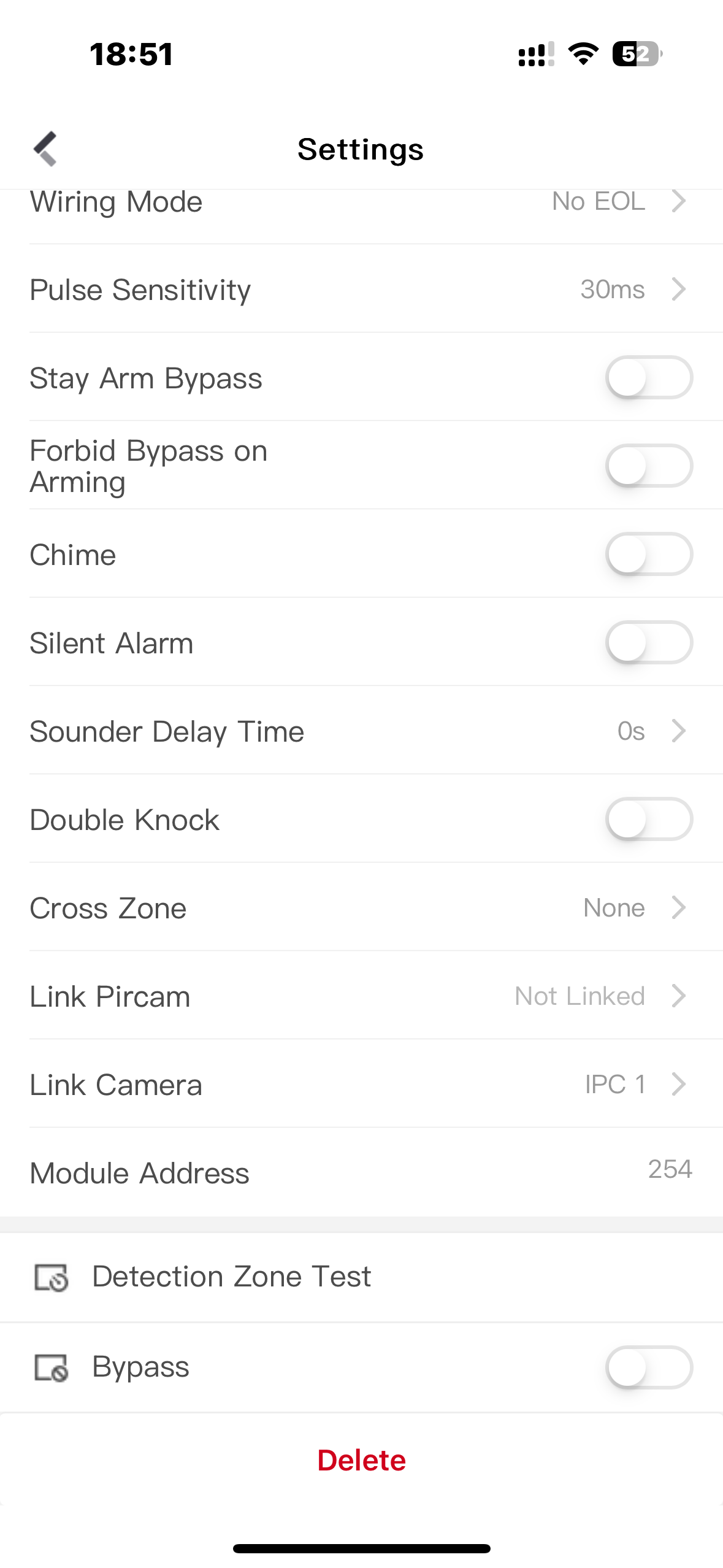

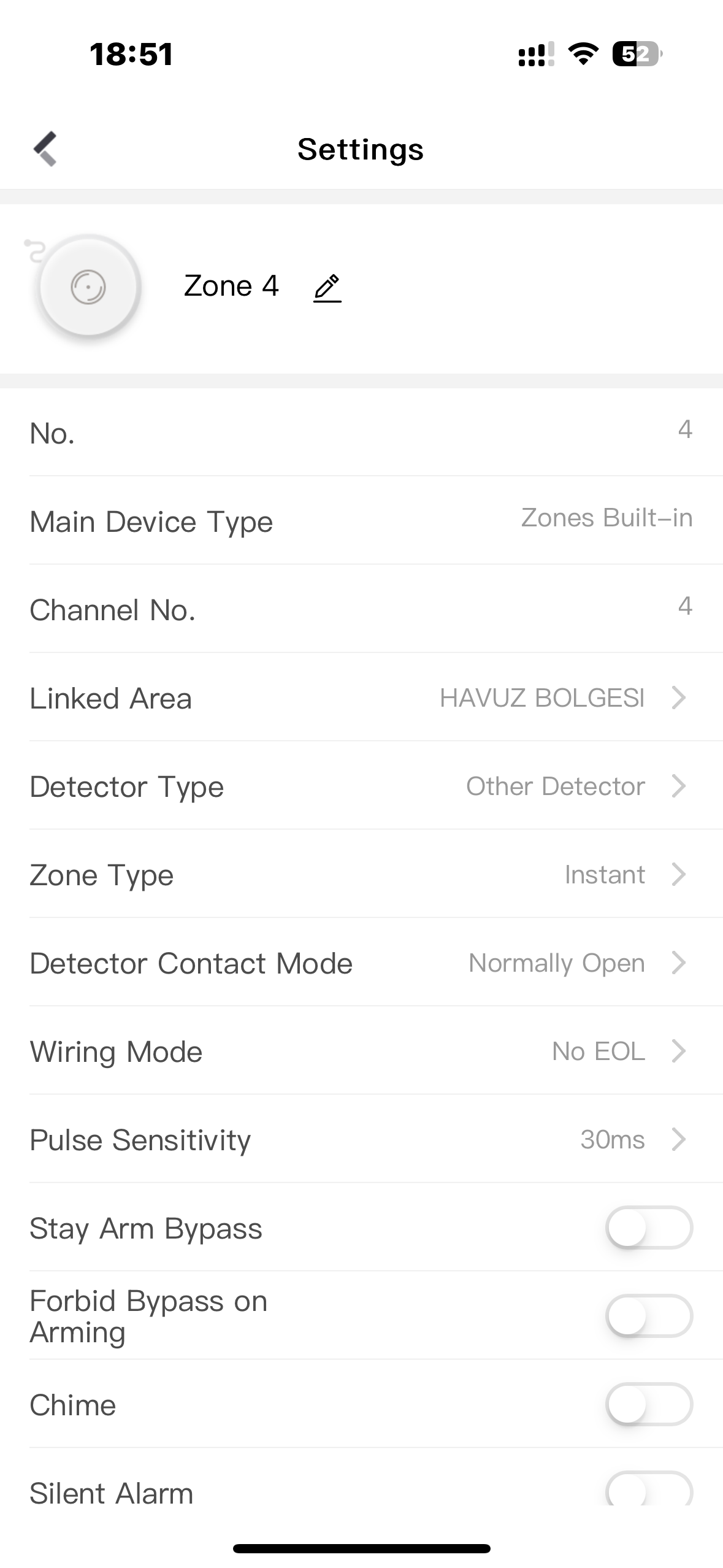

    • From the mobile app, I added the related camera as network camera to alarm system and a new device as an “other detector”. I’ve set the settings to wiring mode: No EOL; detector contact mode: NC, linked related camera. Please see the attached pictures.
  • After the above settings, I tried arming the related zone to make a test. Fault! I changed the Detector contact mode to NO and tried again. The system is armed for this zone. However, when I walked in the Intrusion area, neither the flash worked nor the alarm triggered.

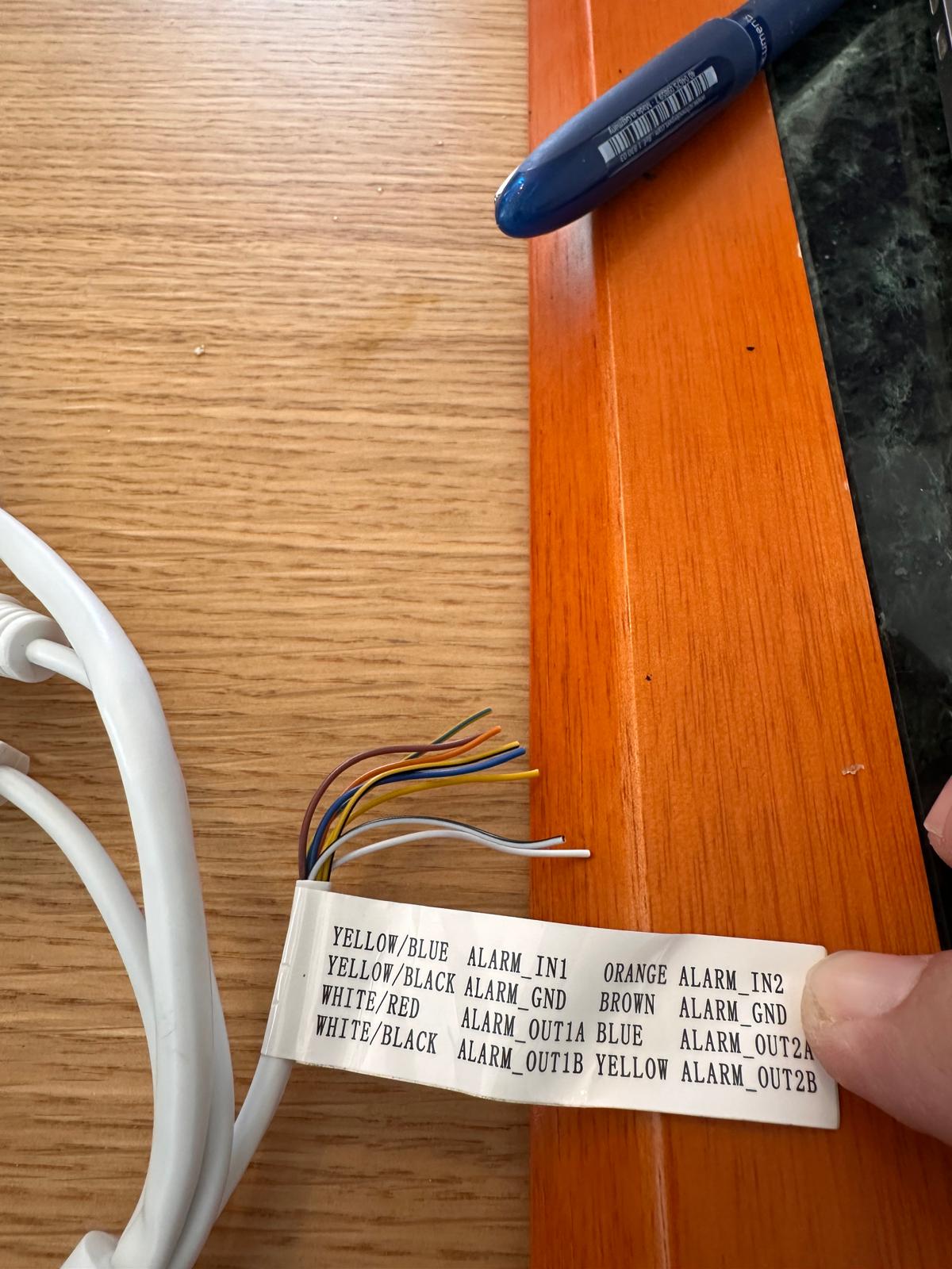

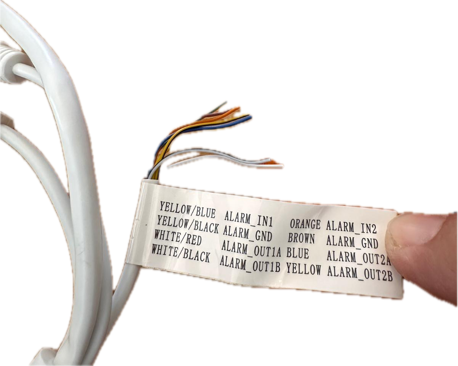

hi, good morning. I'd like to inform you that the length of the cable I use is about 5.5m. Even so, do you want me test with shorter cable? Besides, I want to make sure that I have connected the camera's alarm output wires to the correct place on the alarm panel. which cable should be connected to the zone terminal in the alarm panel: Alarm out1A or Alarm out1B? Please look at the attached picture .
I want you to test with anything you have. Just to see if Zone is triggering at all.
Like any scrap of wire you have. Could be 10cm wire, just short Z and COM

1) I set the ”detector contact mode” as NC.
  • ·The camera couldn’t recognise any moves in the area.
  • ·I started the “detection zone test” from the app. It didn’t respond to movements.
  • ·I tried to set arming related zone: fault
2) I changed the setting of the “detector contact mode” as NO
  • · The camera’s flashing started Immediately recognising moves.
  • · the “detection zone test” from the app. Responded as "detector is normal status".
  • · Armed as away/stay the related zone: I started moving in the area. The camera did not respond for a while. I continued moving and after a while alarm triggered. The buzzer of alarm panel started alarming, and i received a warning “burglary alarm” from the mobile app

If we are going to accept our test result is correct, I would like to inform you about the connection between the camera's alarm output and the connection port of the Alarm panel: white/black cable from the camera (out1A) goes to the COM port and white/red cable from the camera (out1B) must be connected to Zone.
