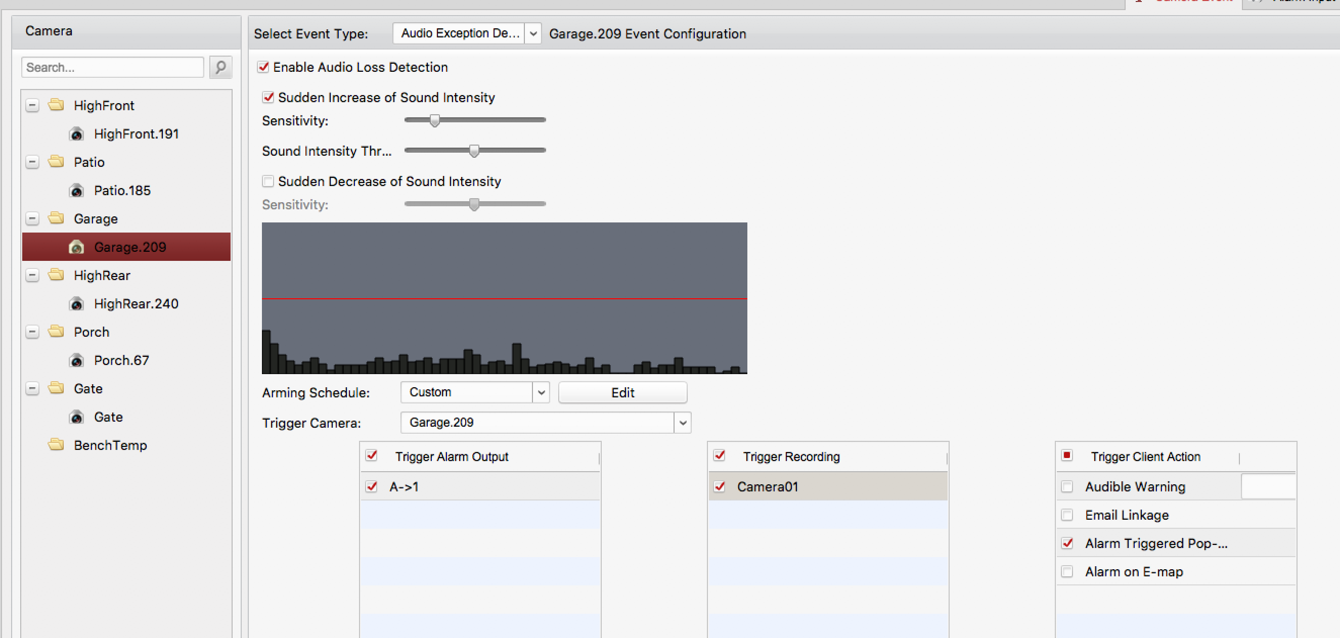

I confess that setting up Triggered Cameras is above my pay grade and I’m not sure if/why I would need any triggered devices. In any event, I assume that the unchecked Trigger Alarm Output checkbox at the top means that no triggering will happen even though triggered cameras have been selected. The only camera I want involved is the Garage cam where ideally I want to find an event video recording whenever an Audio Exception is triggered.

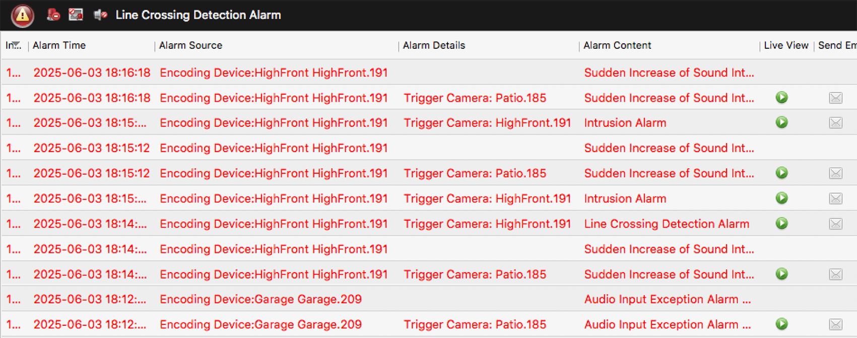

As the log below shows (I think), Garage cam did record an Audio Exception event at 18:12 – although I don’t know why my Patio cam is shown as the Trigger Camera. (I assume the green Play buttons indicate a video recording.}
But the 18:15 barking was recorded on my HighFront PTZ cam which confusingly was temporarily pointing at the dog and also had Audio Exception enabled (together with Line Crossing so presumably wouldn’t have been activated by two different smart events, even though this log appears to show both types of smart event working for that camera whereas Garage cam had only one type of smart event enabled).
I’m obviously very confused here. Why would Garage cam record an Audio Exception event at 18:12 but not the barking at 18:15? Is it possible that the same audio event cannot trigger two different cameras (in which case I need to turn off Audio Exception on HighFront cam). And why would I want any triggered cameras? Should I turn all triggering off?

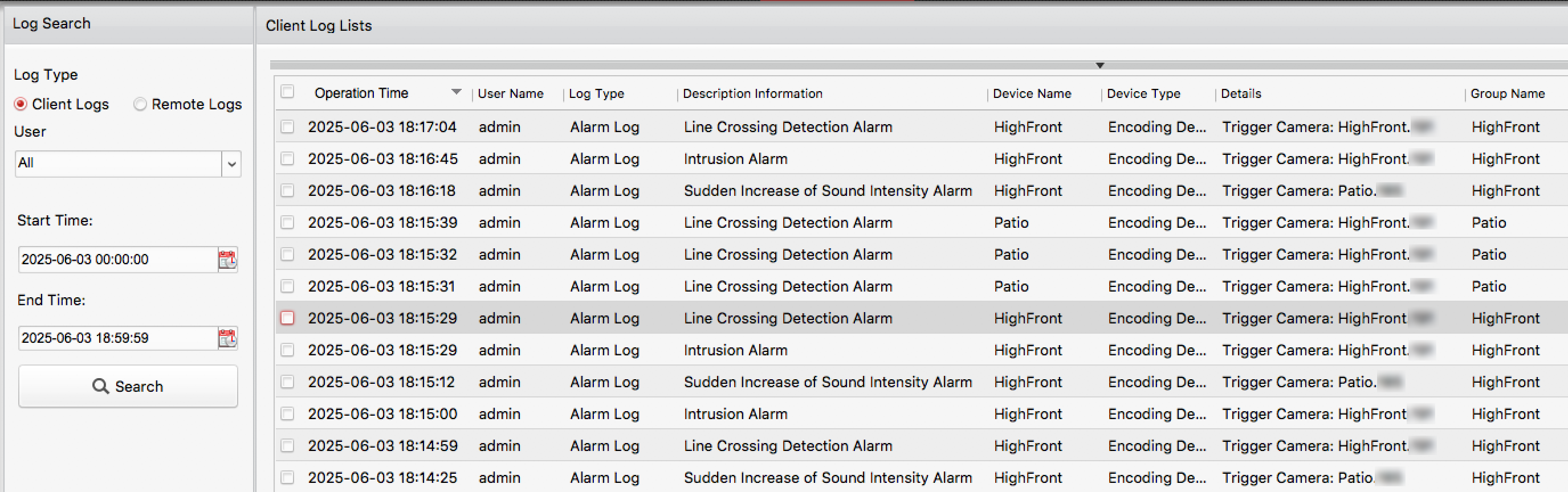

Checking back in the client logs for the barking noise the other evening, I see Noise Exception events recorded by the HighFront cam but nothing for Garage cam…

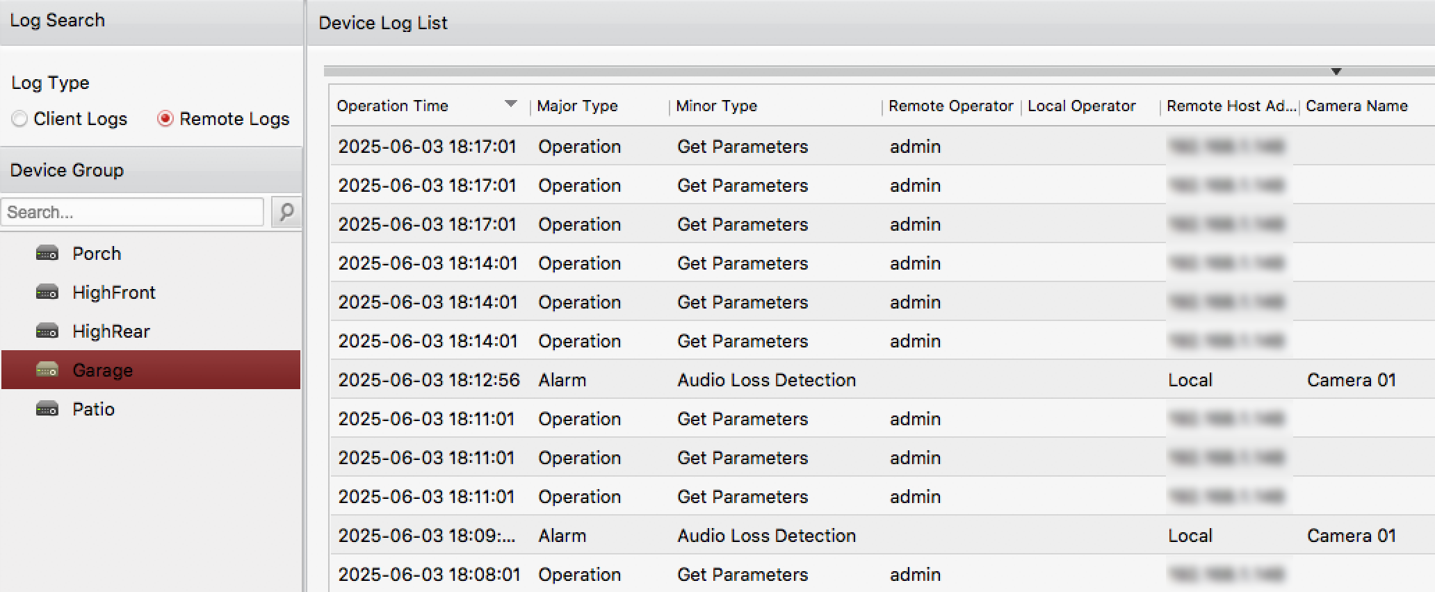

And the remote log for the Garage cam reveals nothing apart from a couple of Audio Loss Detection alarms, whatever they are (they can't be Noise Exception events because the option to detect a sudden drop in audio level is not selected. Maybe it's telling me that the microphone is faulty?

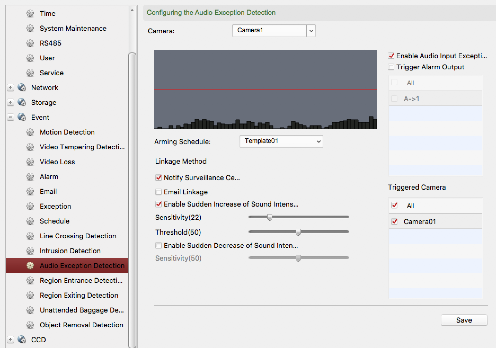

Well, I'm a little wiser, but not a lot. I managed to stop my HighFront cam being triggered by alerts from my Garage cam and my Garage cam is now issuing an alarm notification when its Audio Exception alarm is triggered. However, the settings below don't result in any recordings to my Garage cam SD card – or anywhere else. I do see a pop-up alert notification which displays a static image with no audio but when I hit the button to play that recording, I get an error message saying that no record exists.
So, do I need to change any settings? Or am I chasing rainbows because it isn't possible to record Audio Exception events to an SD card?

As an aside, I am frustrated that my Mac iVMS-4200 seems incapable of remembering my chosen arming schedule. Having selected and configured Template 01 for this event, it doesn't seem to be properly saved above (the camera's config saves it as "Template 01" but not here in the Event Management tab because when I click on "Edit" it opens up the default All Day template.
