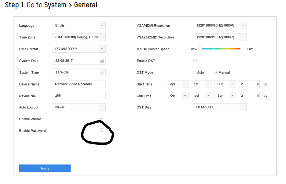

Phil,
Found a fix,
Locally on the Server output (not web login)
Go to settings,
Disable password, it will now boot to live view, password is only for local view and not remote access.
