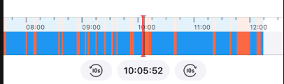

I am using a Hikvision camera, and when I enter playback mode, the timeline appears as a solid green bar without any highlighted event markers to indicate detected activities.
On my iPhone, the event highlights are displayed correctly, as shown in this screenshot:
Screenshot

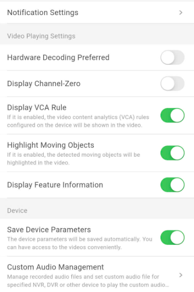

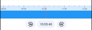

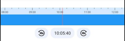

However, on Android, the event highlights do not appear. Here are my configuration settings and the playback screen on Android:
Screenshot
Screenshot
How can I make event highlights appear on Android, just like they do on iOS?

Are you logged into the same Hik Connect account on the Android phone as the iPhone? The markers don’t work if you added the system to the app as a local device.

Not all are different accounts. I use several Android devices with account A, which is shared with three other accounts: B, C, and D. Among these, the two accounts (B, D) using iPhone (iOS) are highlighted, while my account and the remaining shared account (both using Android) (A, C) are not highlighted.
