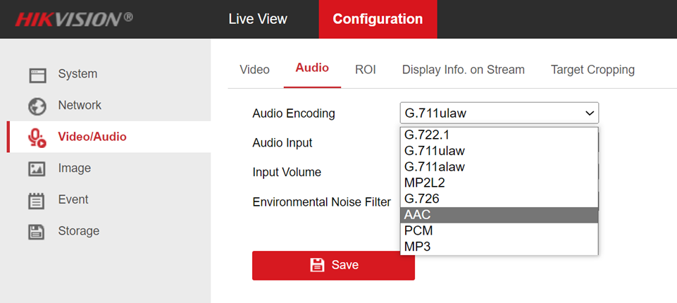

What camera & NVR models do you have?
We checked a current AcuSense 8MP camera model and it does support switching AAC audio (see below) but you have to login directly to the camera to change the audio encoding.
If your camera is plugged directly into the PoE ports on the NVR you can enable Virtual Host to login to each camera directly and adjust camera-specific settings like this.
