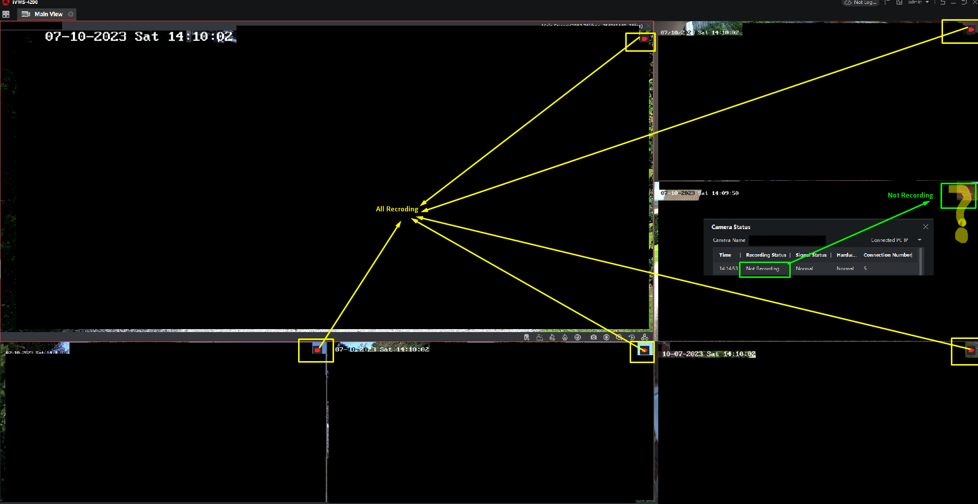

My issue is the "recording". Albeit it is recording to the NVR HDD, I cannot see any playback in iVMS. I get a consistent message "Main Stream playback failed (No record file found. Check if the stream is configured with recording schedule). Also, on the iVMS when all cameras are on display, all apart from this IP Camera camera has a red camera on the top right of each image which is "recording".

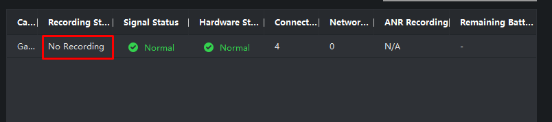

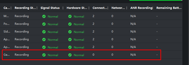

Attached is the "Device Status" on the iVMS-4200 Device screen. You can see under the NVR cameras it says "recording" but on its own "Device Status" it says it's not.

I've rebooted the NVR a couple of times, and still no joy. I can see the recordings via the Online browser, but not in iVMS just for the one camera that is on the LAN and not connected to the NVR directly.
Picture of the NVR attached, should that help identify the issue (hoping)!
