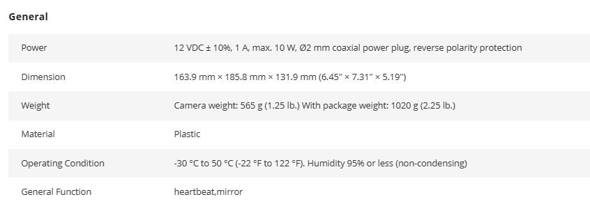

Its not PoE, did you read datasheet before buying it?
Also unplug AC adapter as it works on DC only. You could burn it.

Thanks for your reply , So read that and didnt see the POE, I then asked the reseller and they said it was.
