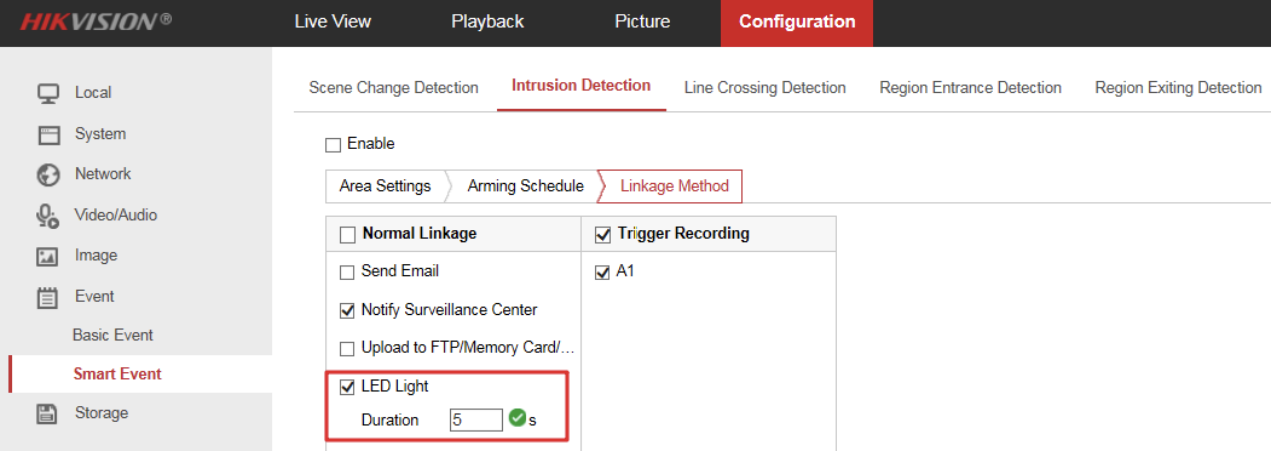

Does the new camera that doesn't trigger have the "white light" option set in the Smart Event linkage method?
Yeah all ticked. It's started working now but I have another issue. Both cameras now are not playing sound?
