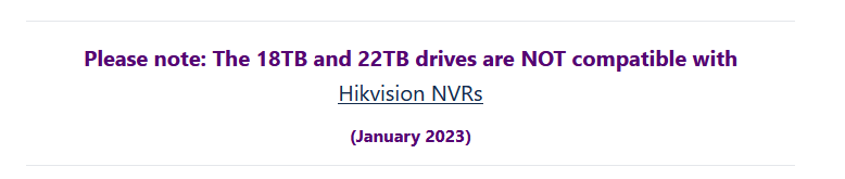

I was about to purchase the 18TB WD Purple (here) as per your guidance, but noticed there is a disclaimer that 18TB does not work with HikVision. Is that still the case?

I know you've already got an answer from our live chat but will also answer here in case the information is helpful to others on the forum.
The answer is yes, the largest size we are confident work is the 14TB HDD but the 8-channel NVR you are looking at has 2 HDD bays so if you need 18-20TB of storage you can use 1 x 8TB & 1 x 10TB or 2 x 10TB.
