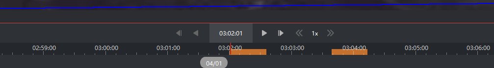

When checking recordings with iVMS-4200 through the SD card, I can see that the SD card recordings is missing some clips that the NVR has captured?
As I can see Both cam and NVR have the same VCA detection lines/ zones?

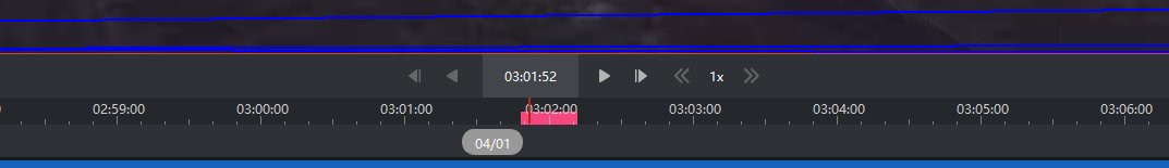

In the images you can see the cam has missed the recording at 3.04??
What is going on here?

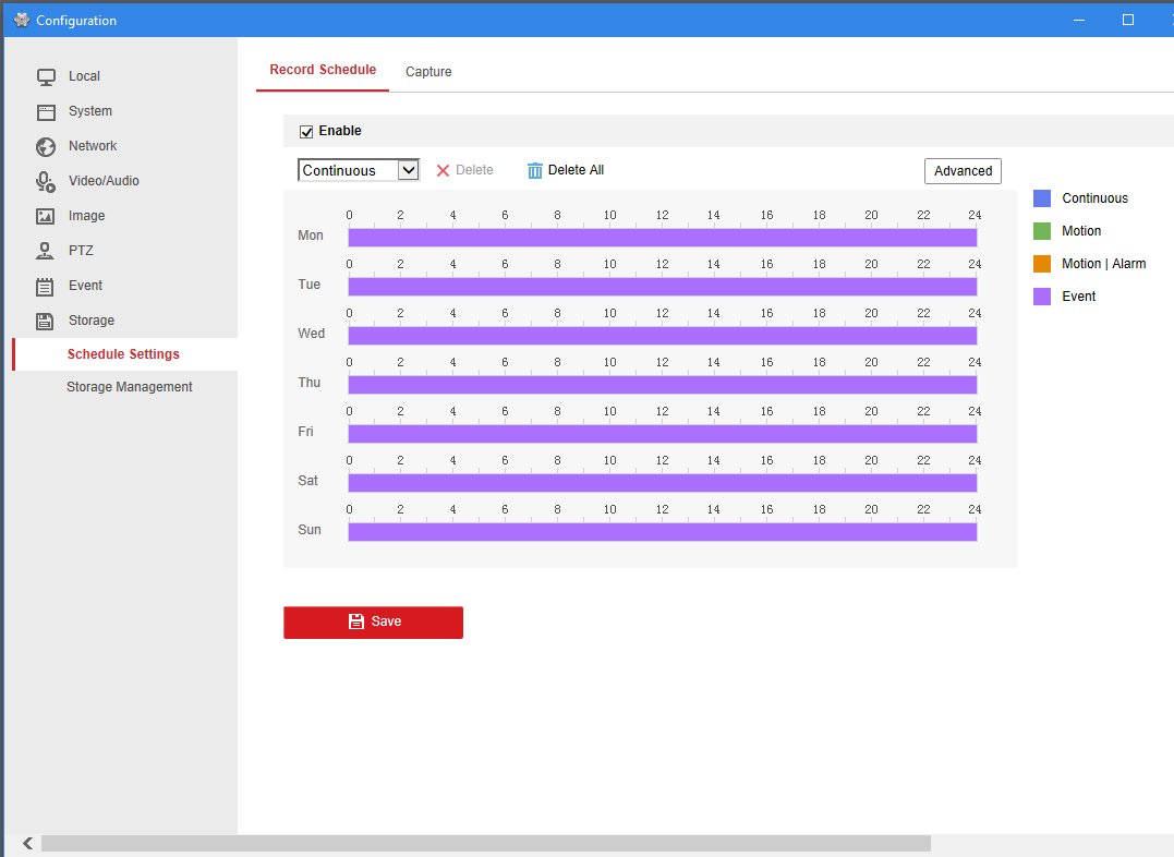

Hi Dan, Is this the recording settings you need?
Im not sure exactly which event settings you need also?

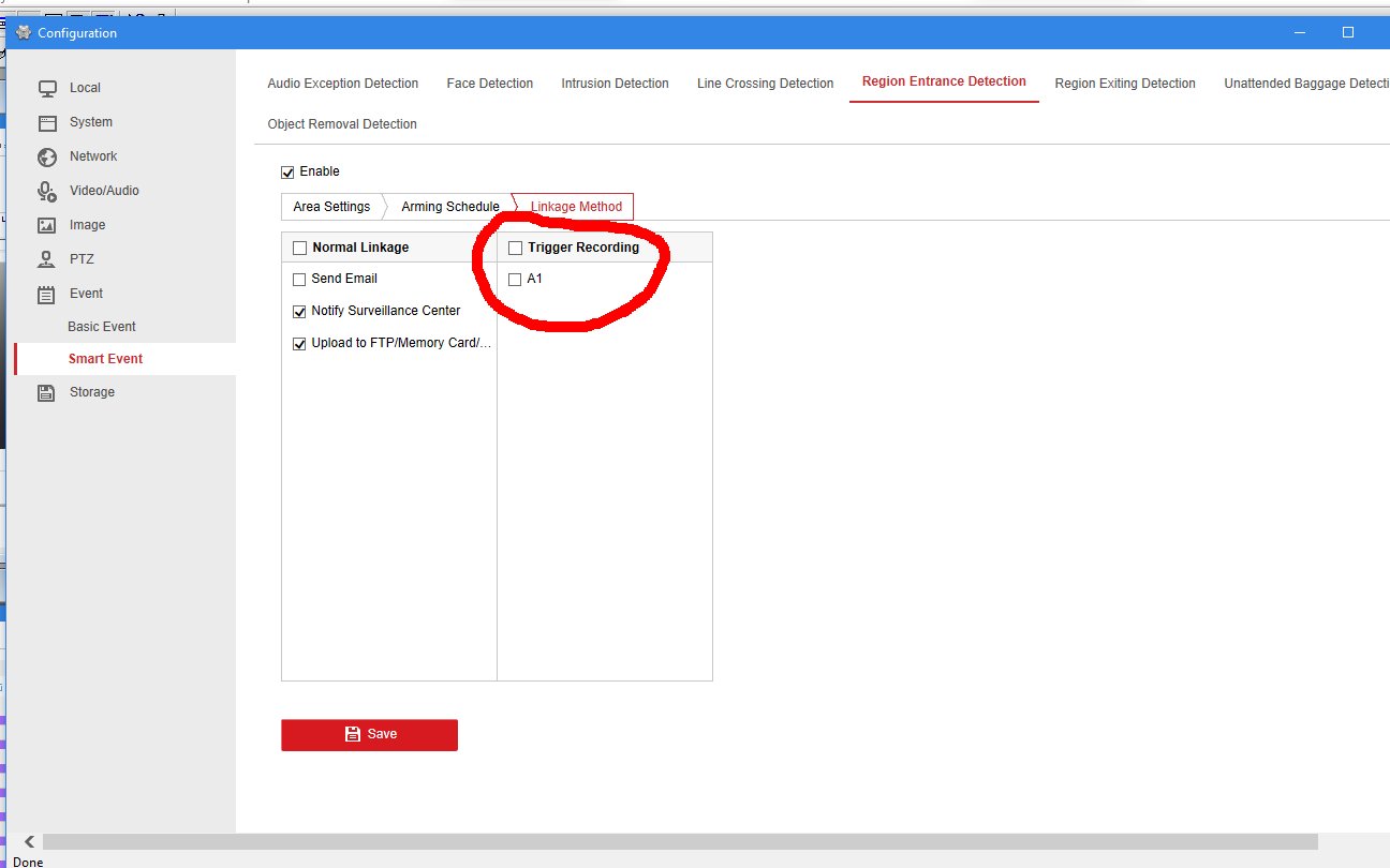

Linkage is ticked on the other detection methods but this one was un ticked? could this be a problem?

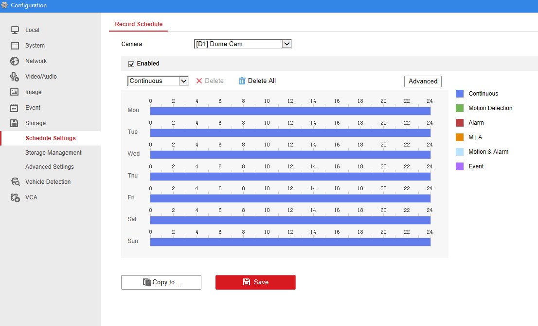

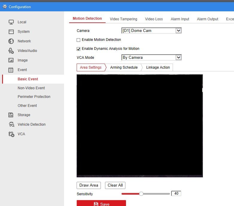

But I didn't configure the NVR's events/detection zones, everything set for the Cams detection zones just automatically appears in the NVR's s settings using the 'VCA Mode' in the NVR's settings.

So the tick missing in the linkage method (as in pic above) for that detection type wouldn't have anything to do with this? Because I think that missed recording in pic above may have been in that zone?
