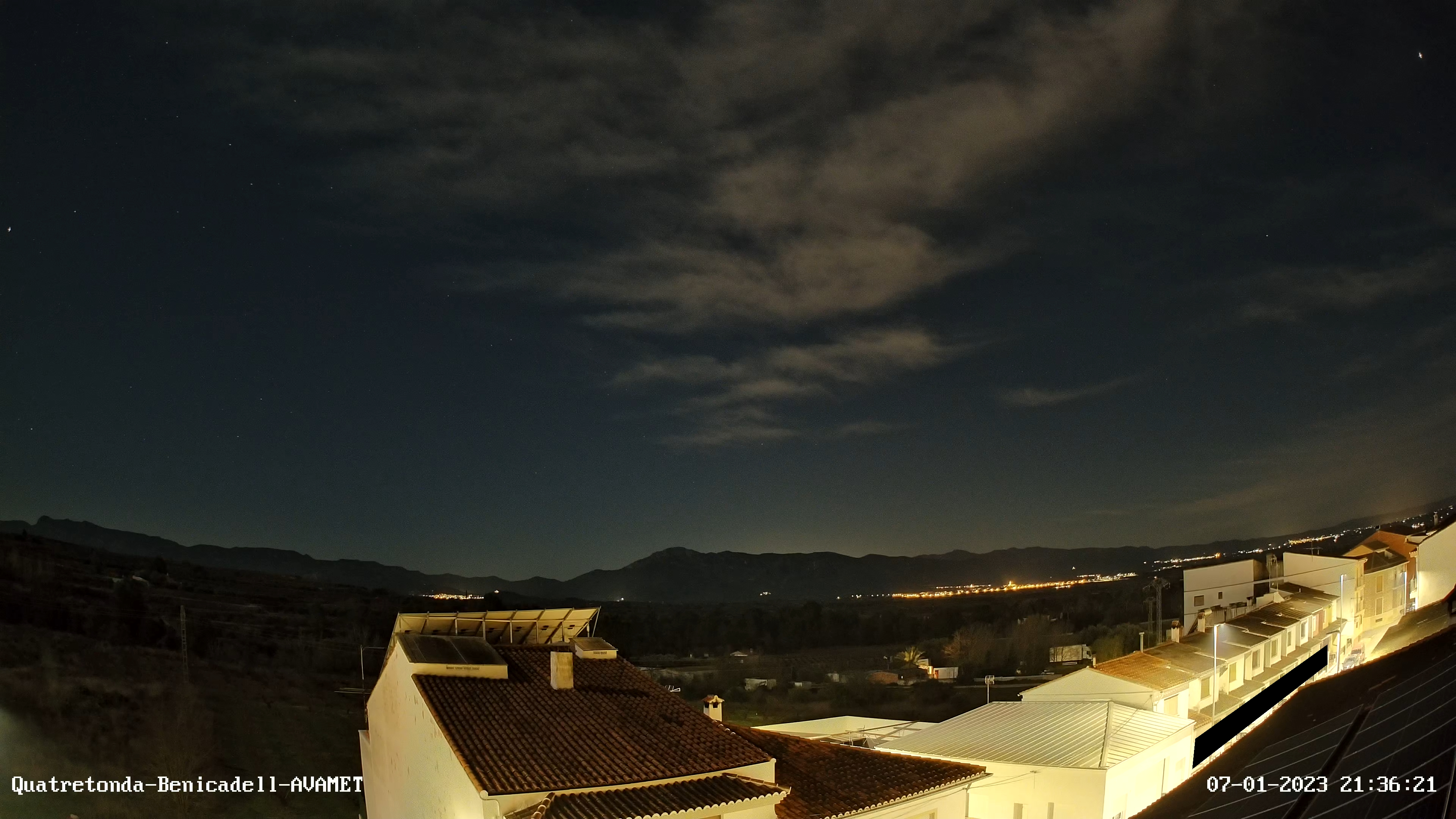

Hello, good evening.
Thank you very much for the announcement of the new firmware!
I just updated a DS-2CD2087G2-L and a DS-2CD2387G2-LSU/SL, and everything works fine. The privacy masking has been a good improvement, now the impact on the image is much reduced as you can adjust all angles.
The cameras are recording on a Synology 218play server, and there have been no problems with the new ONVIF update.
