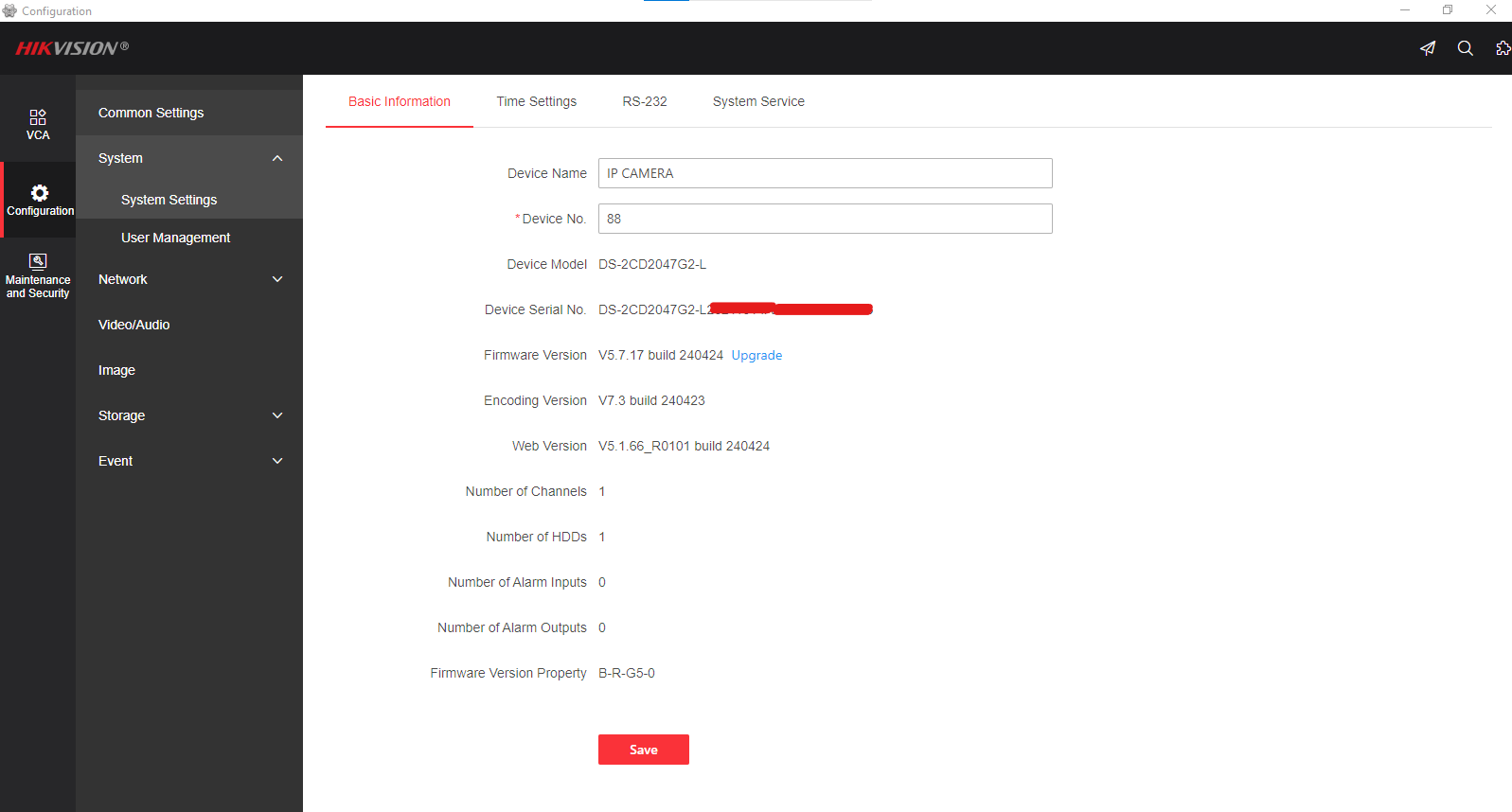

This is inside Temp folder for G5 Platform EU portal as digicap.dav. No zip, no info....
Completely new look
Testing now on 2047G2-L
Also new firmware for NXI-K NVRs 4.82.100_240606

New interface should be familiar for I and M series NVR users
I was confused with VCA settings, but its OK too. Separate adjustment.....

Out of interest, how did you know what version it was before installing? Or do you just like to live dangerously :)
I'll give it a try on one of mine and see if it bricks anything. Any of the official locations (product pages, download search) still show the earlier dated release of 5.7.15 or even 5.7.14 for many models.
I've installed it on a DS-2CD2387G2-LU. It doesn't seem to have broken anything. I won't update any more until a newer version goes on general release. I think I prefer the old interface. While the latest is a bit more modern looking it's harder to navigate and splitting Smart Events into a separate VCA hiding rather than just keeping all 'Events' in one location doesn't make a huge amount of sense to me. But hey ho, that's progress.....
Yes this was the date and size of file:-):)

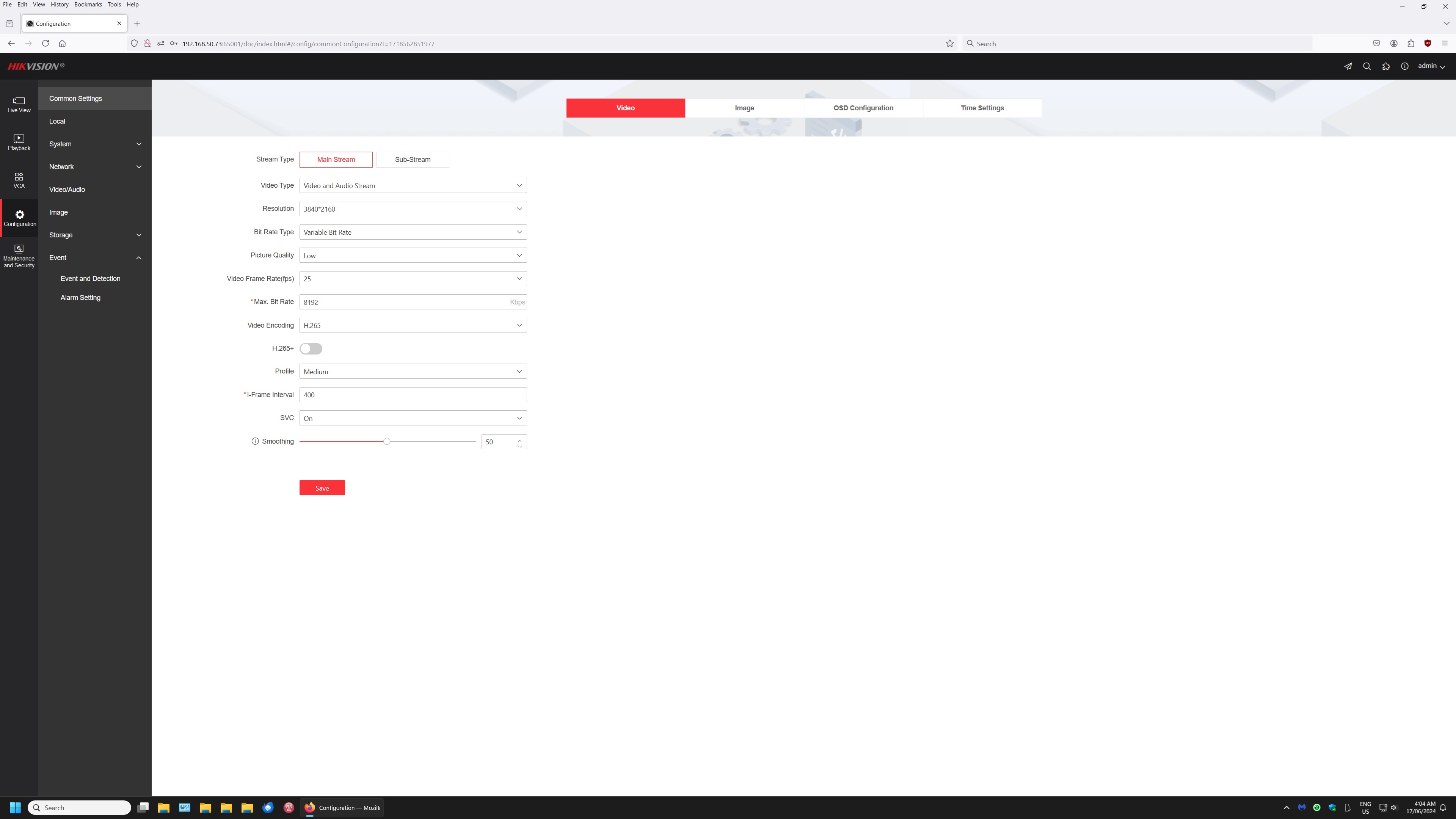

After a factory reset, things seem OK on our camera.
Initially, none of us could consistently get live view from the camera in-browser, we were getting a "the number of the preview requests exceeds the limit" error.
But, hard-resetting and changing the IP seems to have solved (it may have been added to too many of our NVRs) - we also had to switch the main stream codec to H.264 to get it working - weirdly, it now works with all video setting combinations we've tried.
Before the hard-reset, it seemed to work randomly with certain codec / max bitrate / frame rate combinations.
