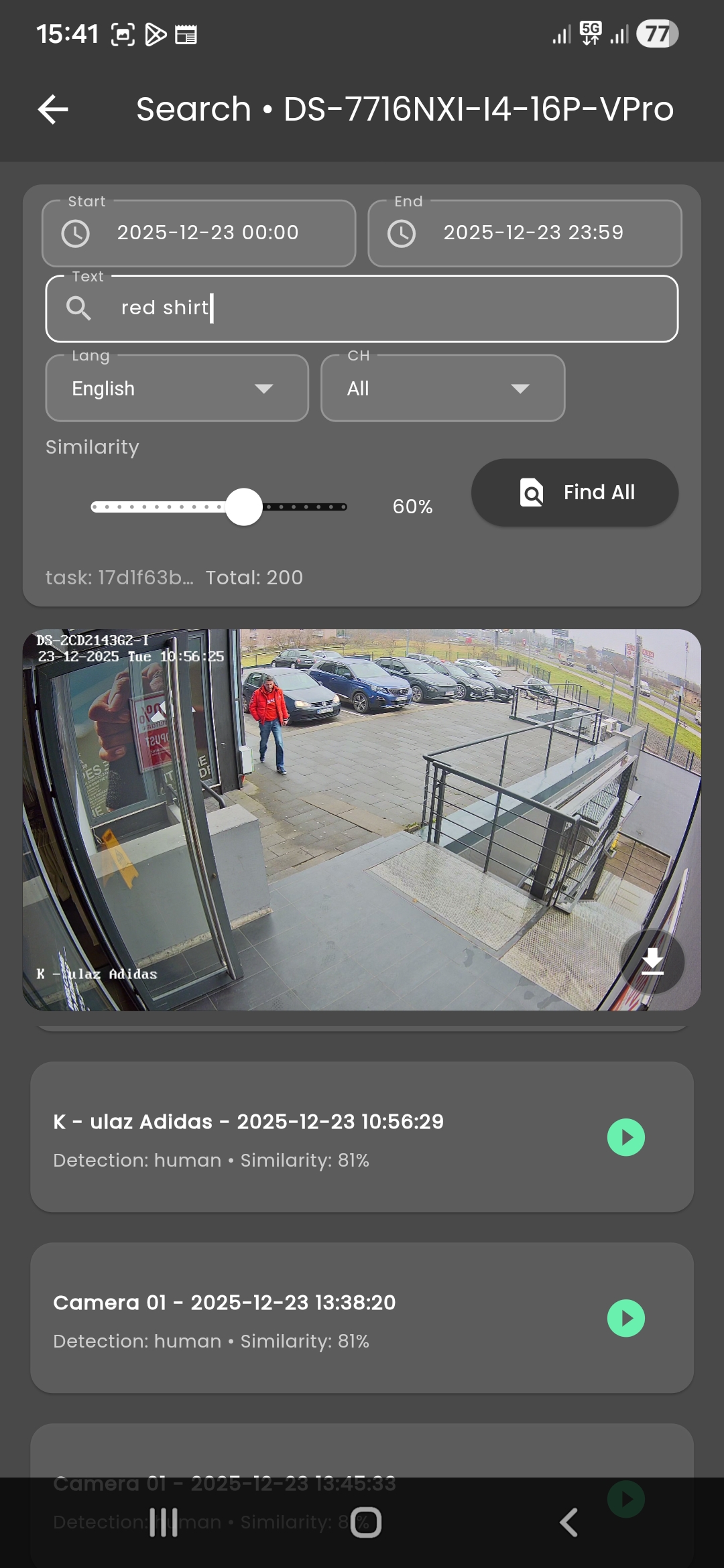

Acuseek is reserved for /VPRO nvrs and aswell ids 96 series /x
ONce you enable you lose alot of vca for non smart cameras.
It works great. Tested on 96 series
There is video from acuseek on nvr, i havent sen 1 yet on web browser and hik connect

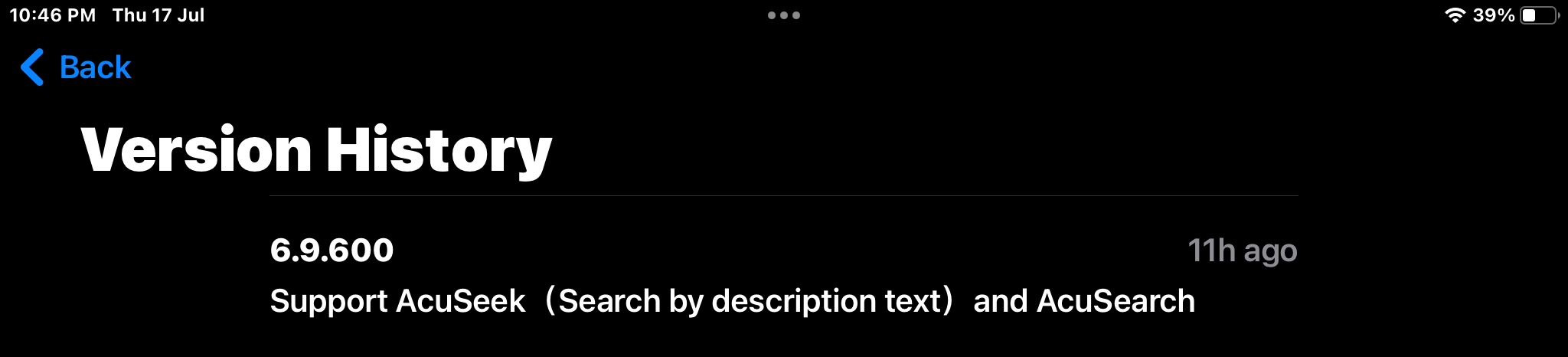

Yeah even without AcuSeek availability, I was hopeful that AcuSearch would work in the new Hik-Connect app for all NVRs/DVRs that support it. I guess that too is also reserved for the higher end NVRs and not the basic NXI models that support AcuSearch. I have a 7604NXI-K1/4P(D) on the bench now with a few AcuSearch compatible cameras. AcuSearch works relatively well in the NVR local UI (first time I've tried it TBH) but there's no change in the new Hik-Connect app.

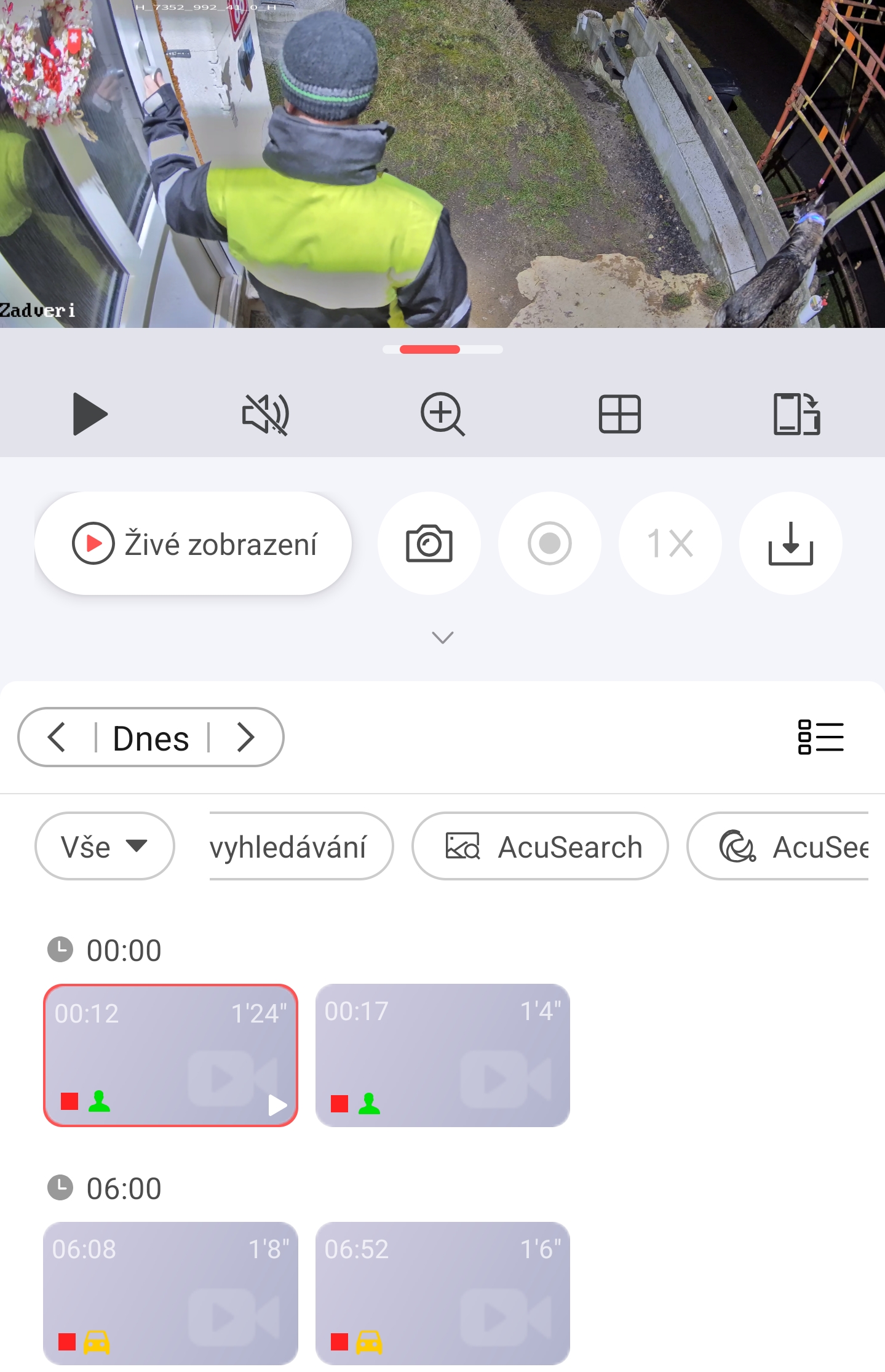

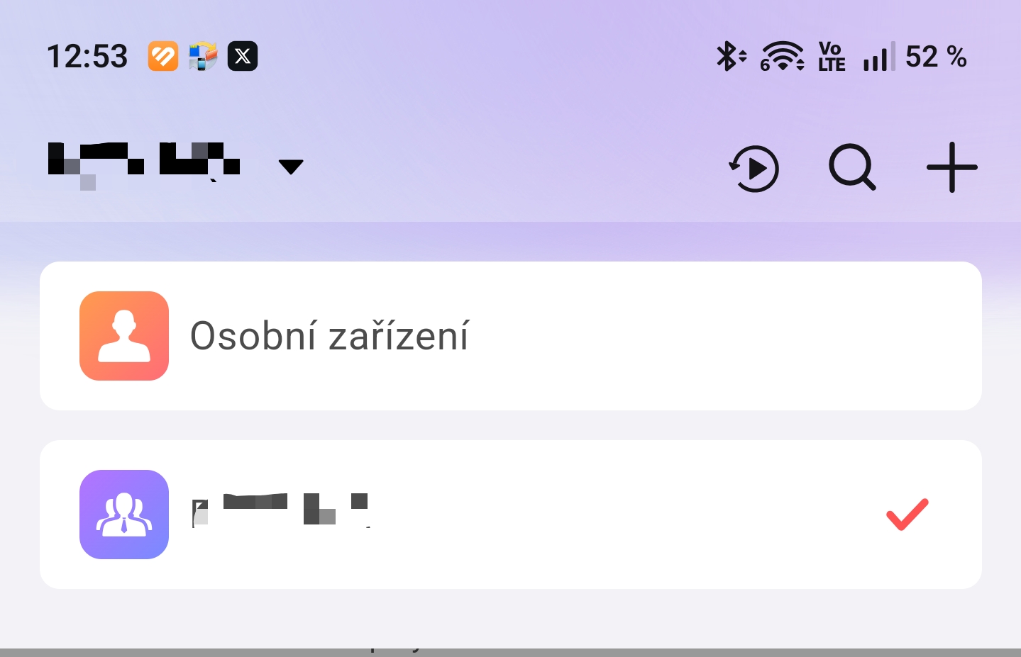

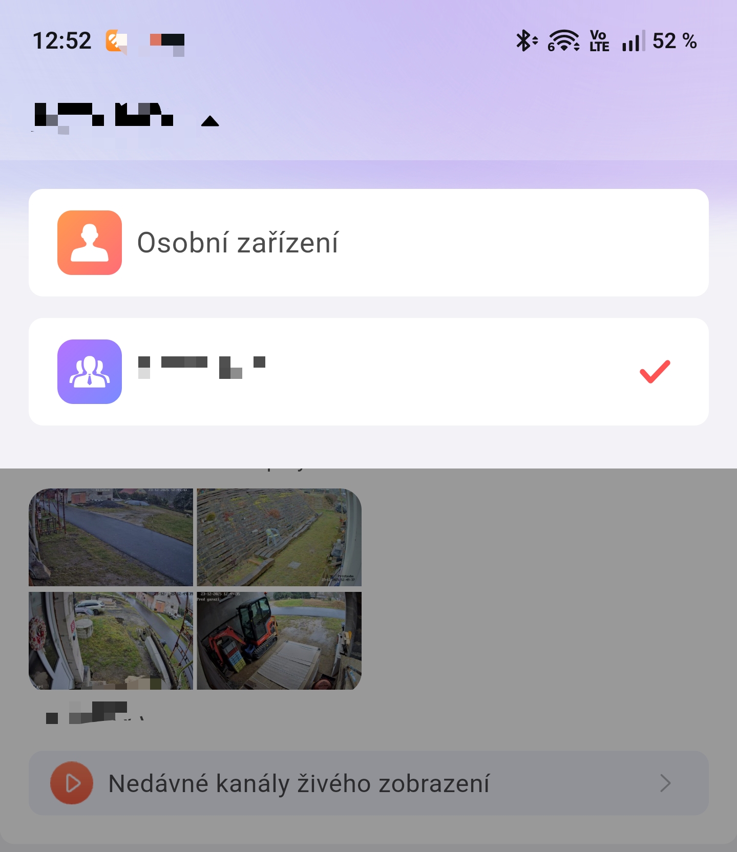

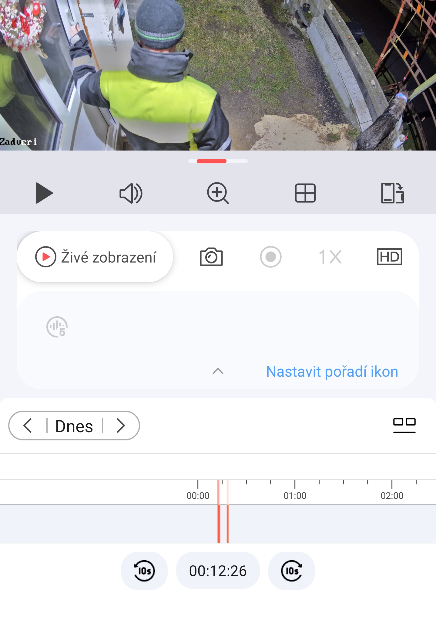

Maybe it will work in Hik Connect, you just need to switch it to team mode - create team in app, then enable hik connect in nvr and then add nvr via qr code a verification code. It"s pretty difficult. Try this manual: How to Create Hik-Connect Team and Use the Cloud Service - SafeTrolley
Tested on DS-7632NXI-I2/VPro.

That original comment of mine was more regarding AcuSearch in the non Vpro models. AcuSeek and AcuSearch both work fine with the VPro models using the standard version of Hik-Connect; Team mode isn't needed.
