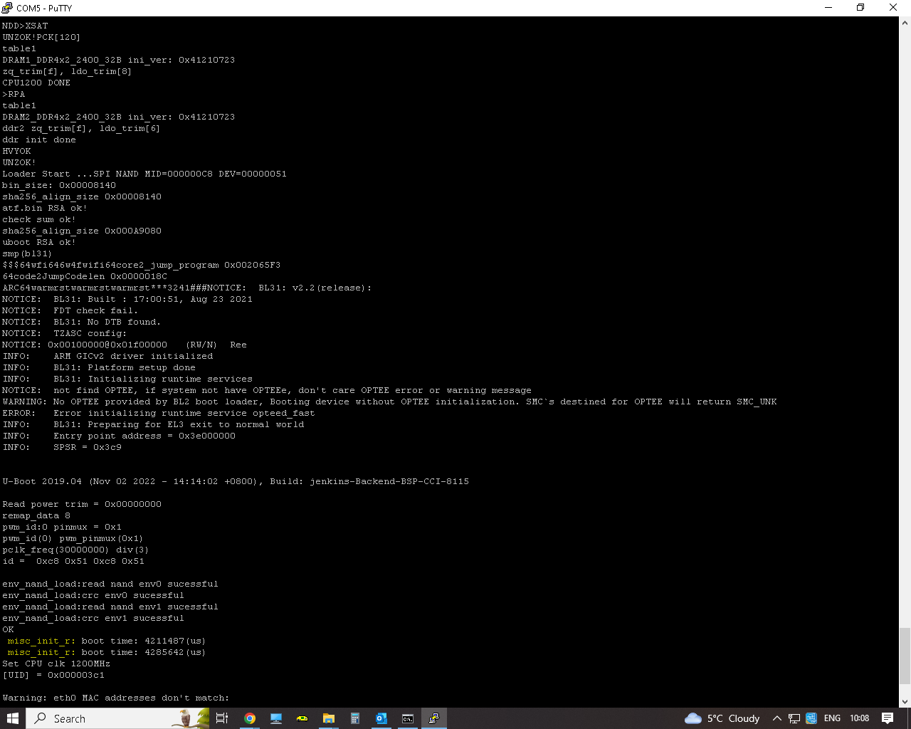

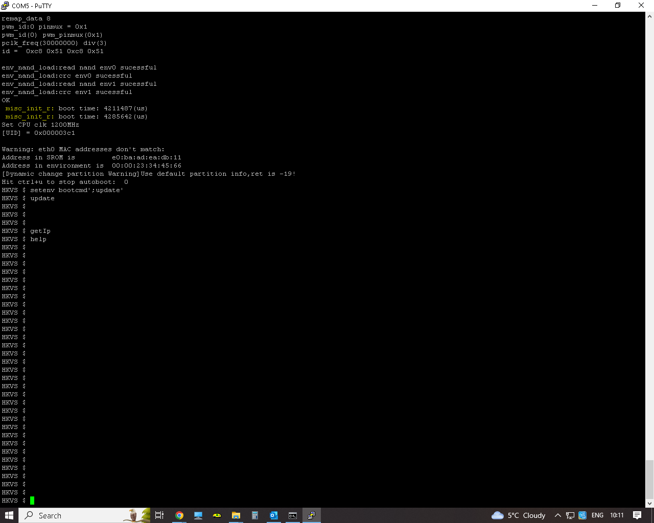

I have a DVR iDS7216HQHI-M1/S and I cannot rewrite firmware with RS232.
DVR in the HKVS$ phase
Server IP 192.0.0.128
With setenv or update or bootcmd commands, no transfer is made from tftp to the DVR.
at any command from putty tftp does not produce initialization.

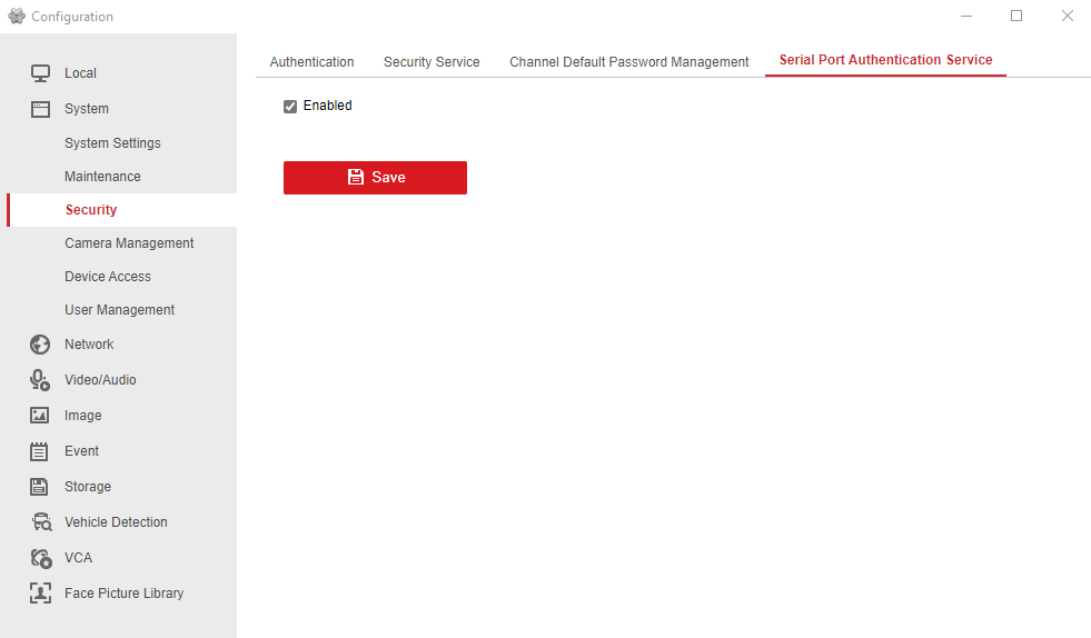

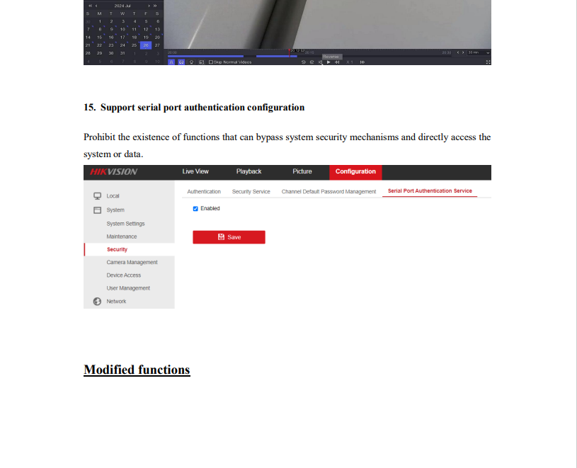

Can you check if this setting exists?
Does this require authentication before the putty CLI connection is established?
In the images posted of the putty CLI session I expected to see the tftp client trying to connect to the DVR server. it would've been good to see the whole process from the DVR the flash update worked on. I think there used to be a hikvision flash firmware tftp update tool.

About the new setting, I'll find the release notes for my NXI and post what exactly they say about...

try different syntax
setenv ';set ipaddr 192.0.0.64'
setenv ';set serverIp 192.0.0.128'
setenv ';update'
Make sure your tftp is x64 and its bound on network interface 192.0.0.128
