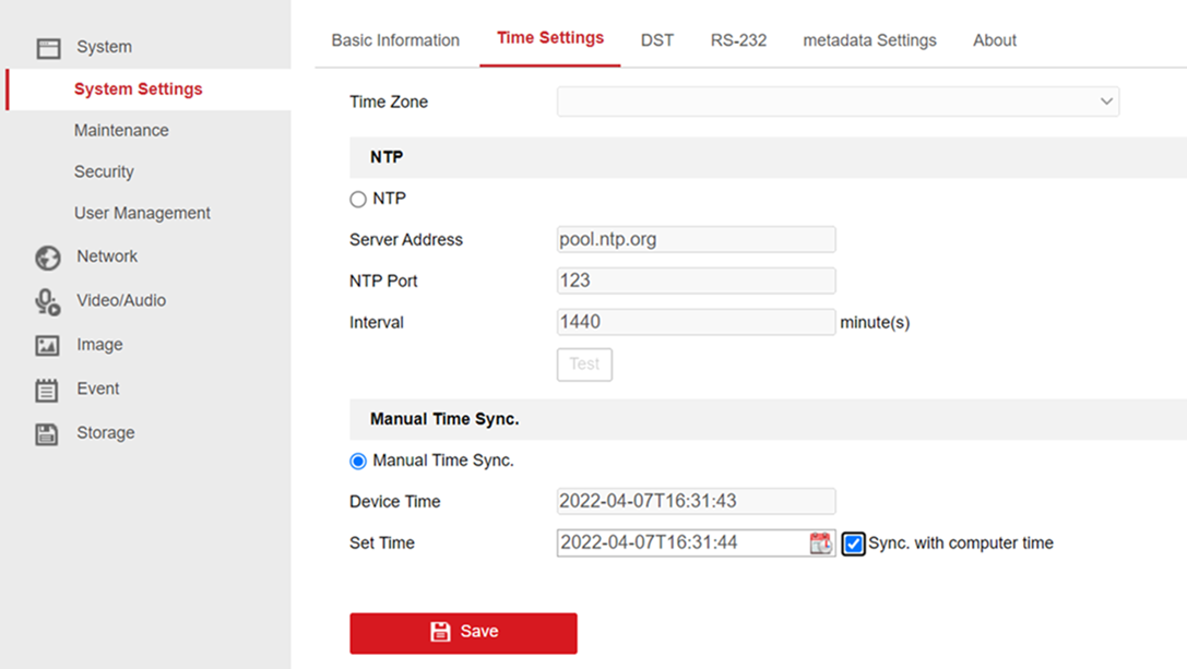

I'm not sure how to take care of the time-settings on the camera's as it seems that they are not able to "test" the connection to the timeserver. And i noticed that the cams are not equal present the time.
this is the setting on cam 1 (all others are equal)
How can i ensure that all cams are getting the right time from the NVR and how often is that being refreshed? Are those settings correct?

In my case the NVR has ip 192.168.2.125 and i can access the cams via 192.168.2.125:65001 etc. But for unknown reasons i can't get the NTP time from the NVR to the CAMS.
As your cameras are directly connected to the NVR, you do not need to set an NTP server on them as they have no internet connection.
This will also be why the "test" button isn't working.
You just need to set your NTP settings on the NVR as you have.

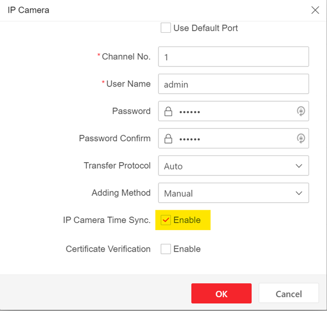

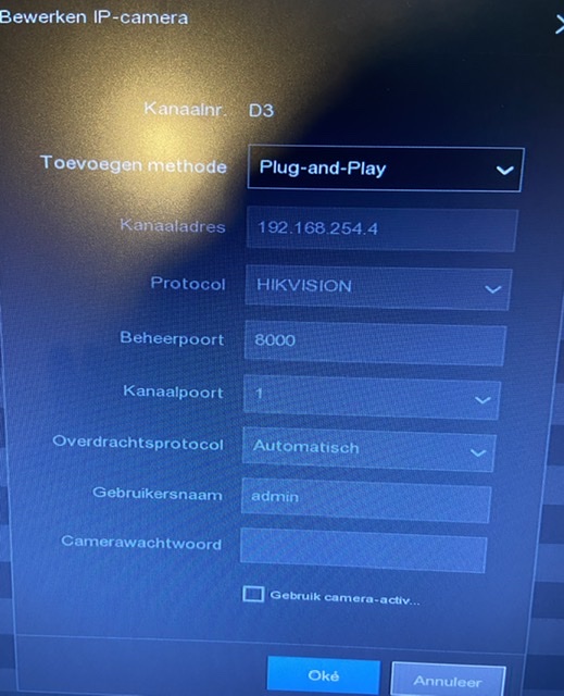

When you add or edit the cameras in the NVRs browser menu (System > Camera Management > Operation / Edit), make sure that you have the "IP camera time sync" enabled:
When I spoke to Hikvision about this before (about a customer whose camera times weren't properly syncing with the NVR), they also advised that it is best to set "manual time sync" on the cameras if they are directly connected to the NVR like below, as trying to set an NTP server may confuse them and cause the times to slip:
@Phil thanks for the clarification. I note that the "IP Camera Time Sync." I think is set to enabled by default.
However, in my case I was trying to find a way to get ANPR cameras FTP functions to work when connected to the NVR. So far it seems impossible. If you use cameras direct to the NVR some of the functions (e.g. FTP) cannot work due to the camera not seeing the network/internet. When @johnfitzy suggested the gateway and static route I thought maybe that was a solution to fix that problem.
It seems strange for HikVision to supply NVRs which can support cameras directly but if you connect cameras directly some of the camera features don't work...

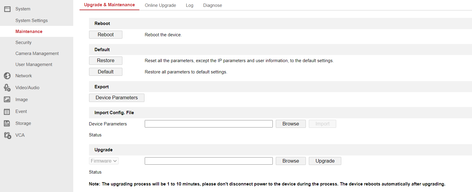

Also, on the NVR GUI (also in the direct NVR interface) there is a "Time Sync Mode" section in system/maintenance/upgrade & maintenance... what do the buttons "Enable IPC/IOT Time Sync" ON/OFF do? It seems to be a new feature in the V4.60 firmware and the release notes state:
Support one-key time sync configuration
1. Time sync for all connected devices can be one-key enabled/disable
2. Both local GUI and WEB support this function.
Is this a setting that is saved, or does it just do a onetime sync?

You don't need to delete the camera to set the time sync option. @Kyle states you can edit it and I confirmed this on my system (NVR interface and web GUI)... reread his post. Also, as @codlord mentioned, it is on by default when you add a new camera so you will probably find it is already set!
@johnfitzy i do understand that deleting is not necessary, but maybe my version of the nvr software differs from yours. I'm version 4.30.085, i couldn't find the sync option when i edit the cam settings on the nvr, see below in cam settings or on the NVR GUI there is no "Time Sync Mode" section in system/maintenance/upgrade & maintenance .
My apologies @mtv - you're correct, I've just checked and the 7604NI-K1-4P(B) firmware does not offer the time sync option on the camera management page locally or in a browser.
This is only available for the larger K- and I- Series NVRs.
However, I imagine that if the cameras are inactive when you plug them into a 7604NI-K1-4P(B) then the times will automatically synchronise.

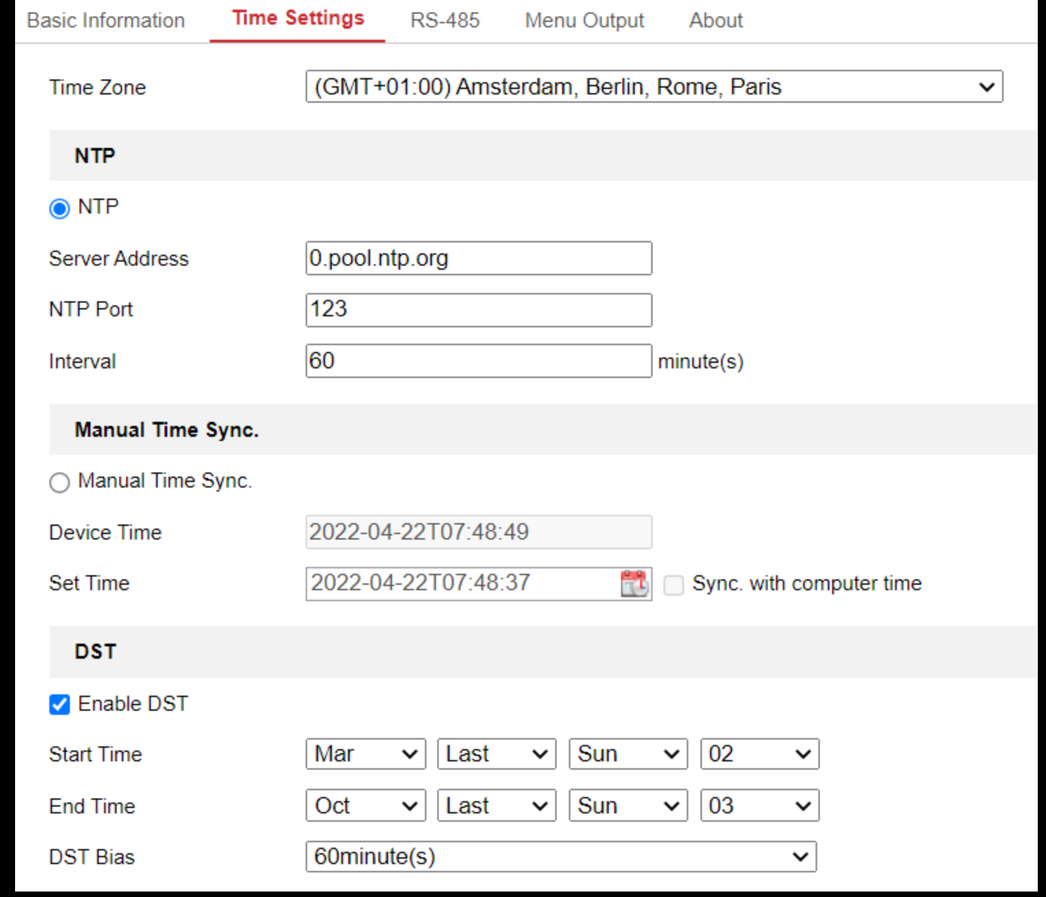

Hi @Kyle, thanks for confirming, so i don't have to look further into settings. I tried to the synchronize, i had NTP active, but choose to try out the platform time synchronize, to see what the effect would be on time synchronization. So this could also be something that could help, I'll report back on my experience.

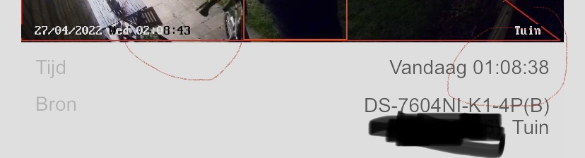

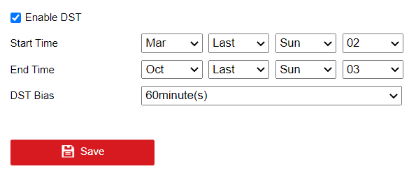

The time so far stays in line, but…… the notifications mention -1 hr, for example in notification there is a screenshot of the event which also reflects the cam time, 02.09.45 and notification mentions 01.09.45. I’ll guess that comes from the setting on the nvr to sync with platform.

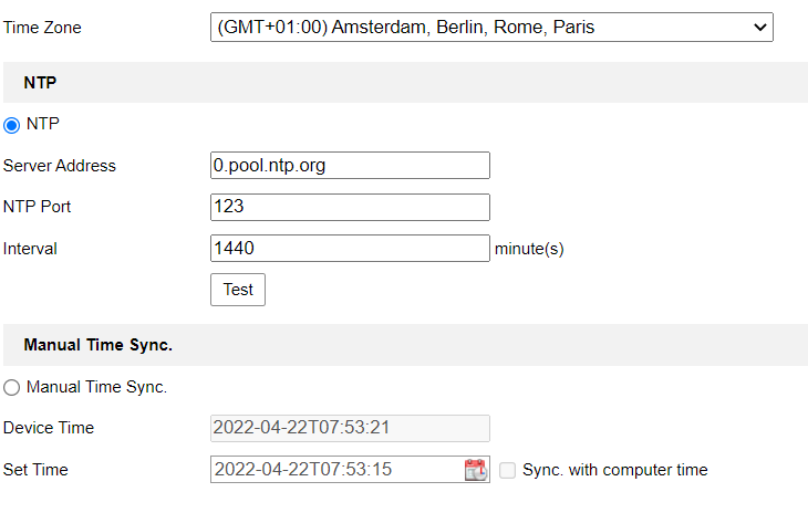

@Kyle
have set it back to ntp time on nvr, as the 1hr difference couldn’t Be solved. To my understanding setting ntp in network on the nvr with 60 min interval check seems not to work. Last night due to set back a half hour time difference pops up, despite ntp that didn’t correct it. I had to change the time this morning manually on the nvr and had to reboot to be reflected on the cams ( which is correct if course), but whatever i put i ntp setting in interval, it doesn’t refresh time.
