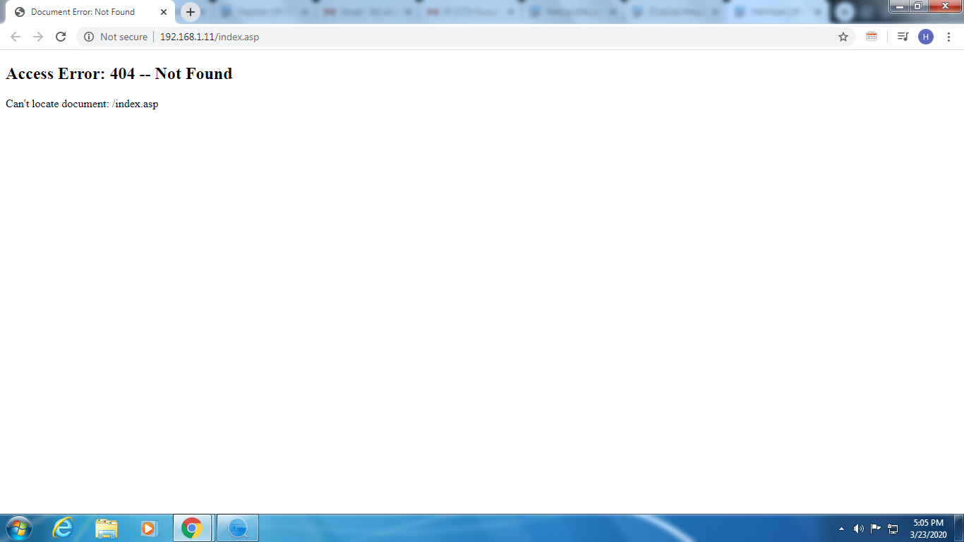

Problems logging into my camera with a browser (Access Error: 404 -- Not Found)
Tonypls
Every time i try to login it still says that the index.asp or what not can't be found
i'm just trying to change the wifi password in its save because its diffrent now and this kkeeps happening!!!!1584957922163.png

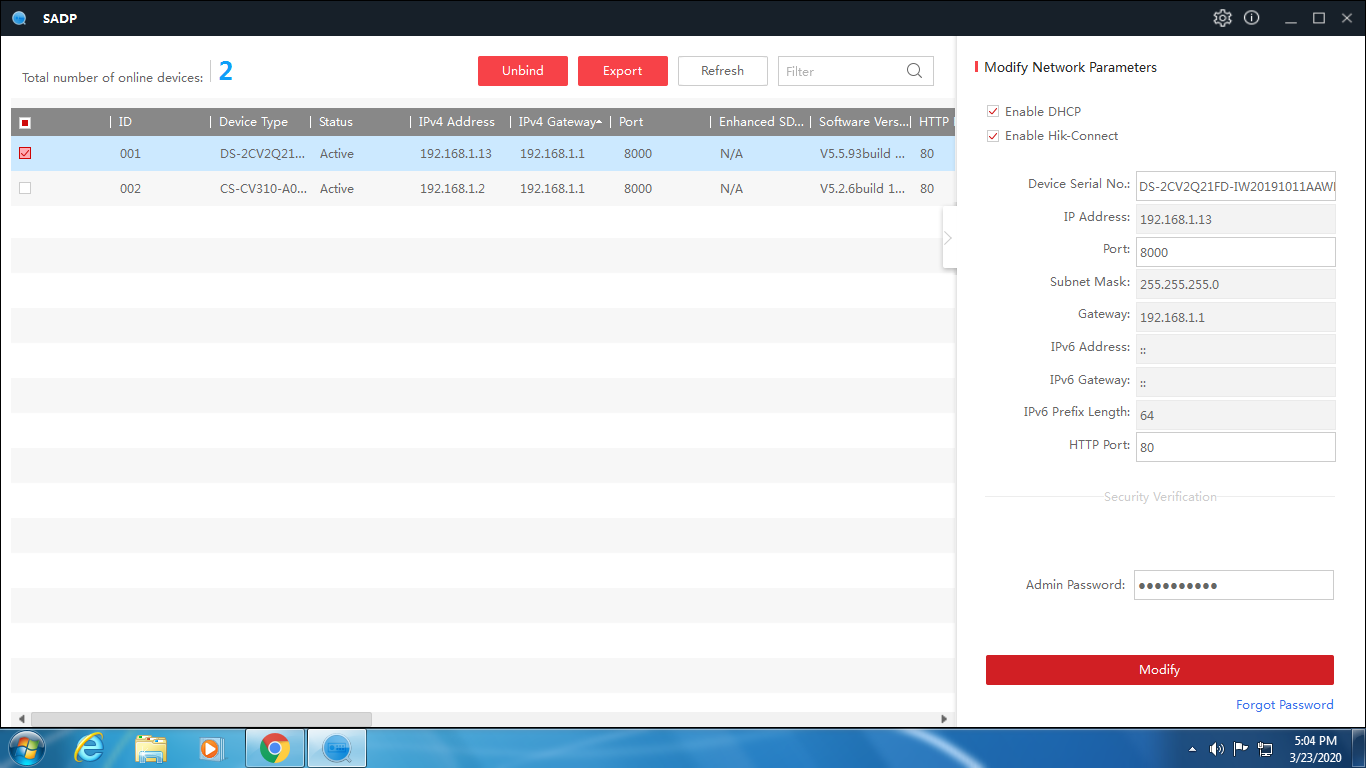

The IP address in the browser's address bar in your second image is not one shown in SADP in your first image?
I did do a hard reset and it did not work, also the IP is different because of the "modify" in SADP and i also used the original one before that via refresh but the error 404 still happens, please help
Please Post here a refreshed view of what the SADP table now shows.

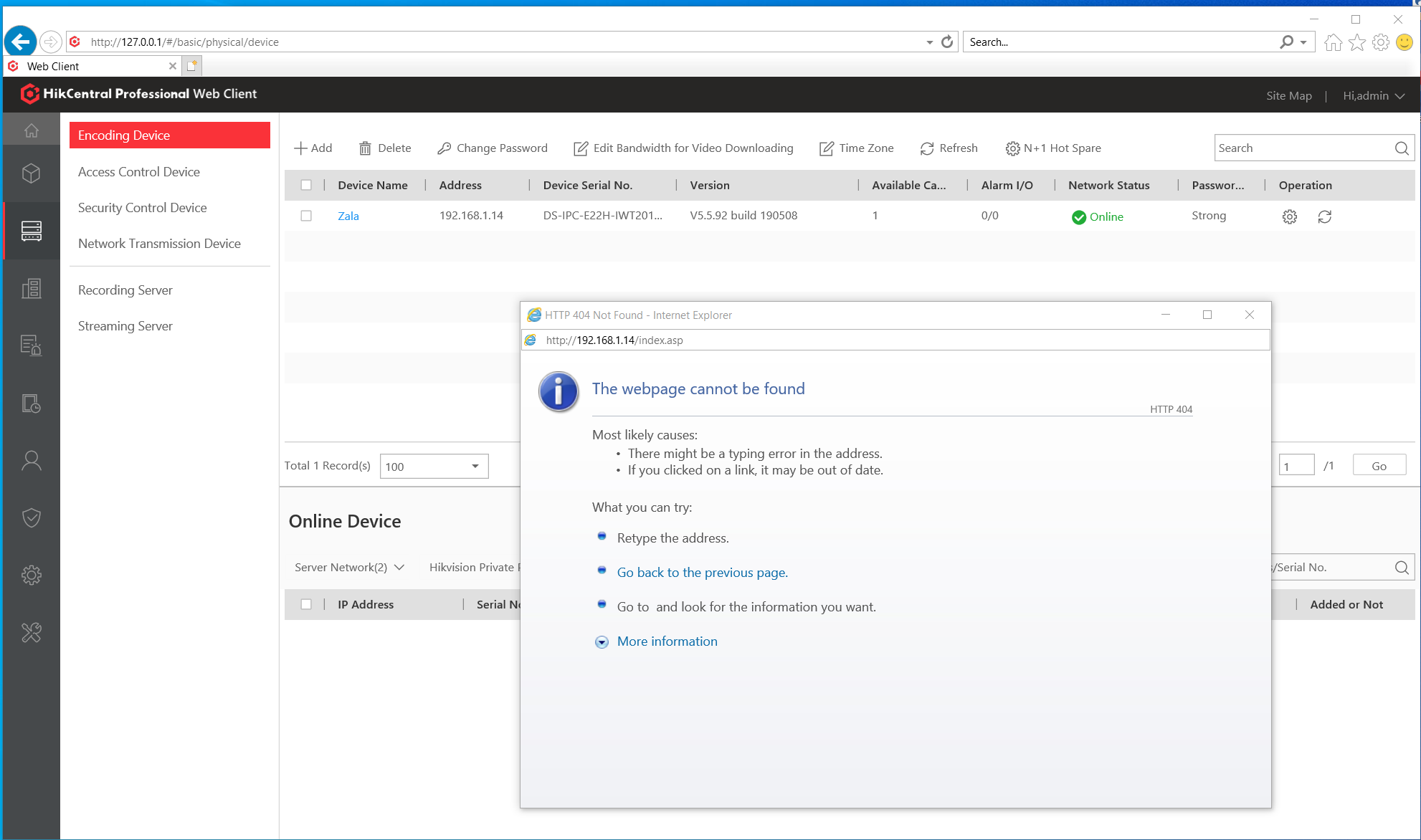

I have same Problem on DS-IPC-E22H-IWT firmware V5.5.92 build 190508
I can connect to camera from Hik-Connect App from phone. But can't change wifi settings (camera works with wire) and It only usable from local network.
