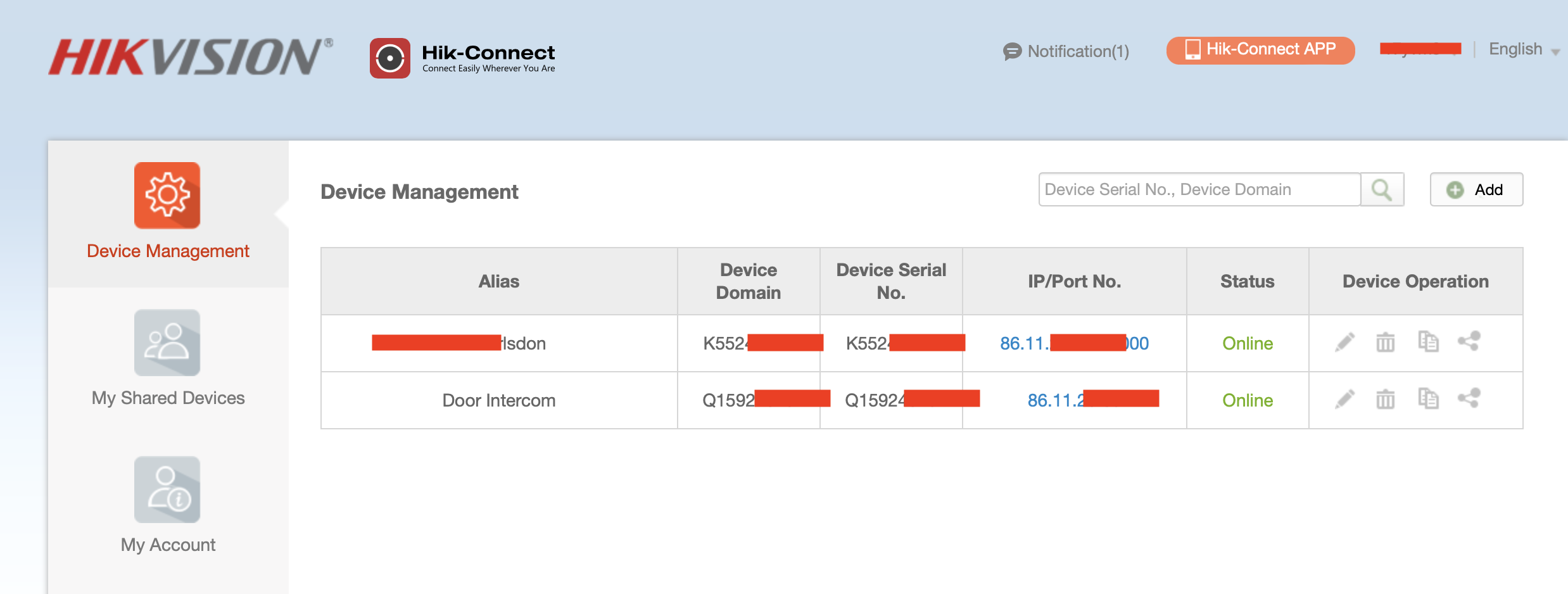

If they unbind on their system (the DVR/NVR), it will just unbind that specific device as you've mentioned (their new system). They need to login to their Hik-Connect account in a web browser at www.hik-connect.com. There they will see a list of devices that are associated with that account and can simply click the 'delete' icon. If when they go to that page online they are only seeing their new system, it may be that the previous system (now yours) was added to a different Hik-Connect account with a previous e mail address or phone number perhaps. See below:
