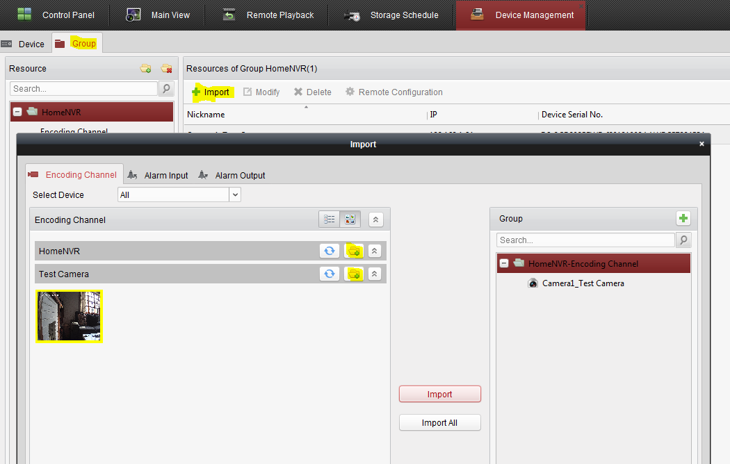

Try the following. I've barely used Hikvision's Storage Server, but this works for me.

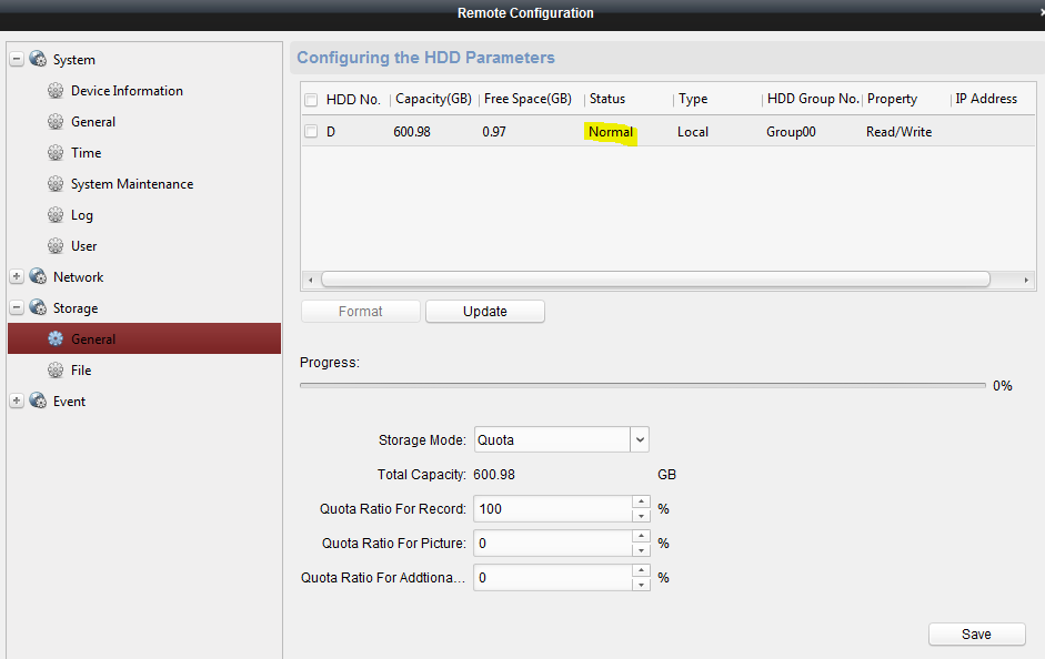

Assuming the storage status is reporting Normal on the Storage Server and the WatchDog and Storage Server applications are running in Task Manager.

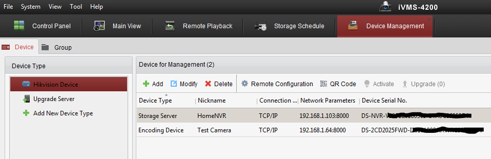

On the iVMS-4200 client PC open Device Management.
Make sure you have imported both the Storage Server AND all the cameras connected to it.

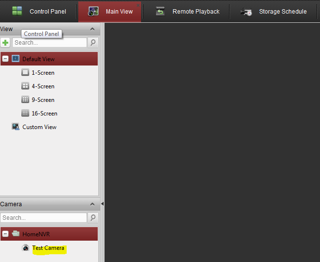

Create a Group, click Import. Click the folder with the green plus to import the Storage Server (HomeNVR in my case). Then add the cameras to the group. You can rename them after they have been added.
You should now have the Group visible in the Main View tab.

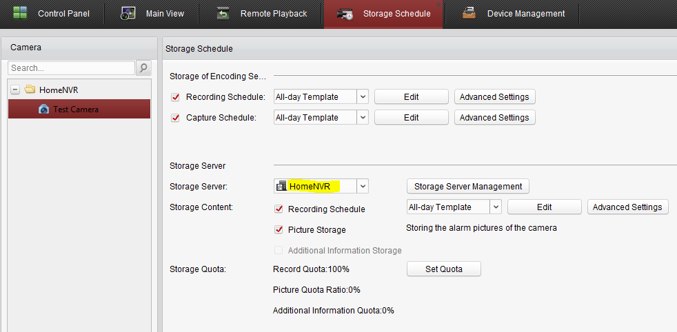

Go to Storage Schedule and make sure every camera is pointing to the Storage Server. The settings here must be identical for all iVMS-4200 clients. Any changes you make here will cascade to other clients including the Storage Server host. Hit save at the top right.

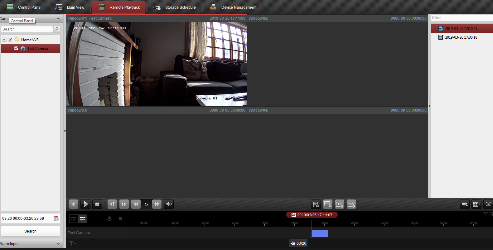

Wait a few minutes and you should now see the recordings in Remote Playback.

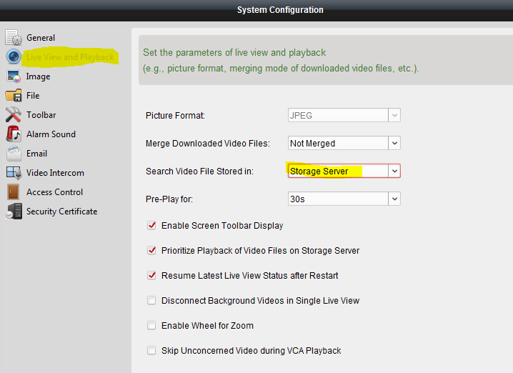

Also check on the iVMS-4200 client software under Tool>System Configuration>Live View and Playback that the Search Video File Stored in drop-down is set to Storage Server. Hopefully this helps.
