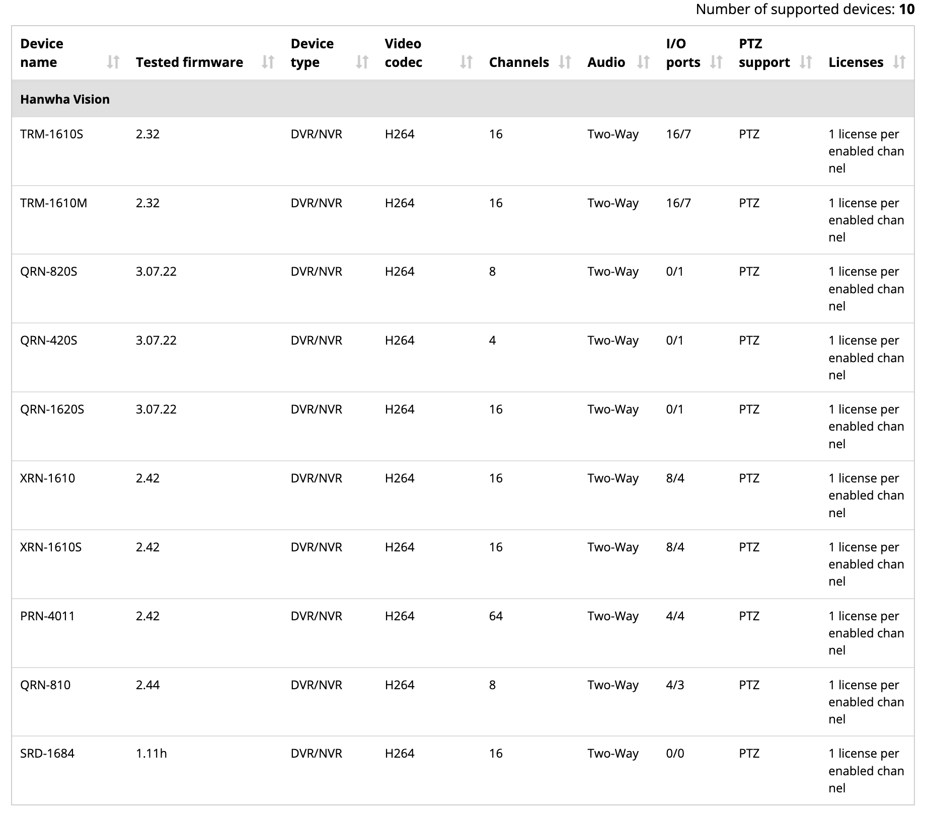

Hi @adamz76
On the Milestone website, the Supported Devices page says that the below 10 x Hanwha Vision NVRs are supported by their software:
If your NVR model(s) are not shown here we would recommend speaking to Milestone directly to confirm if your models are supported or not because sometimes this supported device information is not completely up to date.
