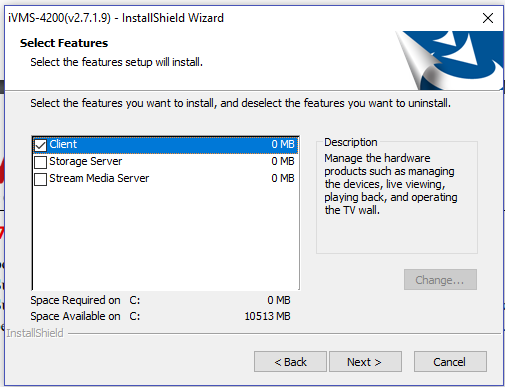

Storage server is a separate application which you have to choose to install when installing iVMS-4220:
Make sure you are running the latest version.
Currently, V2.7.1.9 is the latest available at the European portal:
(assuming you are Windows-based)
DOWNLOAD PORTAL
