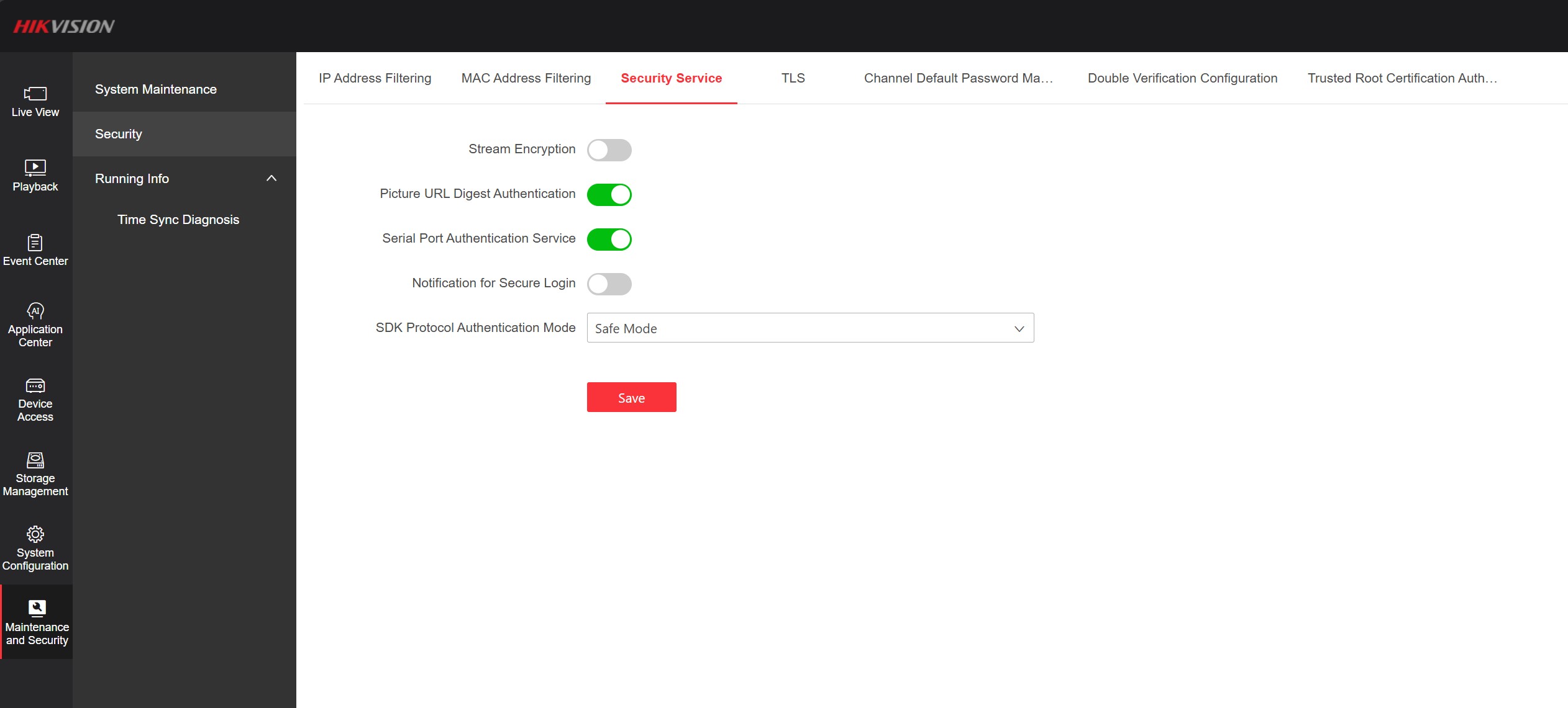

Hi there!
Does anyone know if the option to turn off the stream encryption has moved in the lastest firmware ?
I cant find it anywhere
Device Model
DS-2CD2347G3-LIS2UY/SL
Firmware Version
V5.8.13 build 250725
Encoding Version
V7.3 build 250623
Web Version
V5.2.91_R0101 build 250724
Regards

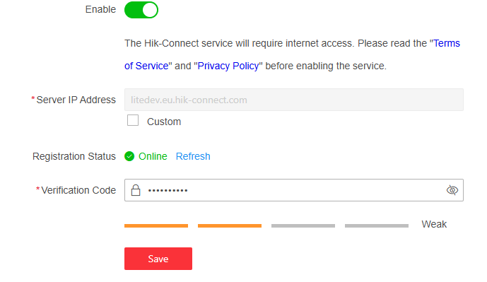

Just turn it off in Hik-Connect app. Click the 3 dot menu next to the site, then Settings. Image and Video encryption switch is there.
I’m not sure why it’s been removed from the devices menu; perhaps it’s for additional security/privacy. It ensures encryption is on by default at the time of connection to the Hik-Connect platform and has to be explicitly disabled using the platform (which presumably is logged)
