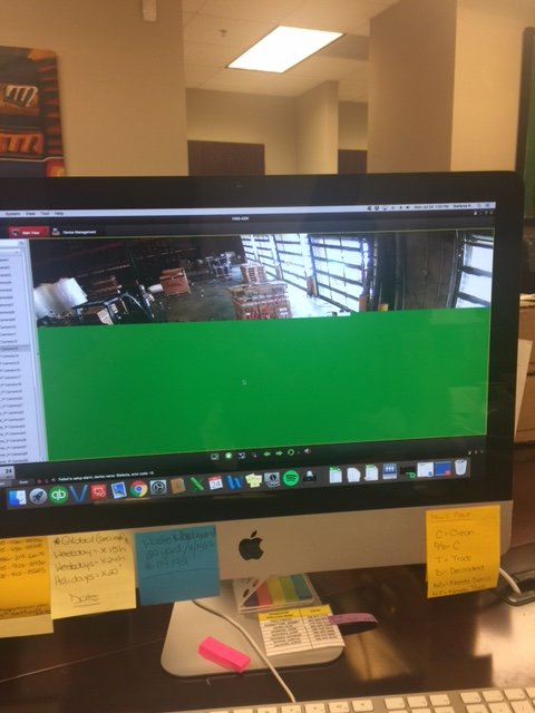

Im having issues watching a DS-9664NI-I8 Hikvision NVR using IVMS-4200 on Mac computers (green flashing screens)..Hikvision highest level tech support says the issue is with the video card of the Mac computers.
Should i be able to use Safari to watch NVR on the local network without this issues?
Same issue happen to me with the 32 channels turbo DVR....

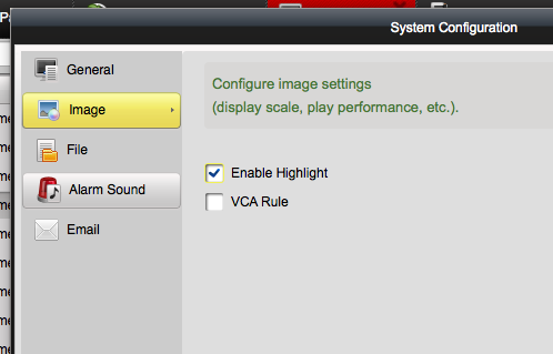

Hey Miguel, we had the same issue with a customer of us, support told us exactly the same thing -_-
We did two things, updating the iOS to the lastest version (here it is Sierra 10.12.6) and in the iVMS Client disable the highlight option (screenshot)
