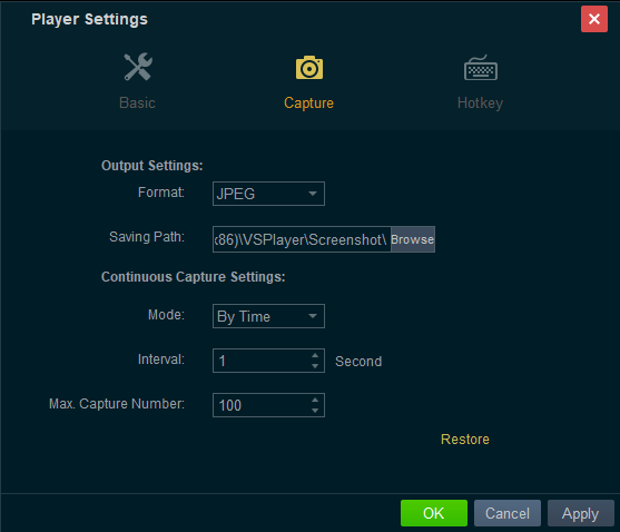

This should work:
Main Menu (in the top-left hand corner) > Settings > Capture > Saving Path/Browse

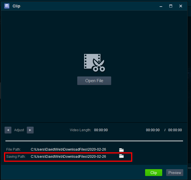

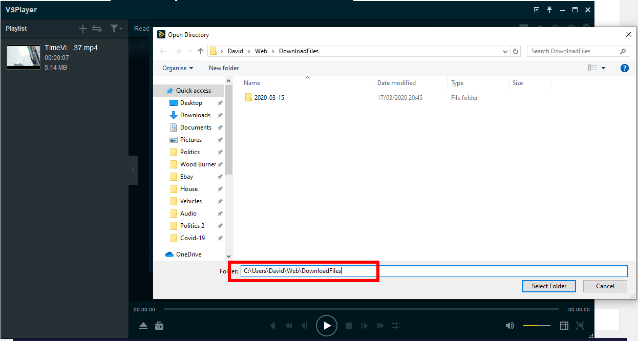

I did eventually find this setting however after setting the path to where I wanted it:
, it doesn't use this path when I want to clip:
I even tried running as administrator but the saving path is just stuck as this random location!!

The 2020-02-26 is a folder I have not created. When I installed VSPlayer, it took it upon itself to use this a default location and if I delete it and then start VSPlayer or use the clip tool, this folder gets created.
The latest version is v7.4.1 and this is the version I am using.
Hi @Cos
All Hikvision footage is time & date stamped, this is pretty standard for most professional CCTV solutions. They are designed for surveillance purposes so the software is fixed to create new date-stamped folders every time you download footage so you can easily keep track files from specific events, this cannot be changed. You should be able to choose any file directory but Hikvision's software will always create a new date-stamped folder within the last folder of that file path.
