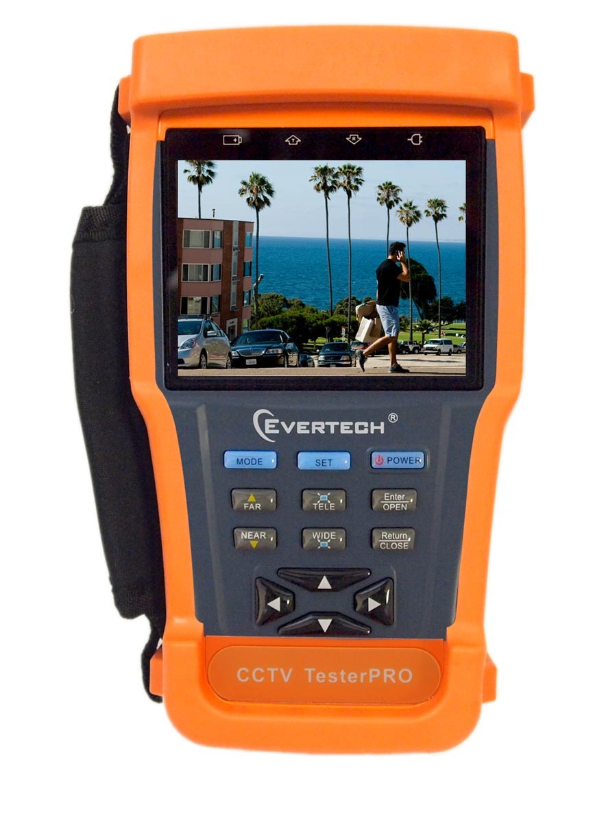

Everything you said is 100% correct but try hooking a AHD camera directly to a bnc or rca input of a normal tv and it won't work, I have a analogue Cctv tester and put a analogue camera on it and it'll work fine, put AHD camera to it and nothing shows up

Oh dear. Thanks for the very full answers 27901591. That's me well fed up, then. I don't know what to do now. I shall probably have to stick with the old system. What a shame.
