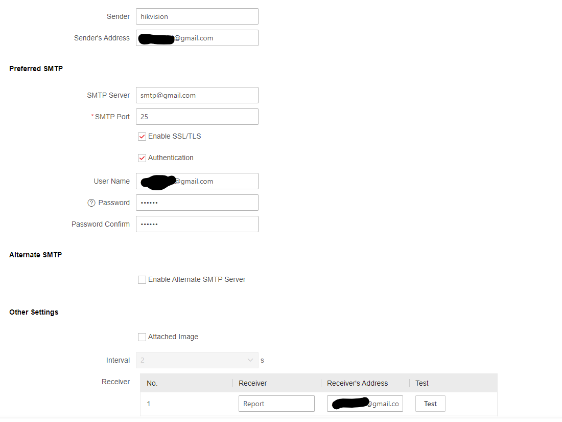

Hello,
Do you have any alternative to any of the methods for sending notifications? I have tried gmail and yahoo and still get the testing failed. I have set up app password and still fail. I have verified email works for sending and receiving emails from browser. I believe NVR is correctly connected to network as I can access cameras through browser and Hik-Connect. I have tried all three port settings. I set up the 2-step verification in gmail, still no success. I recently purchased this NVR which is model number DS-7616NI-I2/16P. The firmware version is V4.60.005 build 220108.

Hello,
Hi
Change SMTP port to 465 and then you should find it works.
Martin
Thanks for the response. I tried changing the port and nothing worked. I just signed up for the free Outlook email and it worked. Outlook is a much better email than Gmail IMO.
Sender: Hikvision
Senders Address : valami@gmail.com
SMTP szerver: smtp.gmail.com
SMTP-port : 465
Enable : SSL/TLS
Authentication: Enable
Felhasználónév : valami@gmail.com
Password: You will be shown the unique 16-letter password that Google has created for your device.
Password Confirm: 16-letter password
The e-mail notification works with this setting.
