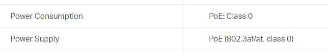

Are you using an IEEE 802.3af/at compliant POE source?
Hi @tomycrosound
TP-Link who manufactures the camera says it is PoE only so I would take that to be the correct information, some sellers just copy & paste technical information to multiple product pages and don't check if it is actually correct.
We've never seen a "splitter" device like the one you've linked above, your link has very little information about the product but from some Googling, we have found this description of the product:
"The RFE-POESET is a passive PoE set from RF elements. By including both a PoE Injector and splitter, the set is used to power a device using PoE that itself is not PoE compatible, reducing the number of cables."
These devices take data & power, compress it into a passive PoE signal to send across one cable, and then split the signal again at the camera so that you can connect a non-PoE camera to the single network cable.
The issue is that this splitter device produces a non-standard passive PoE signal (instead of standard IEEE 802.3af/at PoE) and so if you just use the PoE injector part of this splitter device it won't power the camera because the TP-Link camera will not recognise the passive PoE signal it creates.
You need to use a PoE Injector that creates a standard IEEE 802.3af/at PoE signal.
