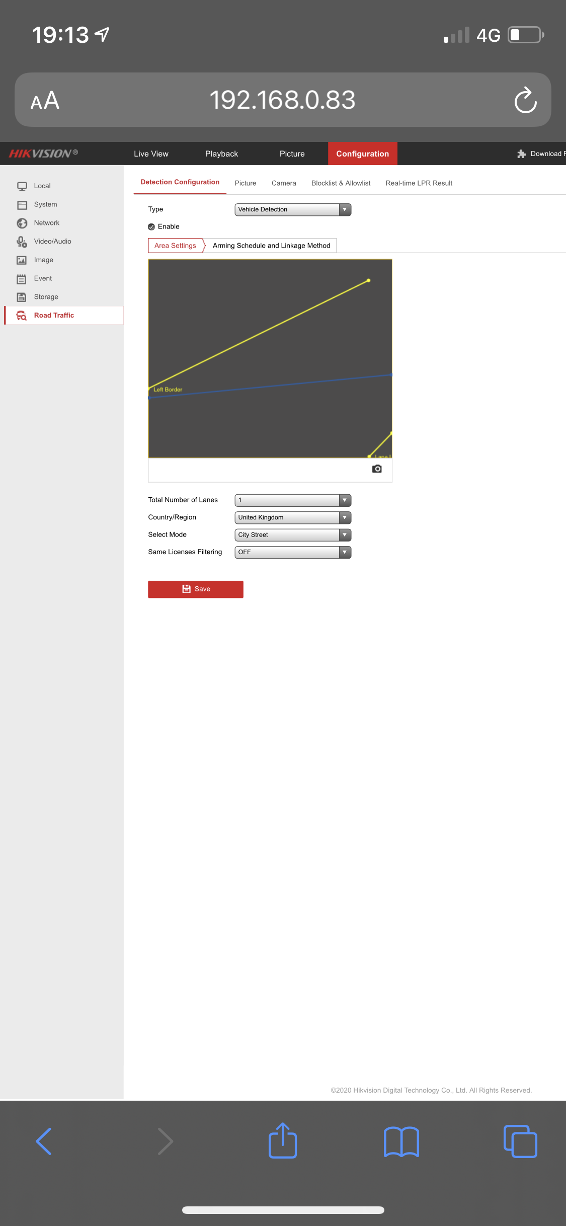

I can’t say I much experience with the K4 as my ANPR is running on a I2. Have you tried logging on camera directly an clicked on to the Road Traffic tab then click on Detection Configuration make sure you have ticked enable an set up the area with the detection lines.

Thanks for the quick reply
have no traffic tab on the menu , is really weird.
smart events are present
