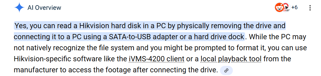

Can these disks be read on a Windows PC directly, or do they require special software or a Linux environment?
Of course, do not let the PC format the drive if you are prompted!
This link explains how "disks can be read on a Windows PC directly"... I have not done it...
