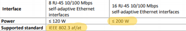

You should be fine. Your NVR ports support PoE+ and has a 200W power budget.
Standard cameras will use an absolute max of 10W, and those PTZs a max of 18W, so should be well under the budget all in.
The below is from the NVRs datasheet, IEEE 802.3 af/at is just the techy term for PoE+.
